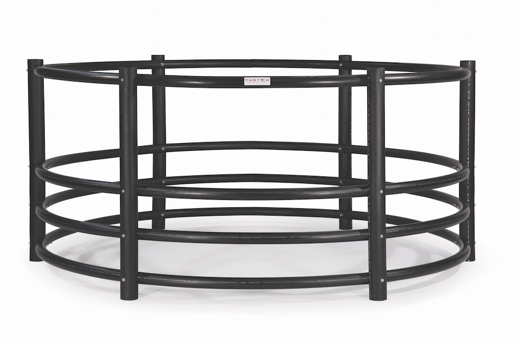

Don't use the poly cattle style for horses, they will rub off a lot of their mane on the top rail.
Cattle style:

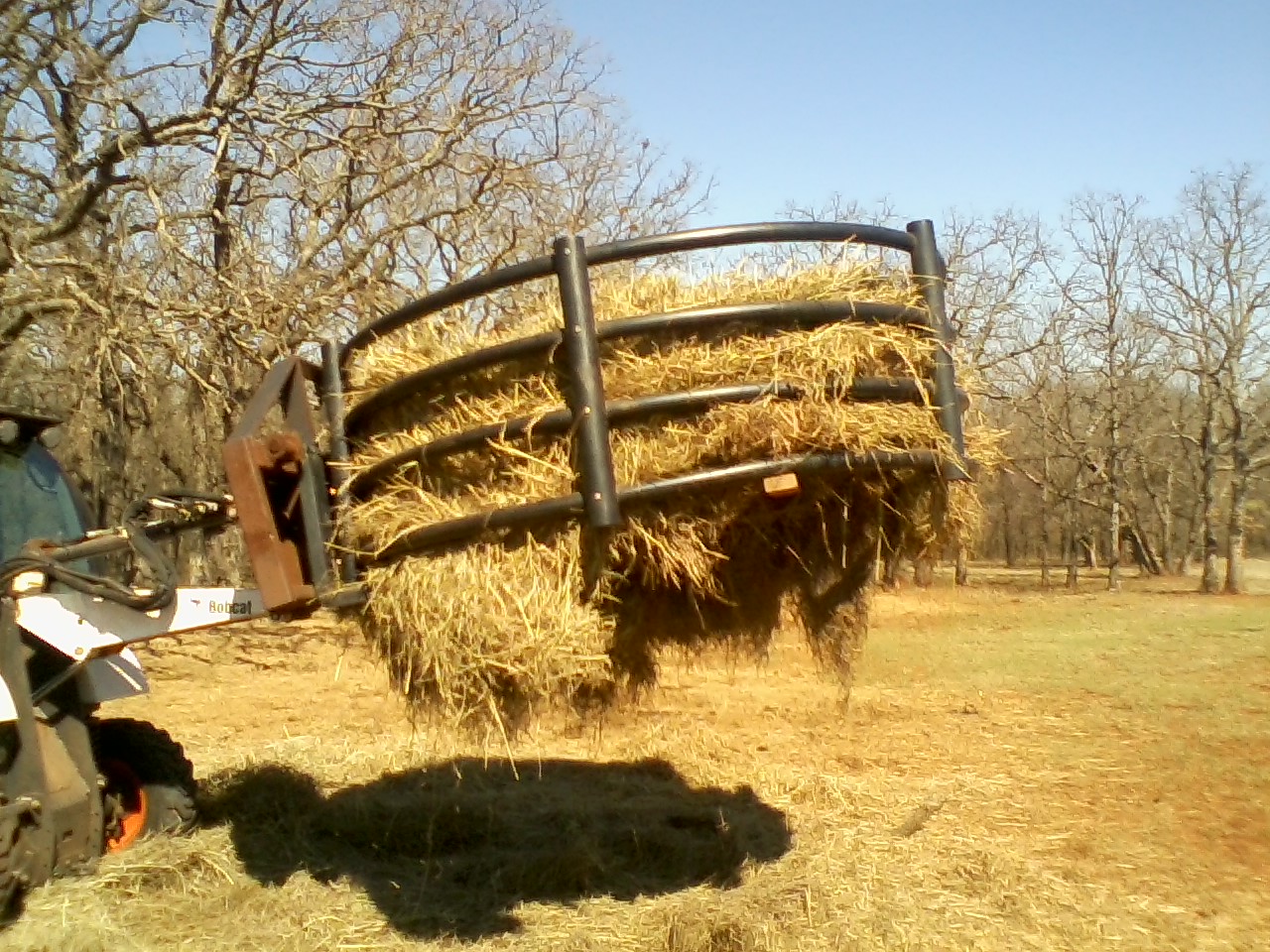

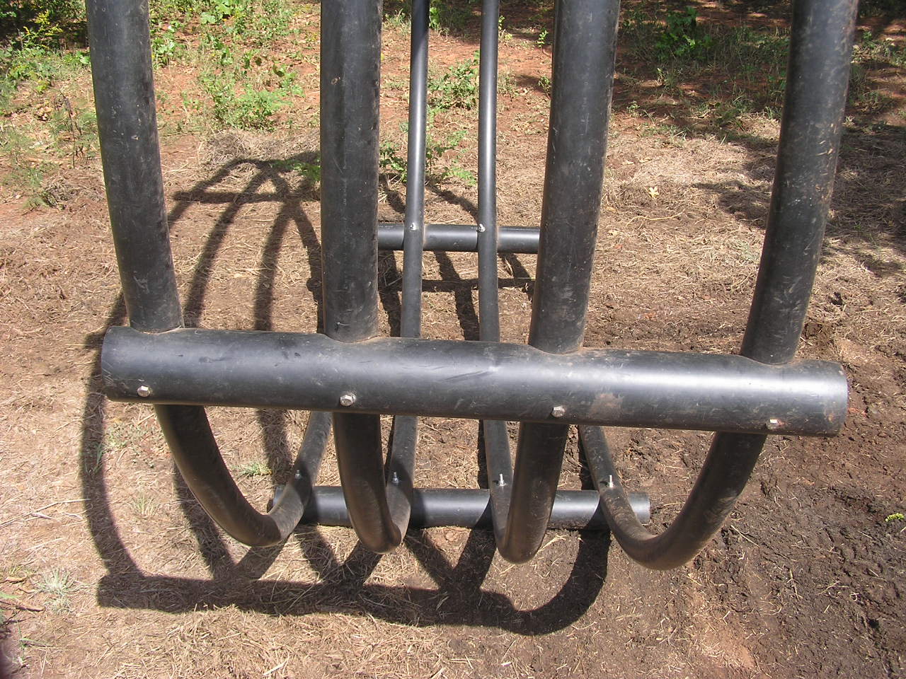

This is the poly horse bale ring that we have used for over 7 years:
A better view of the 8 foot diameter horse style poly bale ring:

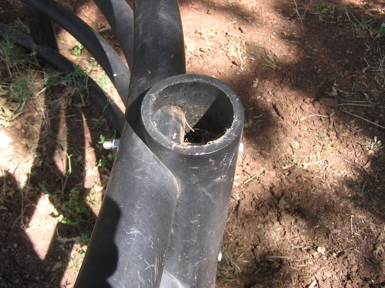

Took some measurements, the legs are 3-1/2 outside diameter, 3/8 wall thickness and 33 inches long. They are notched for the rings to fit into:

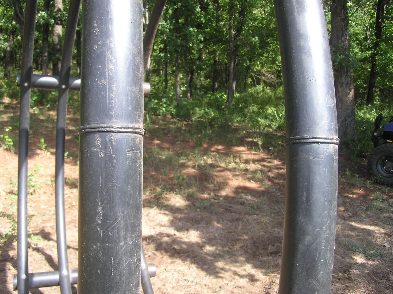

The 8' diameter Polyethylene pipe rings are heat fused together:

The one I saw had larger (5"?) uprights and 2" (or so) rings that went through holes in the uprights.
