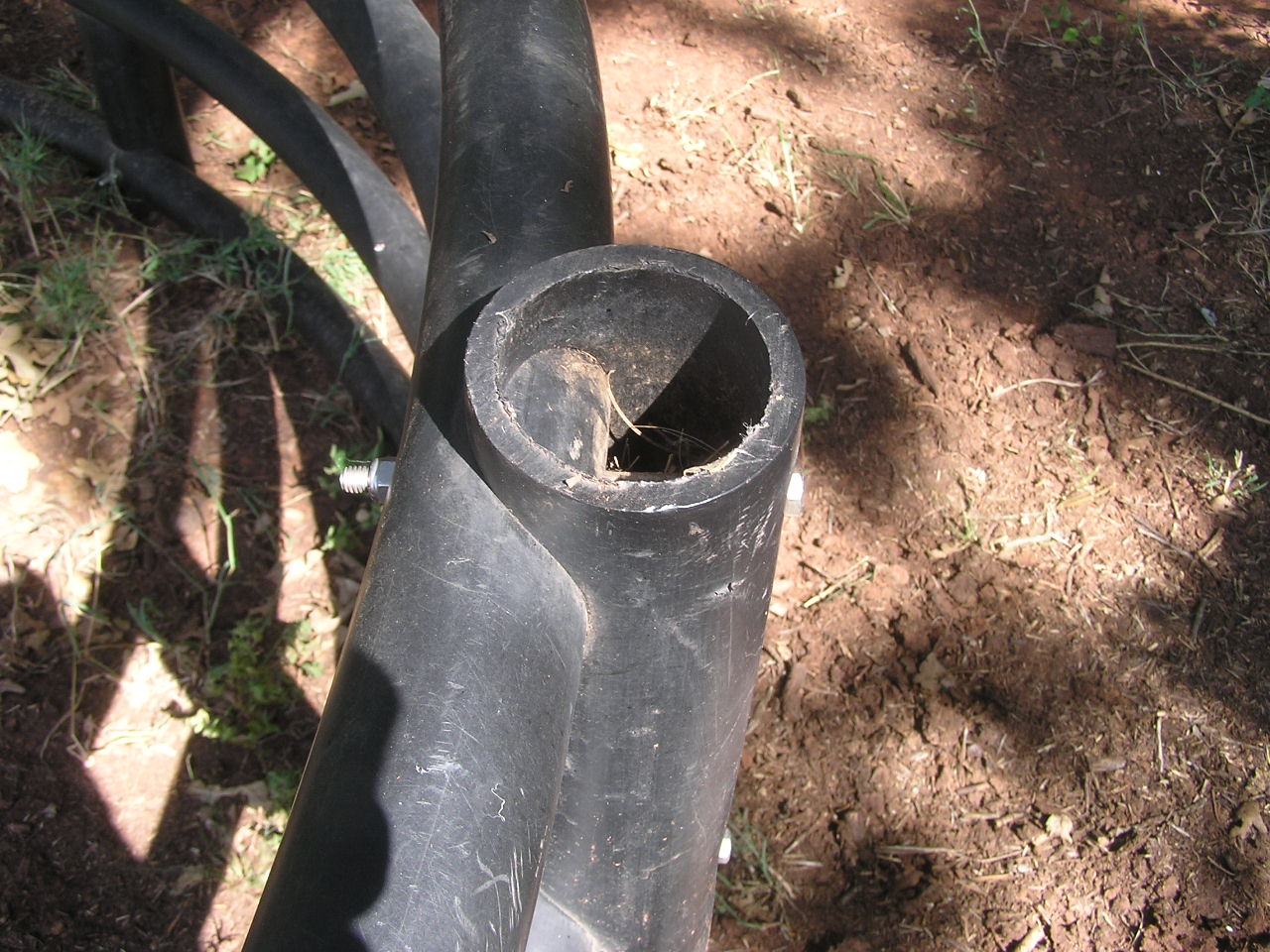

Took some measurements, the legs are 3-1/2 outside diameter, 3/8 wall thickness and 33 inches long. They are notched for the rings to fit into:
The 8' diameter Polyethylene pipe rings are heat fused together:
Here is the link to the company that built ours: Century Livestock Feeders | Shidler, OK
View attachment 569349 View attachment 569350
The one I saw had larger (5"?) uprights and 2" (or so) rings that went through holes in the uprights.

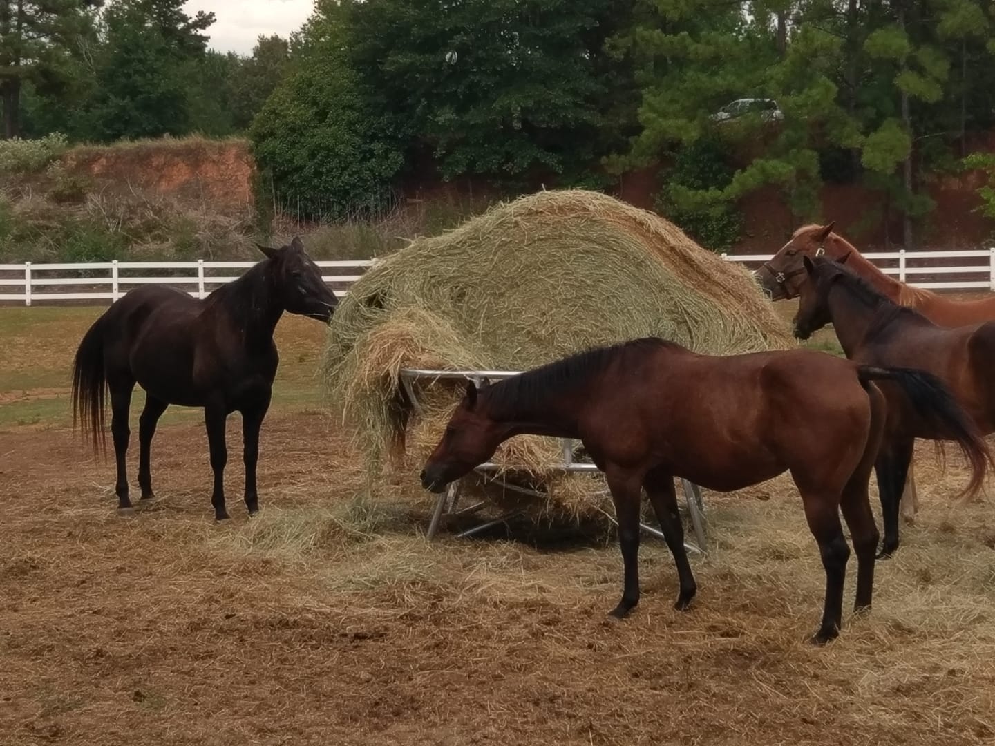

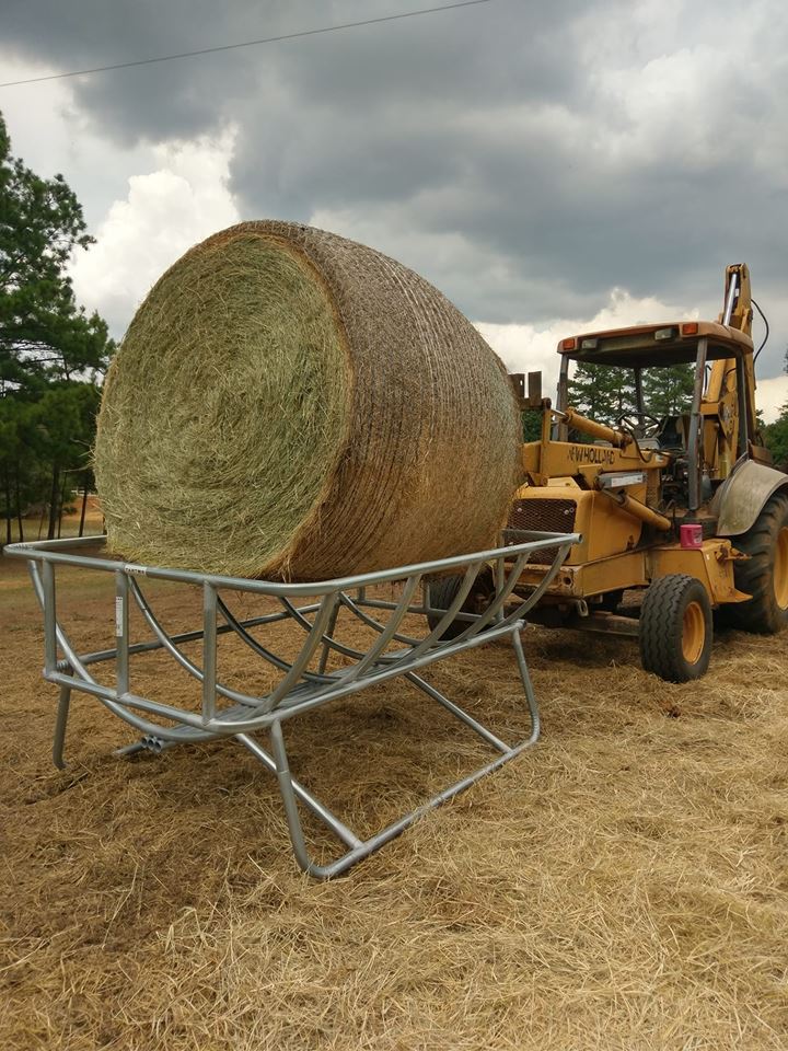

I've been to about ten different feed stores looking at hay rings, and the one thing they all had in common was a lot of rust. The poly ones are also very common, but nobody recommended them for horses due to their height. Cows are able to get under them easily to eat, but it would be more work for a horse to do that. I also found plenty of one inch square tubing hay rings for $110 to $125 that where too tall, but probably easy to modify for horses. It seems the most people get hay rings for cattle.
Today I went out to Mineola and found this. It's made by Tarter and cost $339. Comparing it to everything else I saw, this looked pretty good.
