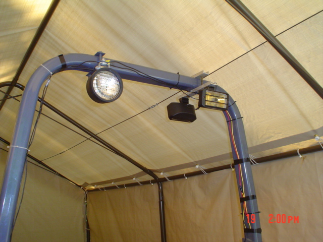

My dealer had put the round light (back work light) on for me when I purchased the tractor. Found last winter when we had much more than our usual amount of snow (over 5 ft) that when I was using the front bucket to move and lift the snow it would block the head lights. Just yesterday I put on the two fog lights using the "customer" use 15 amp circuit. I do plan on adding one more light facing forward, it will be a clear halogen to give me good forward light. Had the fog lights from a few years ago and never used them, the bracket was from some spare aluminum, had that for years as well. Have 151 hours my CK35 in about 16 months.

I mounted three 55-watt trapazoidal floodlights to a piece of unistrut, two facing front, one facing back, and then used U-bolts to clamp it to my roll bar. I wired them directly to the customer fuse in the fuse block and put a water proof marine rocker switch on the back of the 3pH lift control lever cover. This is very similar to the way that others have done it. Do a search here and you'll find photos (of others, not mine) on here.

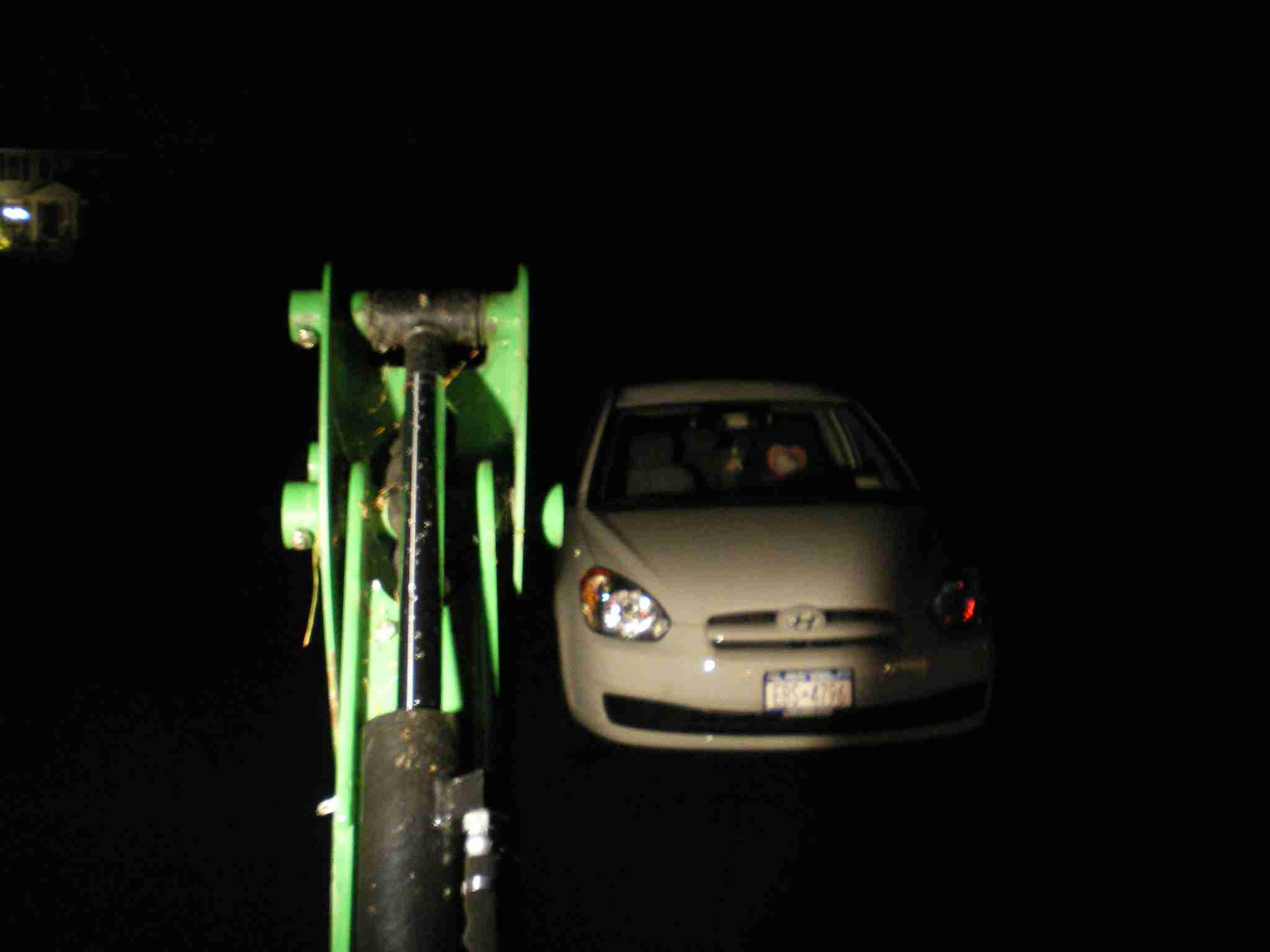

Hey Tkoza,
That has got to put out some light! Does it blind you if it reflects off of the back of your loader bucket? Or did you run wires for the transformers to the ROPS? I'd love to see a picture of that setup!

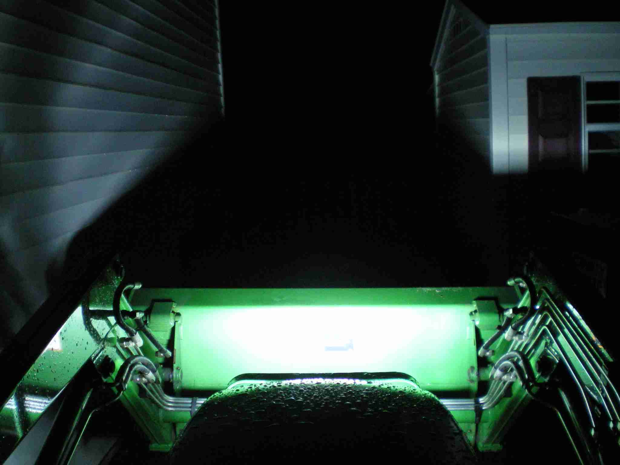

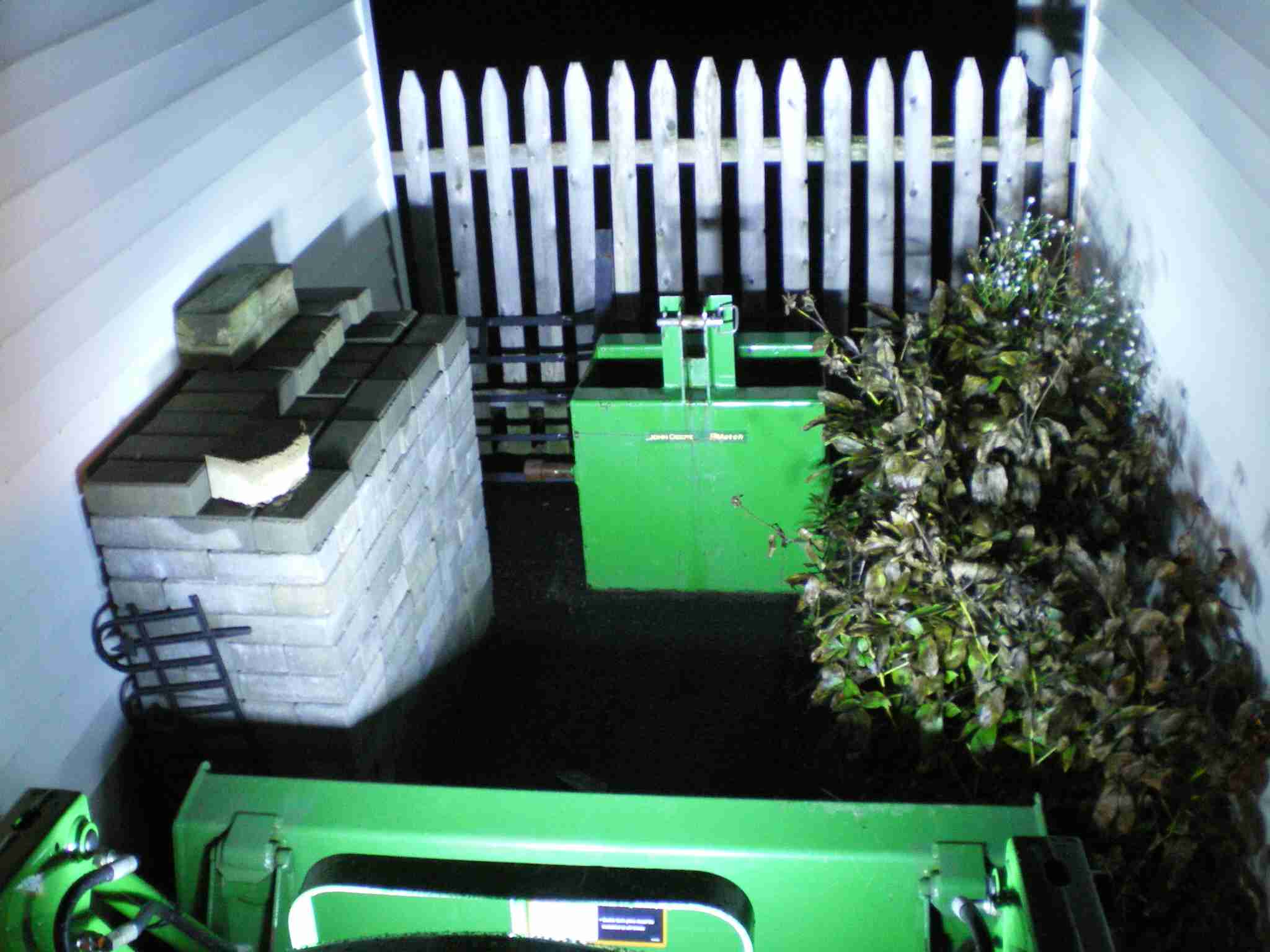

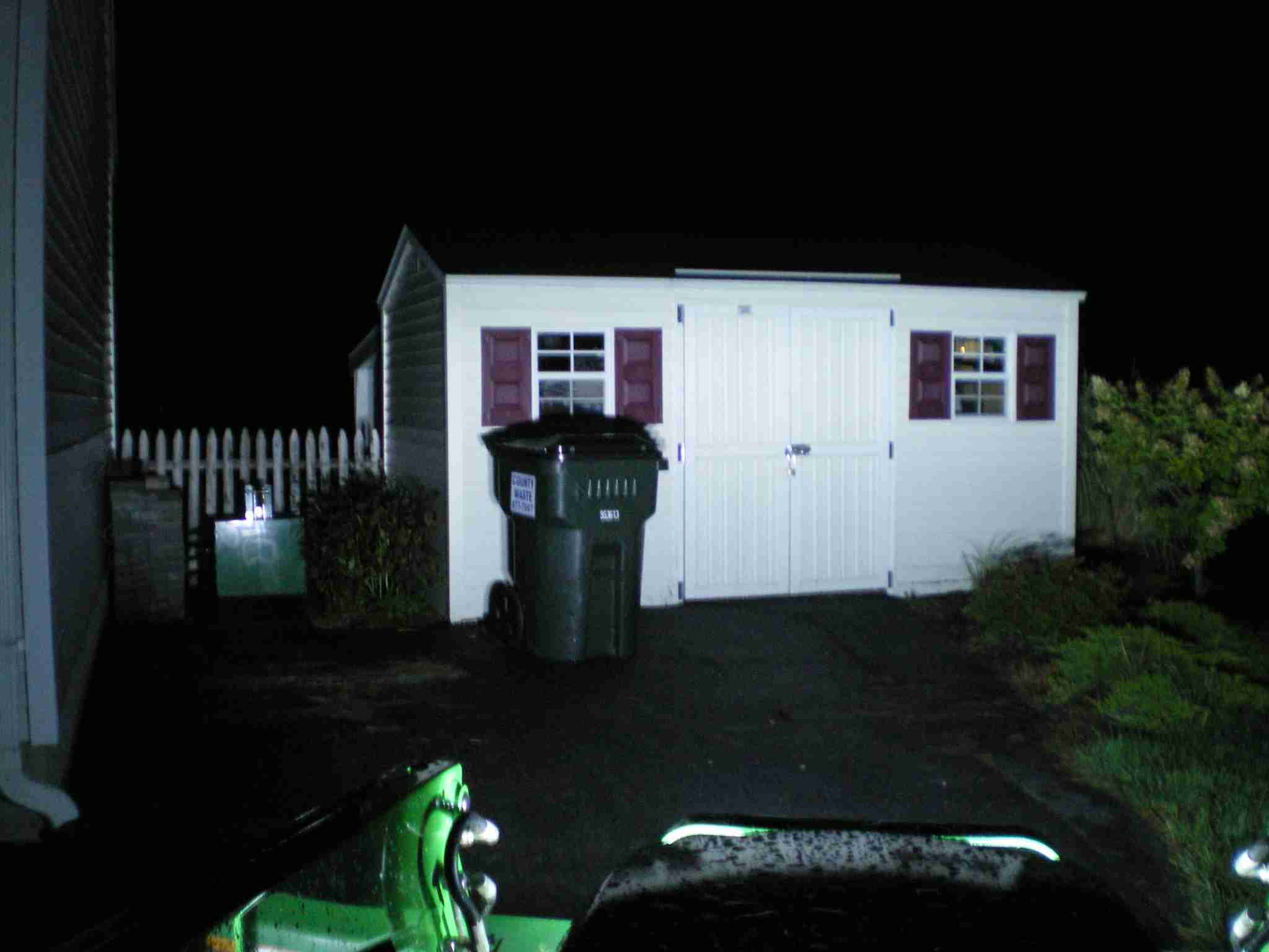

phill
i will get pic over the weekend
i have only used it one night mowing with great success they make my JD 688 bulb worklights look like candles
they are installed as my headlights
wiring from the bulb unit to the xformer is silicone jacket but it is a common 2 conductor weather pac so extension should be easy
my end goal was more light for the snow season up here at the corner of I-90, I-88(NY)
on the HID kits most are conventional lighting on low beam and HID on Hi Beam
they do have a short warm up time about a minute till full bright
todd
/ Headlight / Rear light solutions #10
phill
here are the pics
flash was off and point and shoot
on the FEL i can read the warning label clearly
sorry for the green paint in this section but the issue was lighting not paint
besides the green guys want an air suspension and subs
todd k
