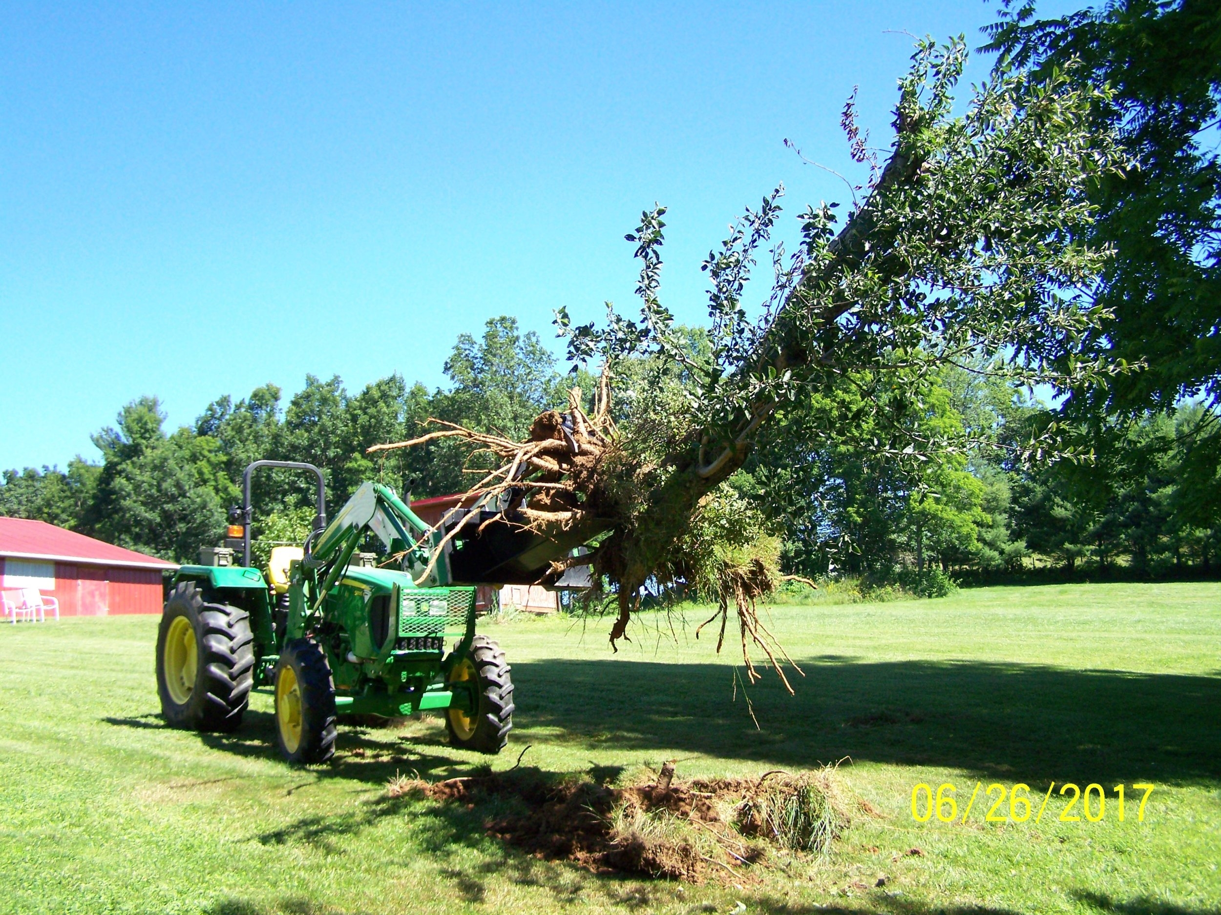

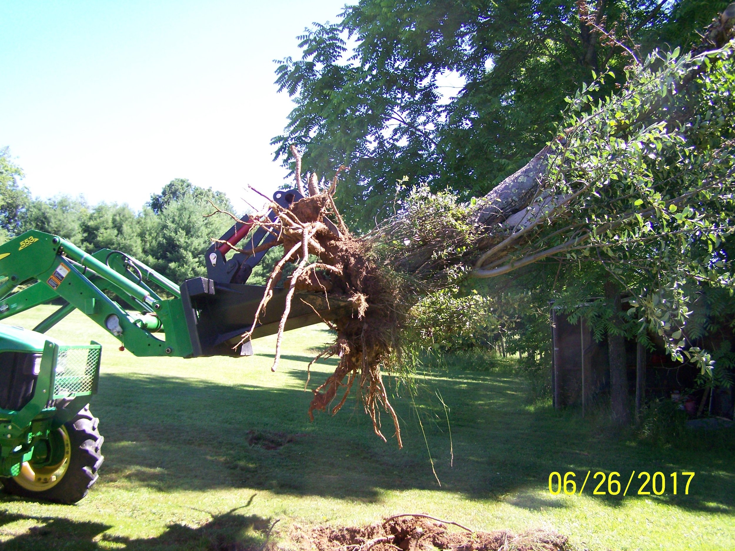

Wanked up grapple....that is funny. :D Unfortunately, I wanked mine up this past spring. Didn't mess up the frame, I blew the internal gasket on the rod, which is letting fluid bypass and return to tank.
Grapples are great tools. I have owned mine for 13 years. It is on a Deere tractor, but the concept in using one is all the same:
  • Keep your load low to the ground as possible, especially when moving.
  • Make sure your rears are filled.
  • Make sure you have something heavy on the back end for counter weight.
  • Do not back pull the ground using the grapple jaws. (ask me how I know)
  • Never grasp a tree trunk with grapple before said tree trunk is fully on the ground. (ask me how I know)
  • Insure your hydraulic lines are securely fastened to your loader arm so they can't get pinched. (yeah, ask me how I know)
  • A brush guard across your radiator and headlights is essential.
  • Buy the heaviest and largest grapple your loader will and tractor can safely handle. You will thank yourself later on.
  • Don't be afraid to experiment with what you can pickup and move with your grapple. You might be surprised.

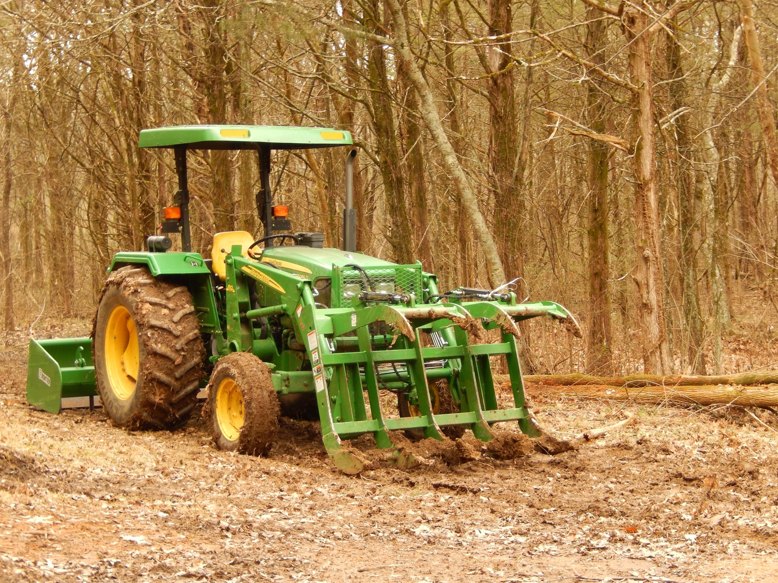

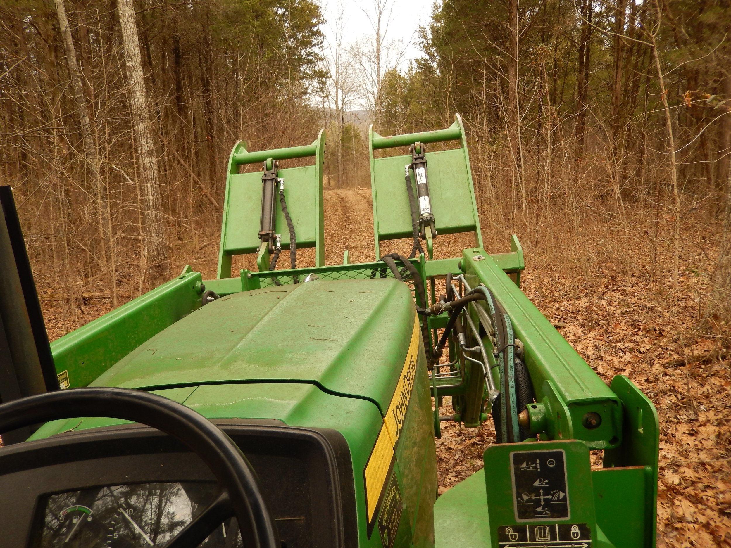

I don't know if you noticed but Camofurever1 has a JD 5055 which is a larger tractor than a L47.
When I bought my 800# grapple I had a 5065e. You didn't really notice the grapple weight compared to the Kubota.
My JD had loaded tires and I never bothered with a counterweight unless I was doing a really heavy lift or on a slope.
Pictured is a stump bucket/grapple (about 400#) in use.
The L47 is a pretty powerful, but it's still a small (compact) tractor. A 50 series JD is a utility size. There is no comparison.
BTW the JD didn't "gallop" like the Kubota does.

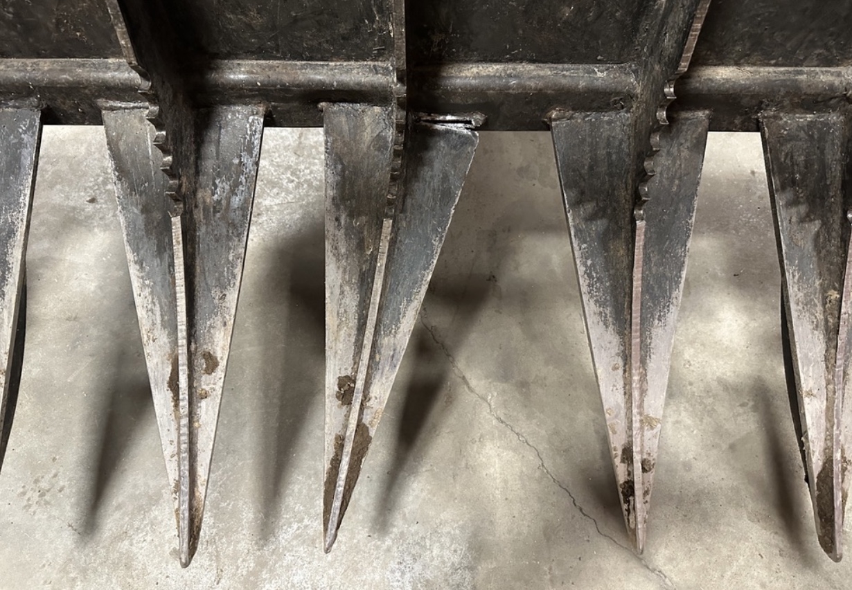

Check out this 1,100lb single lid grapple - this happens when you weld 1/2" thick mild steel tines to 1/4" thick mild steel tube.
Heavy does not mean strong or durable.
