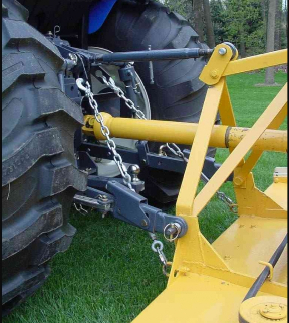

Anybody have a mechanical or electronic height indicator for 3 point hitch.... Thinking it might be good when using rotary mower with 3 PT since tractor does not have lockable control for three point and it may be easier to set 3PT to correct height with out always getting off tractor and using gauge block or ruler....
Sort of brainstorming something at this point and looking for ideas... Made mechanical FEL bucket level indicator, and was thinking something similar for height on rear 3PT.... But electronic with an indicator up front (on dash) seems like good idea so one is not always having to swivel in seat or look over shoulder to see indicator...

Run a chain from the lift arms to the topline. Chain will prevent the arms from going any lower than your desired height. Might run into clearance issues with the PTO shaft on smaller machines.

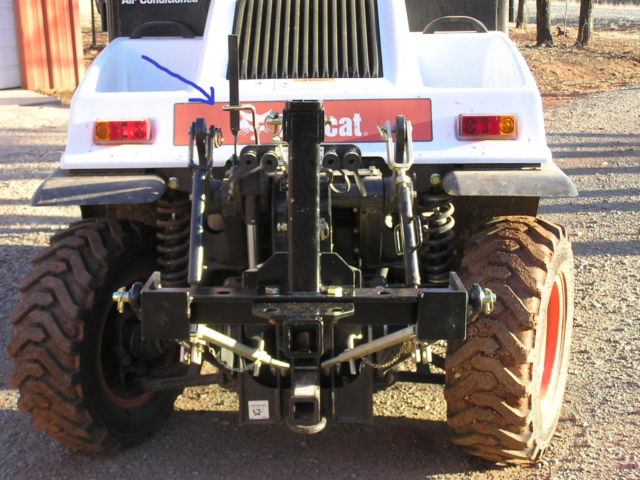

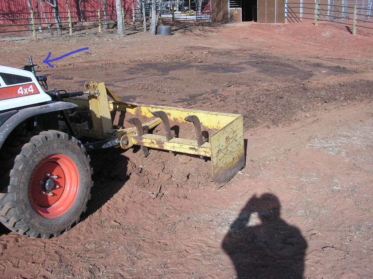

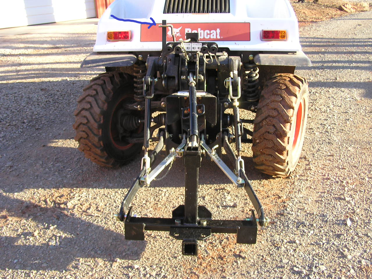

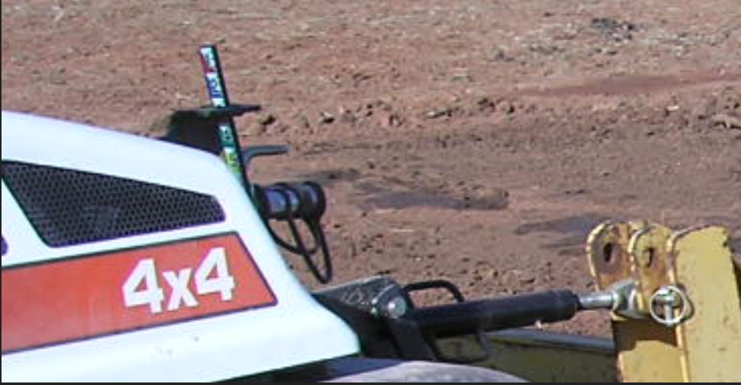

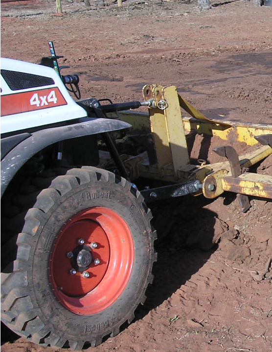

Yep, comes standard on the Toolcat and visible in the rear view mirror:
Zoomed:

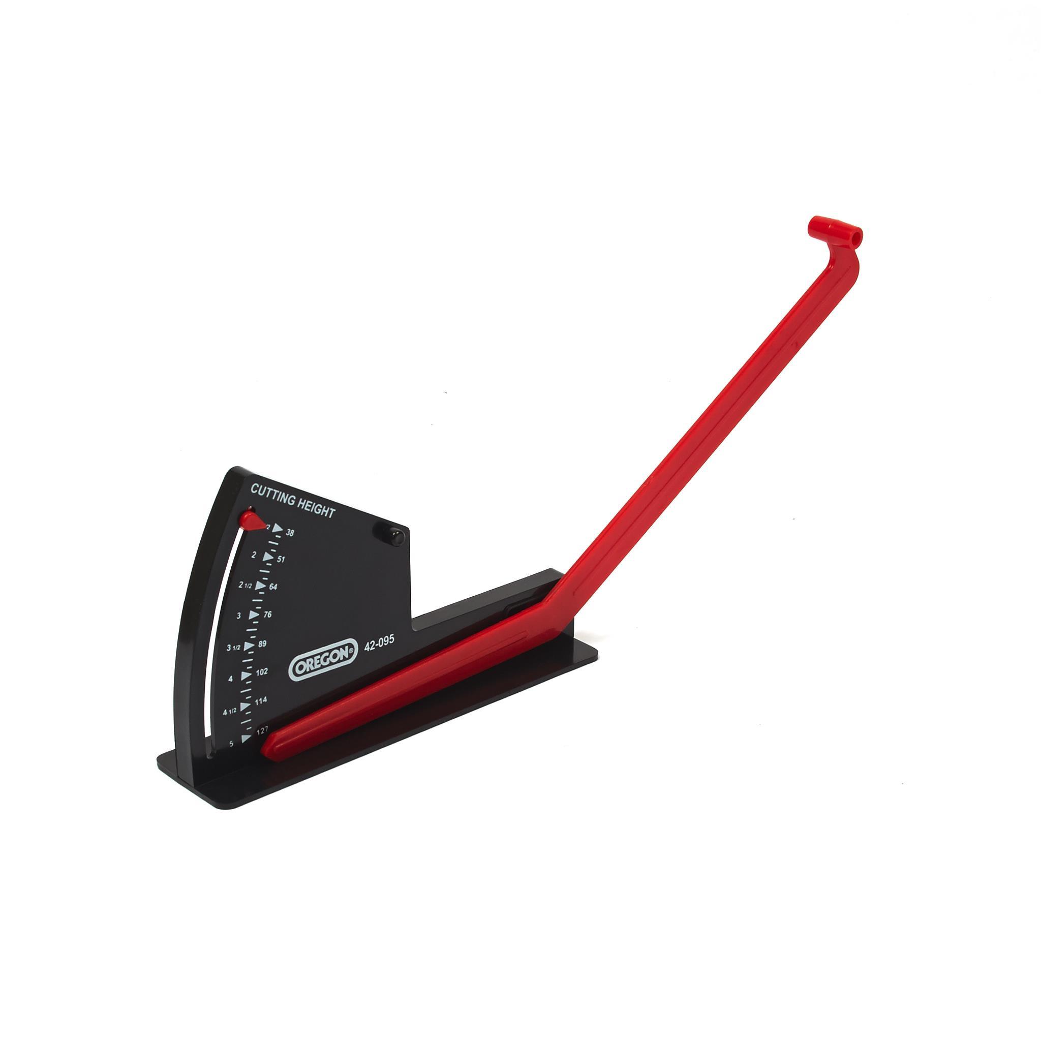

Noticed the height gauge for mow deck blade to ground measurement that JD and Oregon puts out and kind of thought if it were mounted on fender and with link to 3 point hitch arm it might work as indicator... On Oregon unit it seems to have movable pointer (reference) and swivel pointer (forget the numbers) and just set up height on flat ground and put reference pointer at correct setting and movable pointer should point to reference pointer when 3PT is at correct height... Or is this all to simple...

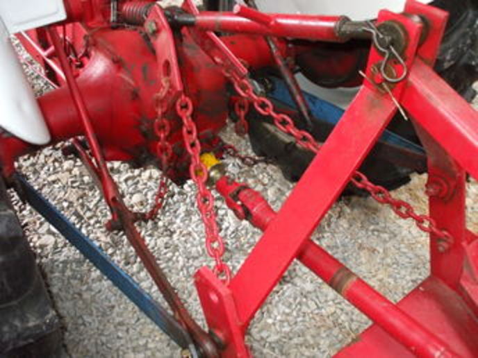

Yep, check chains are what the OP needs:

Chains are the easy solution. You can raise mower when needed and then lower away. Chains will prevent it from going too low. Also will prevent the “droop” even if using position control. Might have to bolt on or weld on a loop or hook or such in the right places.

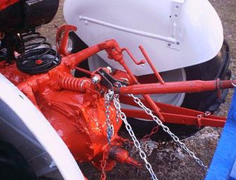

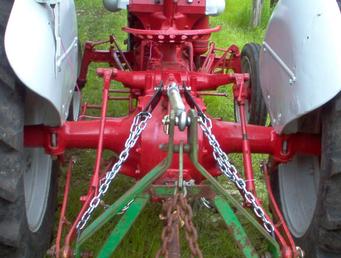

Sort of changed direction in though process.... Think "Check Chains" may be simplest solution after experimenting with 3PH and getting better understanding how it works....... Only thing now is what are brackets check chains lock into called and where to acquire them...
Also found a "kit".... But I have lots of chain and "stuff"... Just not the nice looking (keyhole) backets...
