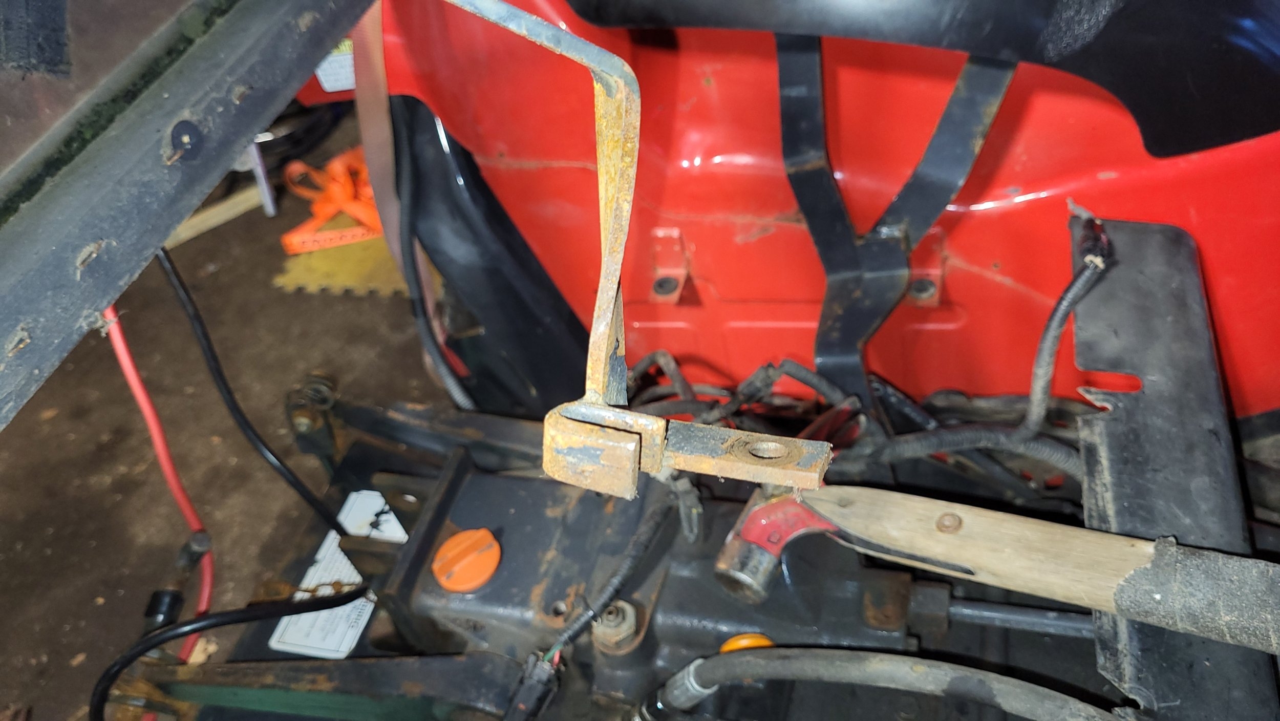

The 3ph does not raise. I did check the 3ph lowering control knob when I first went to see the tractor. I wasn't that lucky.
I found a claw hammer jammed under the seat and the position control lever was bent.
I moved the position control arm by hand and nothing. The feedback arm jam nuts are also loose.
I think the feedback arm moves the spool in the position control valve to divert oil to tank until the arms reach the setting position then flow stops. The arms should stay in that position until the position control level is moved to raise the arms then the spool is moved by the position control arm to supply oil to the piston and so on.
The original owners wife said her husband was a hack. I see why she said that with some of the things I've found on this tractor.

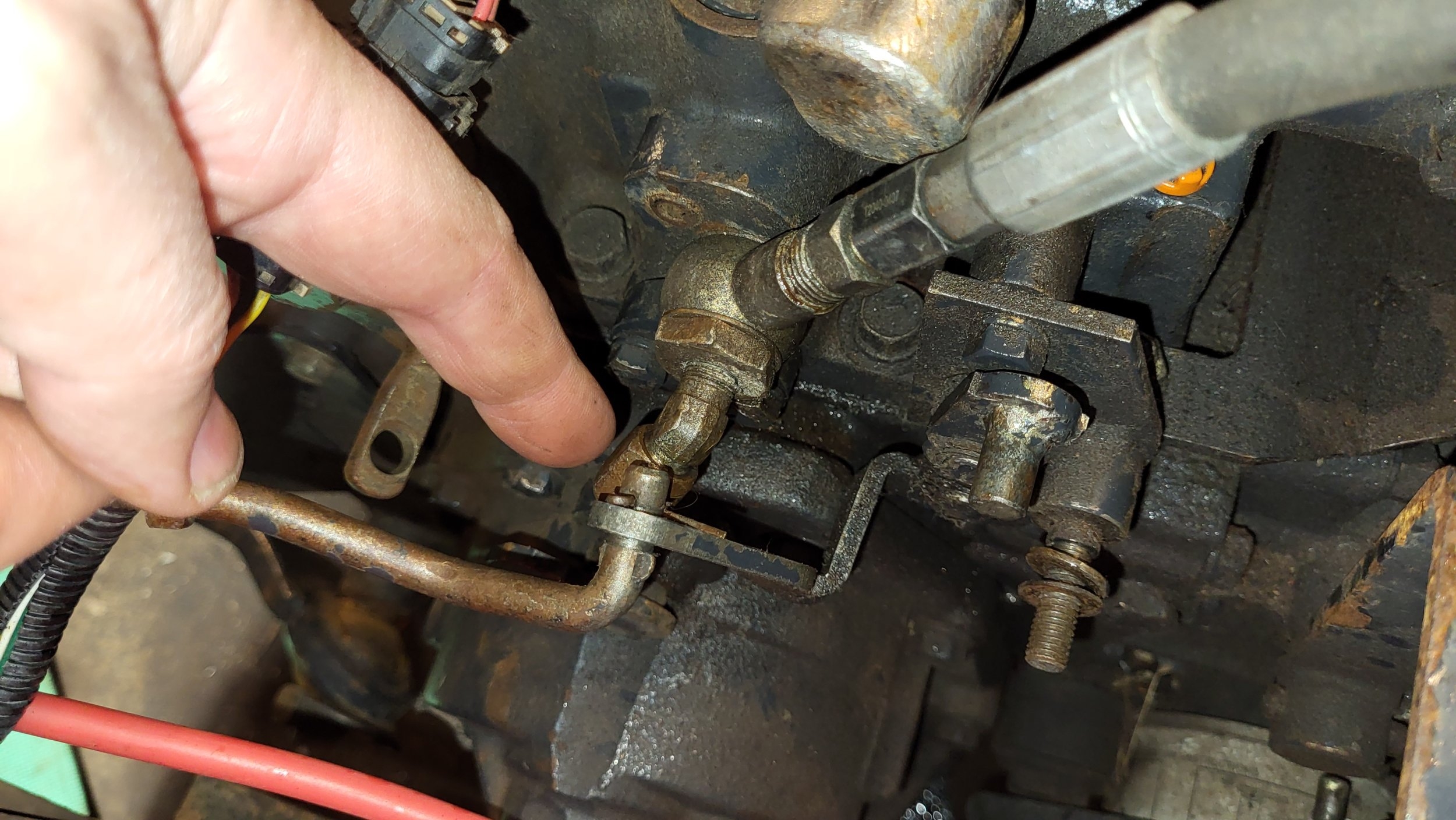

I think the feedback arm is my issue. Is this 45 degree elbow and cap oem? I assume it's for rear hydraulics.

On my 2400H the pressure line from the pump had a round junction block with two hoses that come out the face. One of these is pressure to loader valve and other is power beyond feeding the 3 point. If yours is the same follow the power beyond hose back to where it connects on transaxle housing. Is that the same hose that the 45 degree fitting is in? If yes what that 45 degree fitting connect too?
From memory I can push or pull ( don’t remember which) the feed back rod and make the arms move.

The 45 degree is not connected to anything. It's capped off. I believe it's for an optional addon rear hydraulic control for blower chute control or a hydraulic toplink.
The hydraulic line connected to the banjo is coming from a block near the front.
