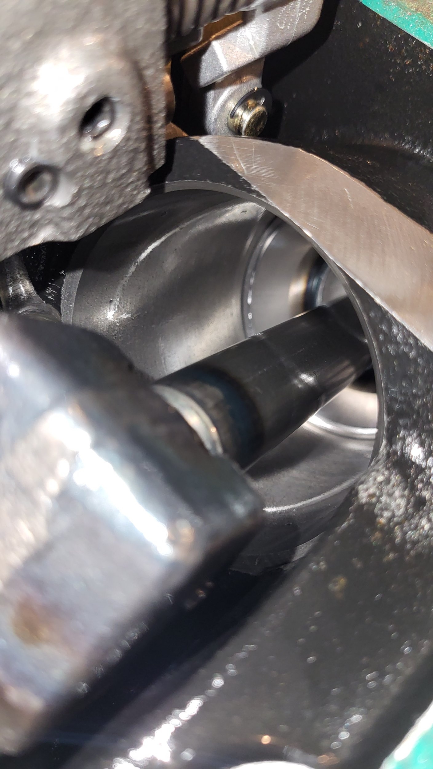

I didn't get a chance to start the tractor last night as it was getting late.

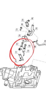

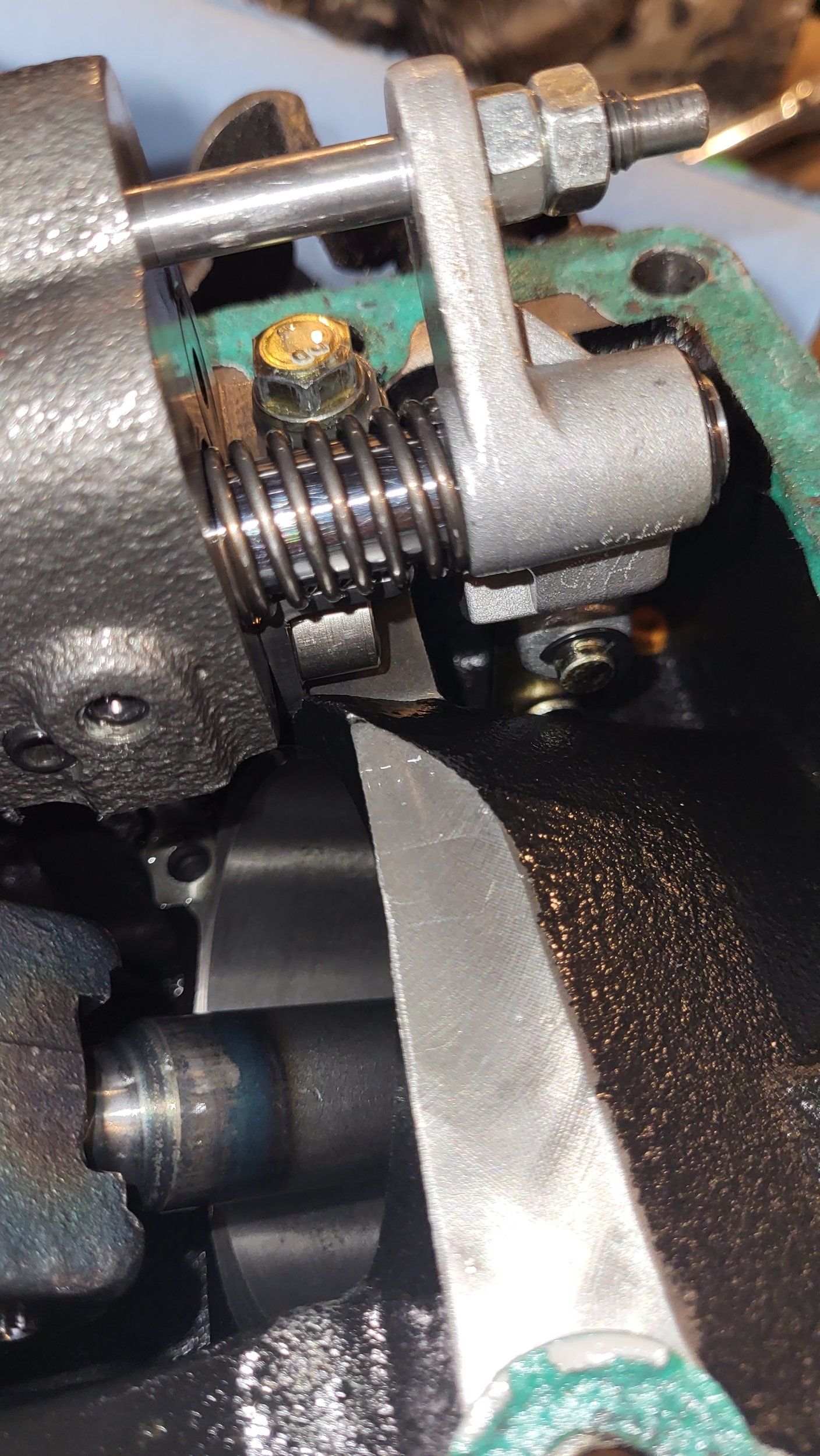

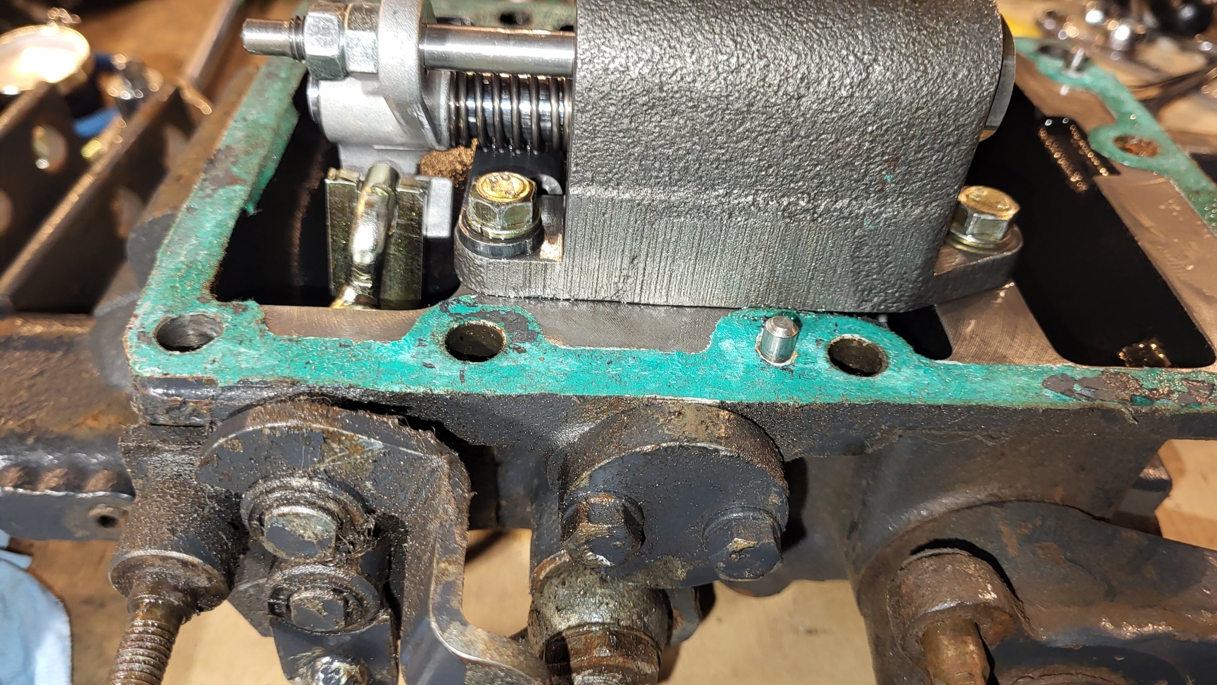

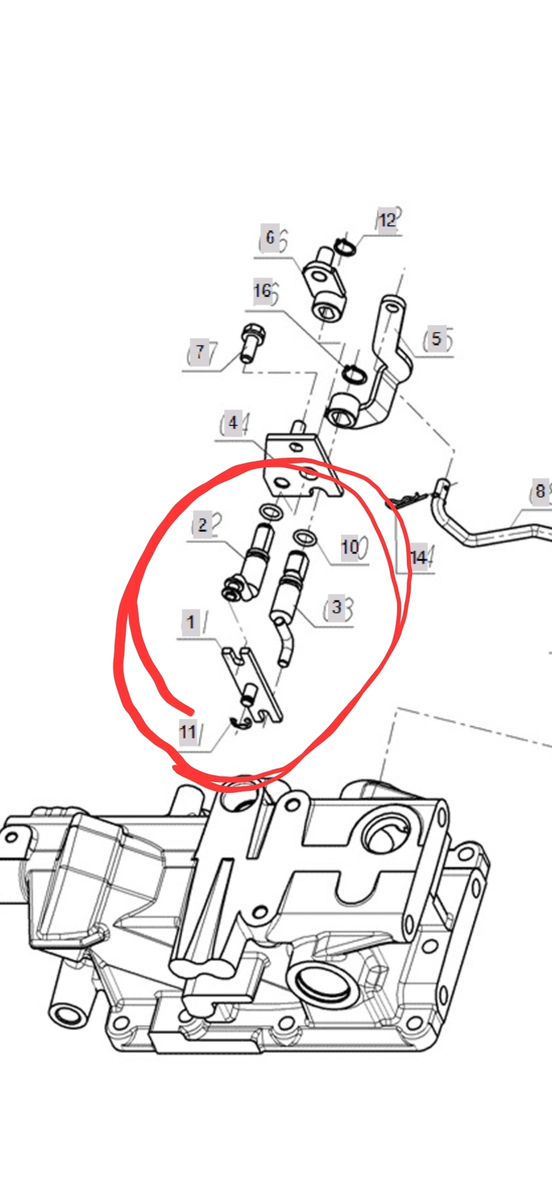

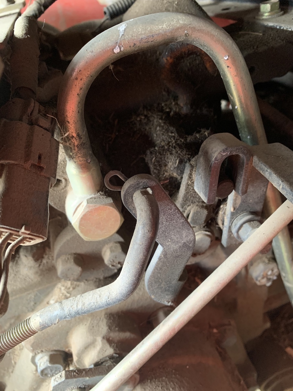

I had found a manual for setting this valve but can't seem to find it again.
The two levers, positioning and feedback, both need to be connected for the spool to move. If only one is connected the internal arm just pivots.
Jeff,
per my post #18 check that banjo fitting to see if previous blocked it when he added that 45 degree fitting. If yes do not run the tractor until you get that replaced or you could and probably would be dead heading the pump over relief since that is supposed to the connection back to tank via 3 point valve for power beyond.

It's my understanding the hydraulic hose (hardline on yours) is the supply line from the pump. Fluid enters the position control valve here and returns to "tank" in the rear differential. It doesn't appear the banjo bolt would be blocked.
I've got it all back together and it's working but not perfectly. I'll try adjust the linkages after supper. It raises and lowers but the positioning is off.
At what RPM does your 3PH start to move. Mine will not move at idle. I'm now thinking I didn't have to dismantle anything and just unbend the lever and idle up the engine.
