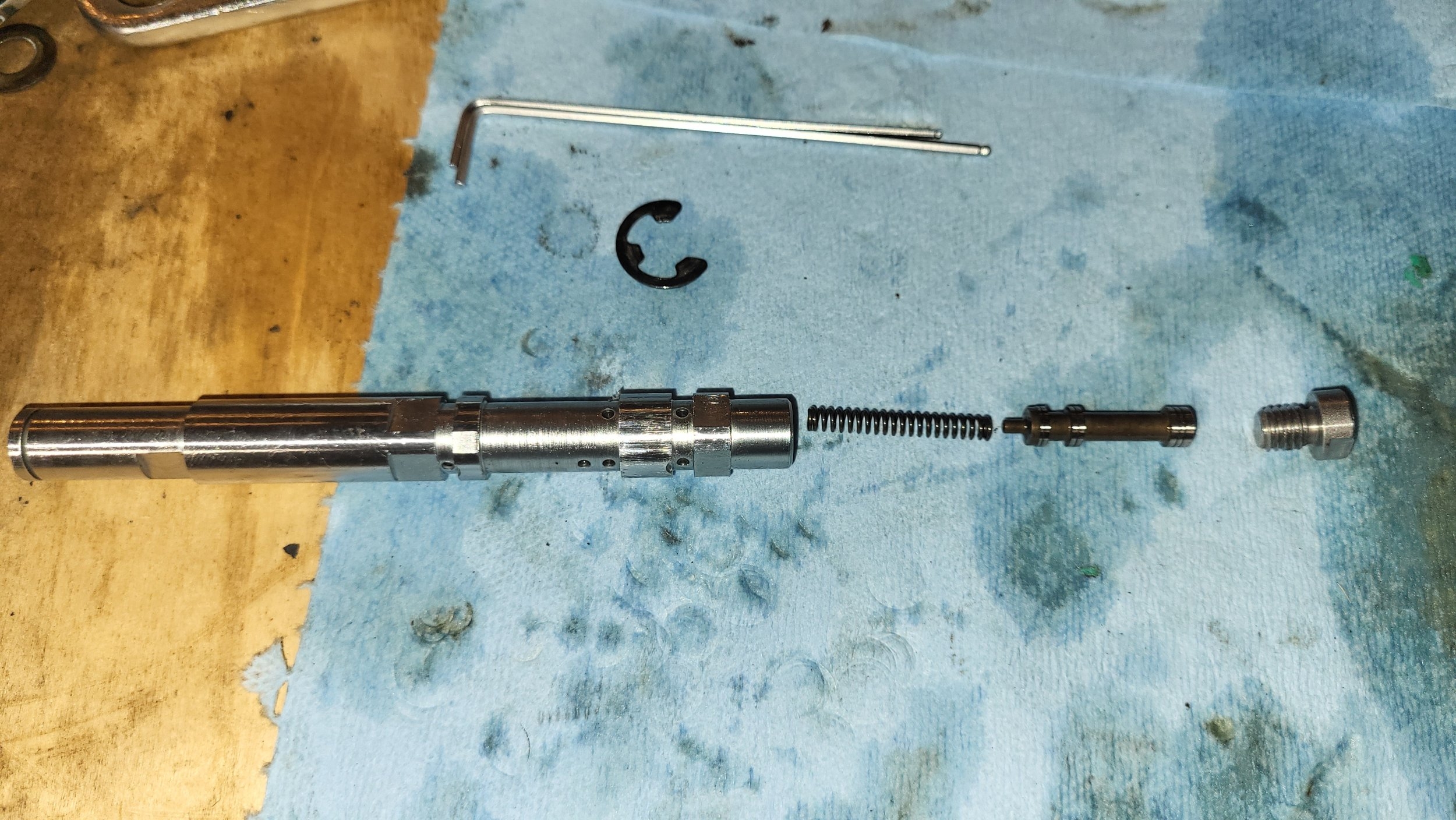

Can you analyze how the oil is supposed to flow thru that valve to determine if the spool is not positioned correctly. I realize easy to be armchair mechanic vs having parts in hand but a single sliding spool should not be this difficult.

Solved!
The main spool has another rather small spool inside it that in my case was stuck.
Cleaned it well and reassembled. Lift arms now raise at idle.
Branson 2400h position control valve fix.
   / Hello from a new Branson 2400h owner. #63
Jeff
Great job on diagnosis and thanks for posting the solution.
   / Hello from a new Branson 2400h owner. #64
Great work on troubleshooting this one out Jeff. You really had to go arms deep on this one but you figure it out.
