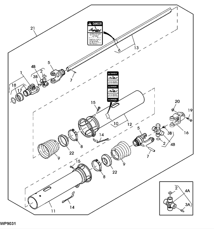

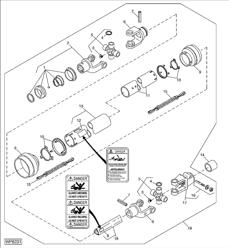

I would double check. Looking at the exploded parts diagram on John Deere - Parts Catalog, it appears that the driveshaft is part number is either W45843 (item 18 in section 15 or 16) or AW32510 (equal angle shaft version, item 13 in section 17 or 18) both of which are one piece shafts with 2 piece shields over them.
Section 15/16:
Section 17/18:
Aaron Z
Section 15/16:
<img src="http://www.tractorbynet.com/forums/attachment.php?attachmentid=318223"/>
Section 17/18:
<img src="http://www.tractorbynet.com/forums/attachment.php?attachmentid=318222"/>
Aaron Z
Well that looks to be right.

it is held together with a roll pin
