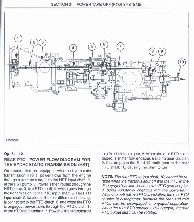

You said the mouse "pee corroded the lower pto shaft and ate into the seal area." The PTO shaft is not the lower shaft. It's the upper shaft leaving the HST transmission. The lower shaft is the shaft going into the gearbox where you select Hi/Neutral/Lo range. I don't want to pick on you because of nomenclature, but I'm still not sure where your failure is. I would sure appreciate anymore details you can give us. I know you are frustrated as any of us would be. You should be; you didn't cause this. You are just the "lucky" guy who has to pay for it.:eek:

Hello Jinman
Thanx for clarifying . The dealer told me the lower shaft was the pto ?
The HST has the one shaft coming in from the engine and 2 shafts going out the back.
between the HST and i guess what is the transmission their is a cavity where the shafts couple to the shafts that
go into the trans.
in this cavity is where the mouse nest was and was about half way full covering the lower shaft.
the lower shaft coming from the HST is the one that has the rusty pitted seal surface causing the seal to fail.
Please understand i am in no way blaming NH for the problem. I am in no way asking for free parts or to be covered under warranty.I also believe the tractor to very well built (except for the place where the mice can get in) and was very happy with it until i learned that NH has no interest in supplying crucial parts after warranty.
It was totally the mouses fault either peeing on or breathing on this shaft or a combination of this and condensation from the outside was more than likely the cause and i am willing to pay for the repair. As it stands the repair thus far with seals and fixing the shaft will be close to $3000.00, I was just hoping to put a new shaft in while it was apart.
Regardless the fact remains to repair correctly would have been be to replace an 8" shaft that NH refuses to supply without buying an $8000.00 HST.

Nemco, it's very little consolation, but I'm attaching a drawing of the PTO power flow from the engine, thru the HST, and through the rear transmission. You can clearly see it is the upper shaft. You can also see the void area between the HST and the rear transmission where the two shafts are coupled (just to the left of reference #4). The only way I can think of that a mouse could get into this area is through the port where the HST relief valves are located. There must be an opening inside the cover. I thought this area was sealed, but in fact it may not be.
How much fluid were you losing? Is this one of those seeping leaks you just have to learn to live with or is it a huge leak? I'm really siding with you on the repair parts issue. It's obvious that NH and KYB decided the number of failures of these shafts would never justify having replacements in their system. I'm sure they decided it was cost-prohibitive to have a part in the system that sees less than say 10 failures throughout the whole line of tractors. To me, it's not so much an HST issue as NH's decision to not carry the part. Did you know that there are some simple rubber o-rings inside that transmission that are "not serviced separately"? Wouldn't you really be "fried" if you had an o-ring fail and they told you to replace the whole transmission? This is simply a case of bad parts support instead of a bad transmission or bad design.:mad:

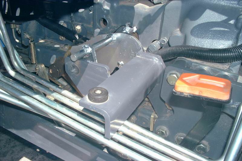

you know, I still cannot find the hole or entry point where they got in. so as i visit the dealer tuesday with the sleave for the shaft i will look and let you know.
I'm attaching a picture of where I think the mouse may have found its access. I had a weld break on my HST pedal mechanism and decided to repair it myself instead of taking my tractor to the dealer. This picture is when I was reinstalling the pedal mechanism and above the silver plate in the top-center (slightly left) is a hole going into the transmission case. This is so the HST relief valve can be serviced from outside the transmission. There is a hole like this on each side of the housing. I thought this was only open to the area around the HST, but I'd bet it has an opening inside that the mouse found suitable for setting up "housekeeping."

The entrance for the mouse I believe was probably located on the underside of the bell housing between the motor and the trans. There is an inspection hole located right above the front drive shaft. It is about 2"x3". Here you can see the front "input shaft" and there is plenty of room in there to make a home.
