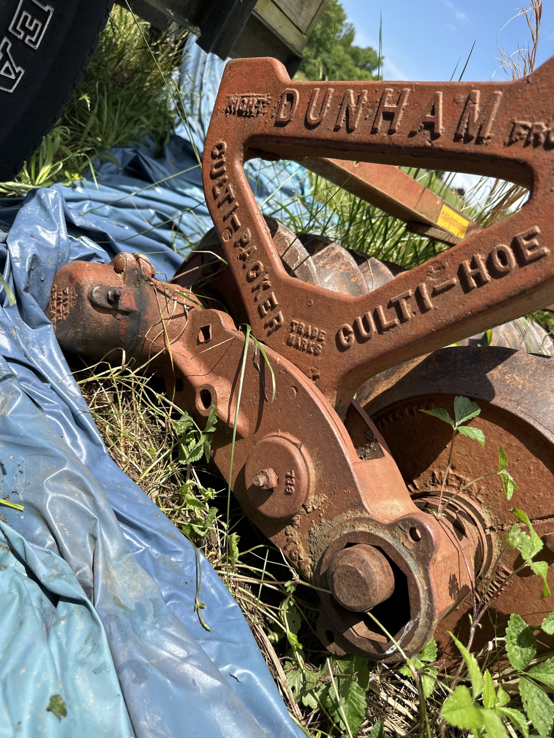

Trying to get grandpas old cultipacker back up and running for deer plots etc. some time ago the end cap i guess whats called a “grease cap” came off and has rendered it essentially useless. Anybody got any ideas on how i can fix it? Ive briefly scoured the internet for a replacement part but havent found one yet. Any halfa@@ fix to get it running would be appreciated it. It’s a 6-7 foot Dunham. Picture will be attached

Thanks! Ive recently been seeing that talked about a lot but wasn’t sure how to apply it to my problem of missing the cap. Speak to me like a child, so that bearing would be greased up and shoved in place of where the end cap is? Then I would operate with no end cap just maybe hit that wood bearing with grease every so often?
/ Help. Dunham cultipacker #4
Still need to put a cap on it to hold in but you can make that or they might sell cap also
/ Help. Dunham cultipacker #5

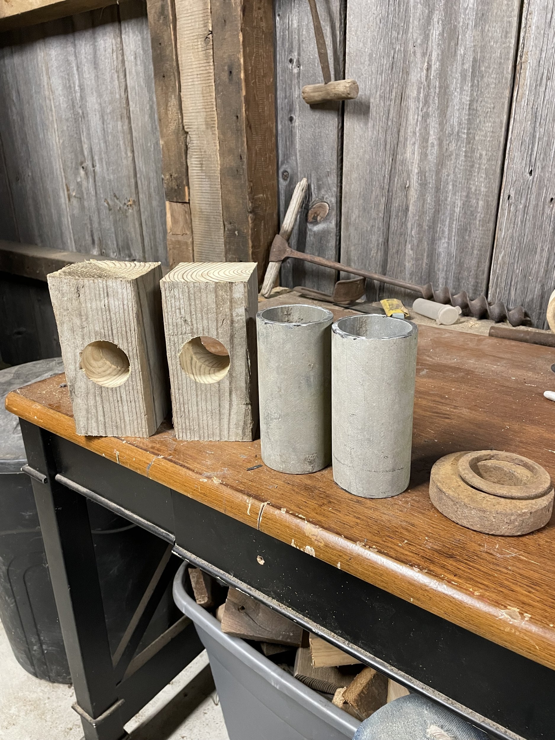

I would try and make a replacement wood sleeve bearing and slide it into the steel housing. You could turn the outside diameter on a lathe and drill the inside diameter.
I’ve fixed up several old cultipackers that were of a simplified end bracket design, using pressure treated pine 4x4 with cross drilled holes, about 1/8 inch larger than the shaft diameter. Those last for many years of food plot usage, and never even need grease.
I’d probably use white oak to make the sleeve bearings for the style end caps that your Dunham has. Those should last quite a few years and would turn better on a lathe than pressure treated pine.

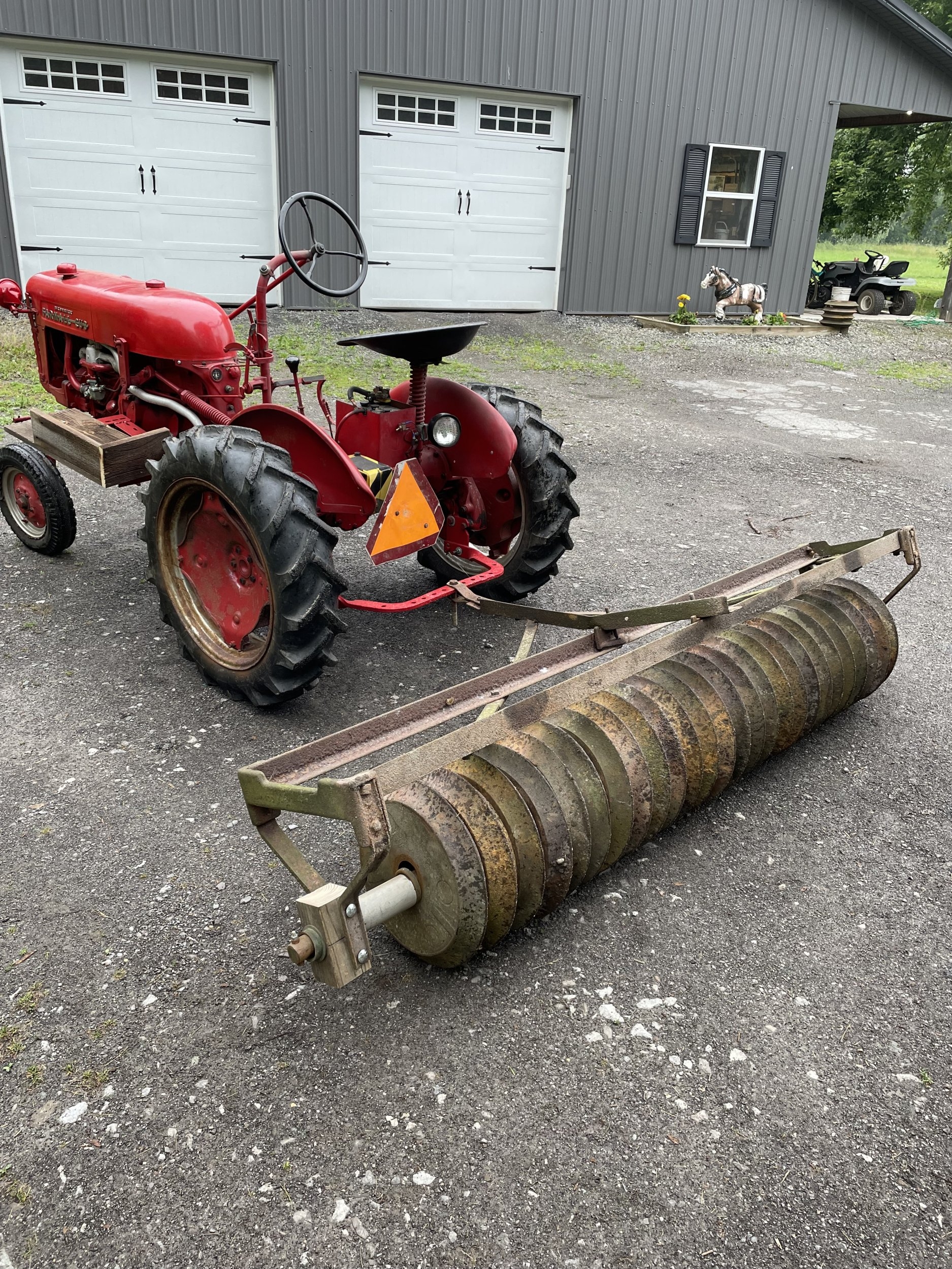

One of my neighbors dragged this 8 footer out by the road a few years ago. I paid them $ 40 for it. The frame and several wheels were broken, and the bearings were gone.
It took me about (2) hours to repair the frame, take off the broken wheels, make some new wood bearings and steel spacers, and make it into a serviceable 7 footer.

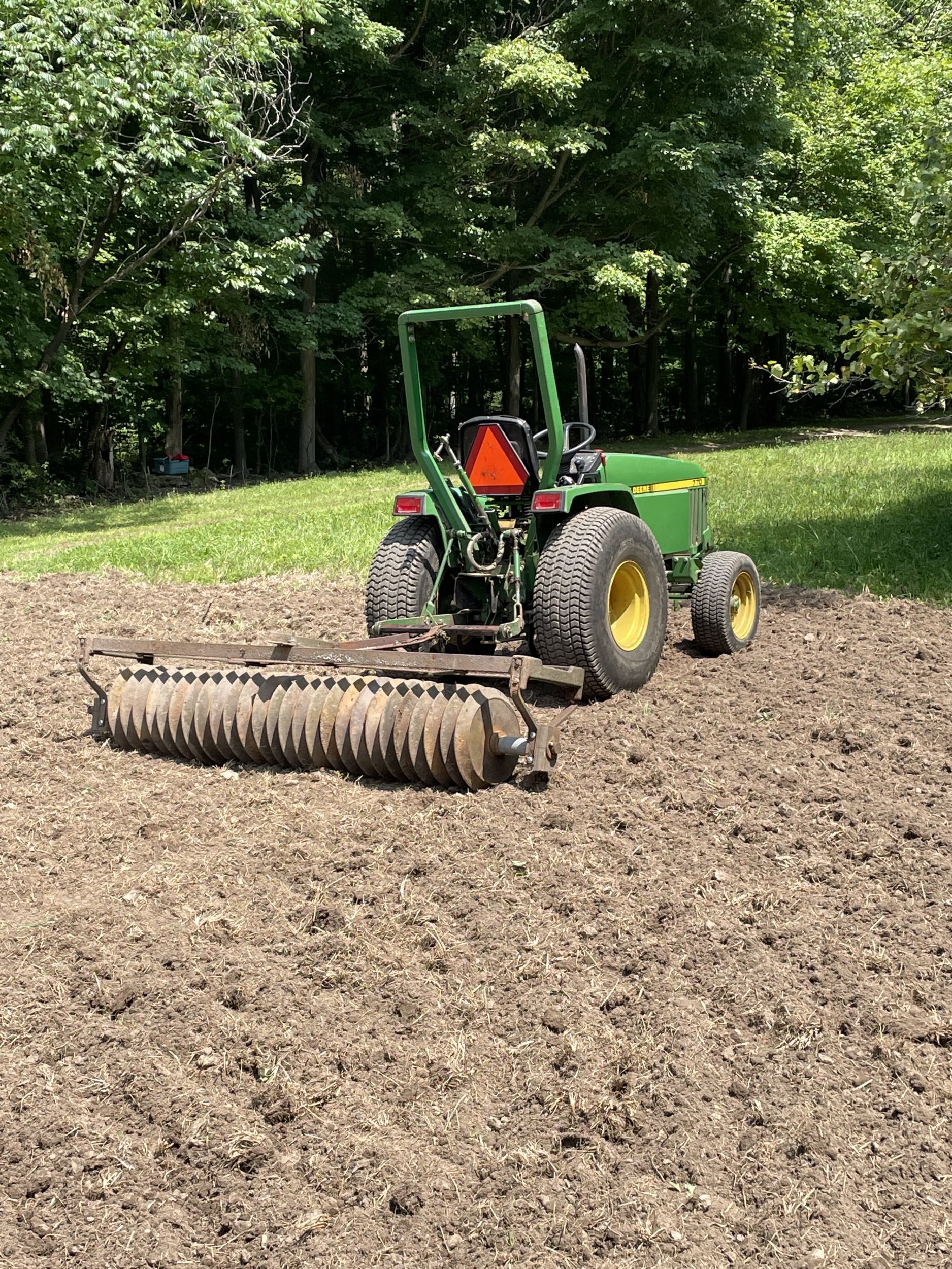

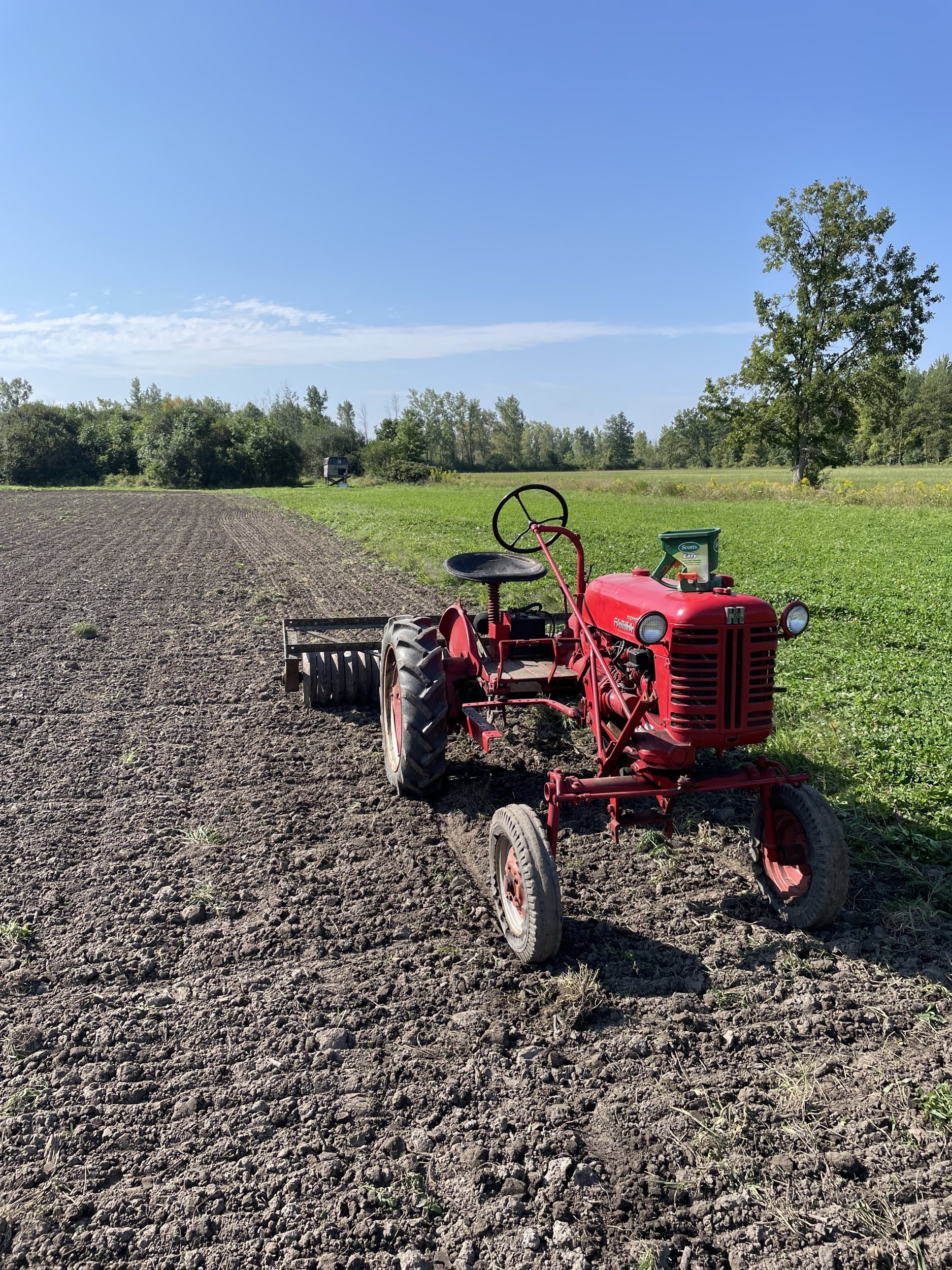

Here are my two “rebuilt” 7 footers in action last fall, pressing in wheat/white clover and turnip plots:
