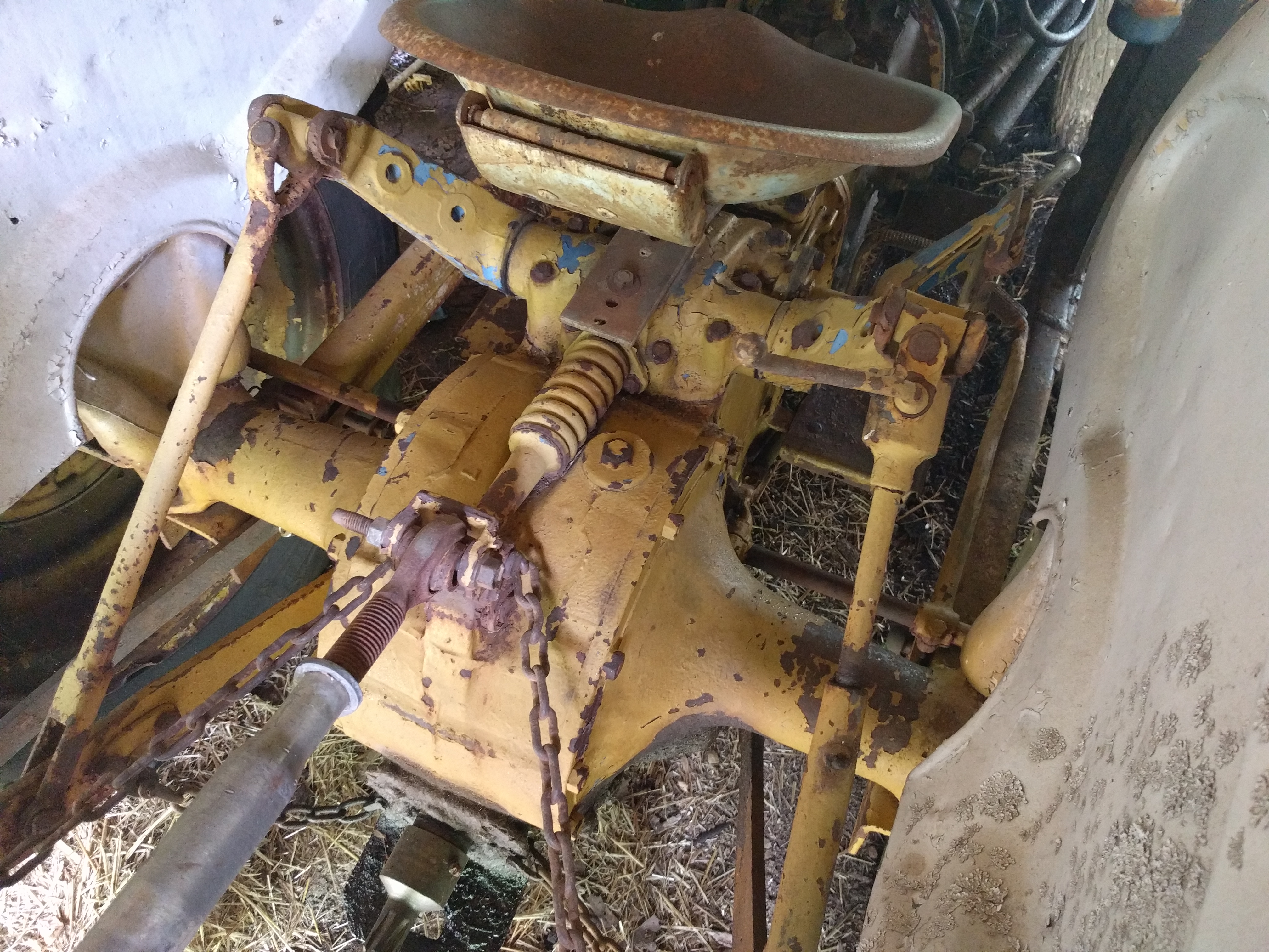

So I am brand spanking new to the tractor world! I have recently purchased on older Ford tractor, that after hours of research, I believe is some type of industrial model. I am attaching a picture of my tractor. There are 2 different rear wheels on this tractor (as I figured out after I bought it!), the other side has a disc that is mounted to the rim in 5 or 6 spots (can't remember right now).

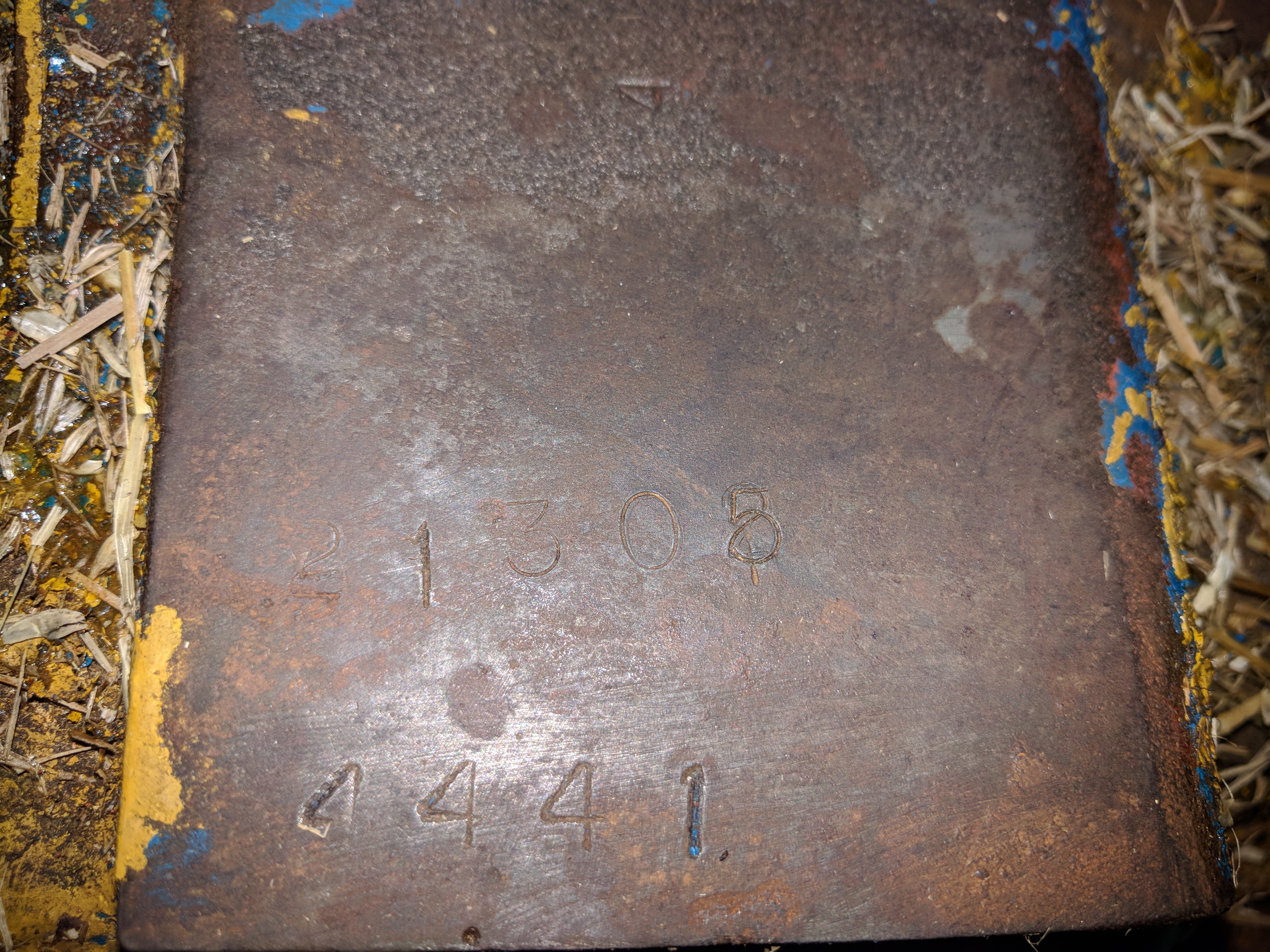

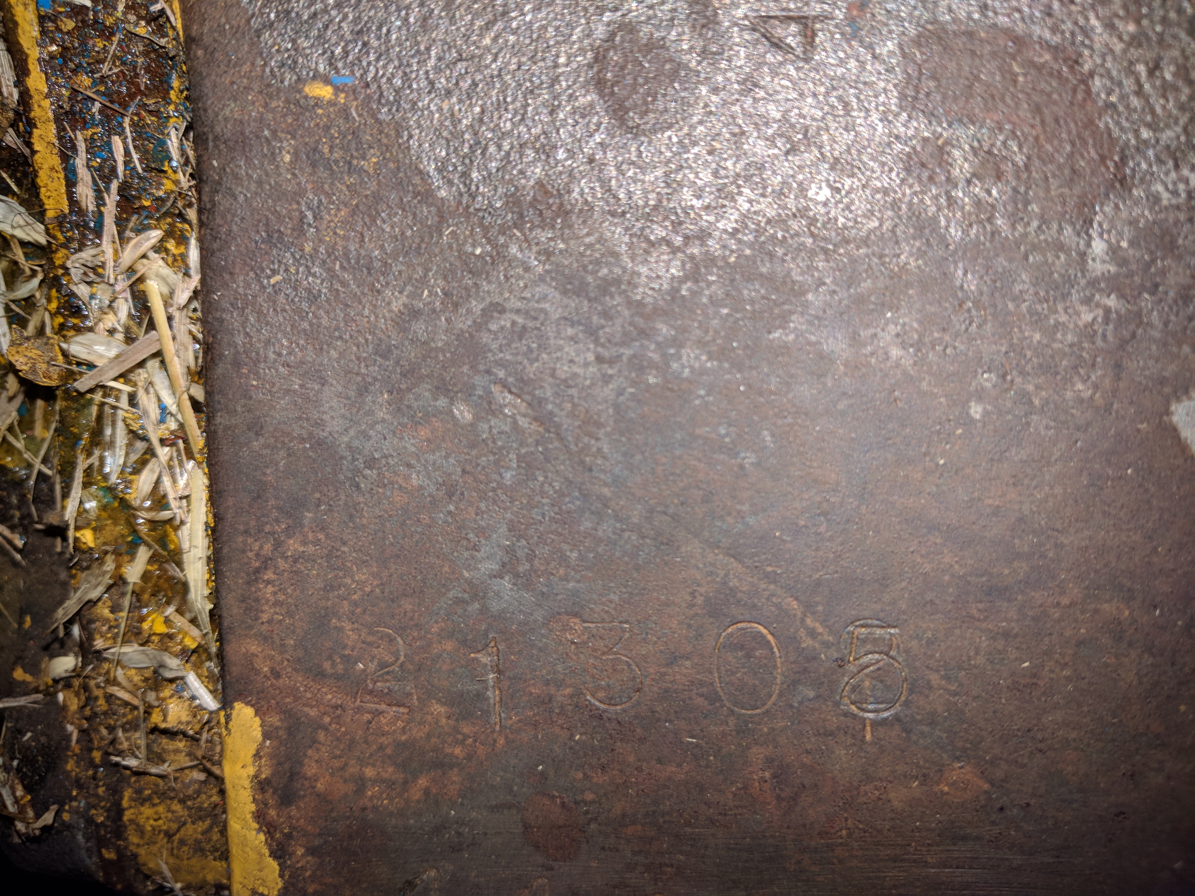

The most important picture (I think) is from the flat spot near the starter. What I have been able to determine, is that the is a "4" turned perpendicular to the other numbers. Then near the edge is a "4441" stamp. Directly above that appears to be "21305". However, the "5" seems to be stamped on top of a "2" and also the first "2" appears to be stamped over something that I can't make out.

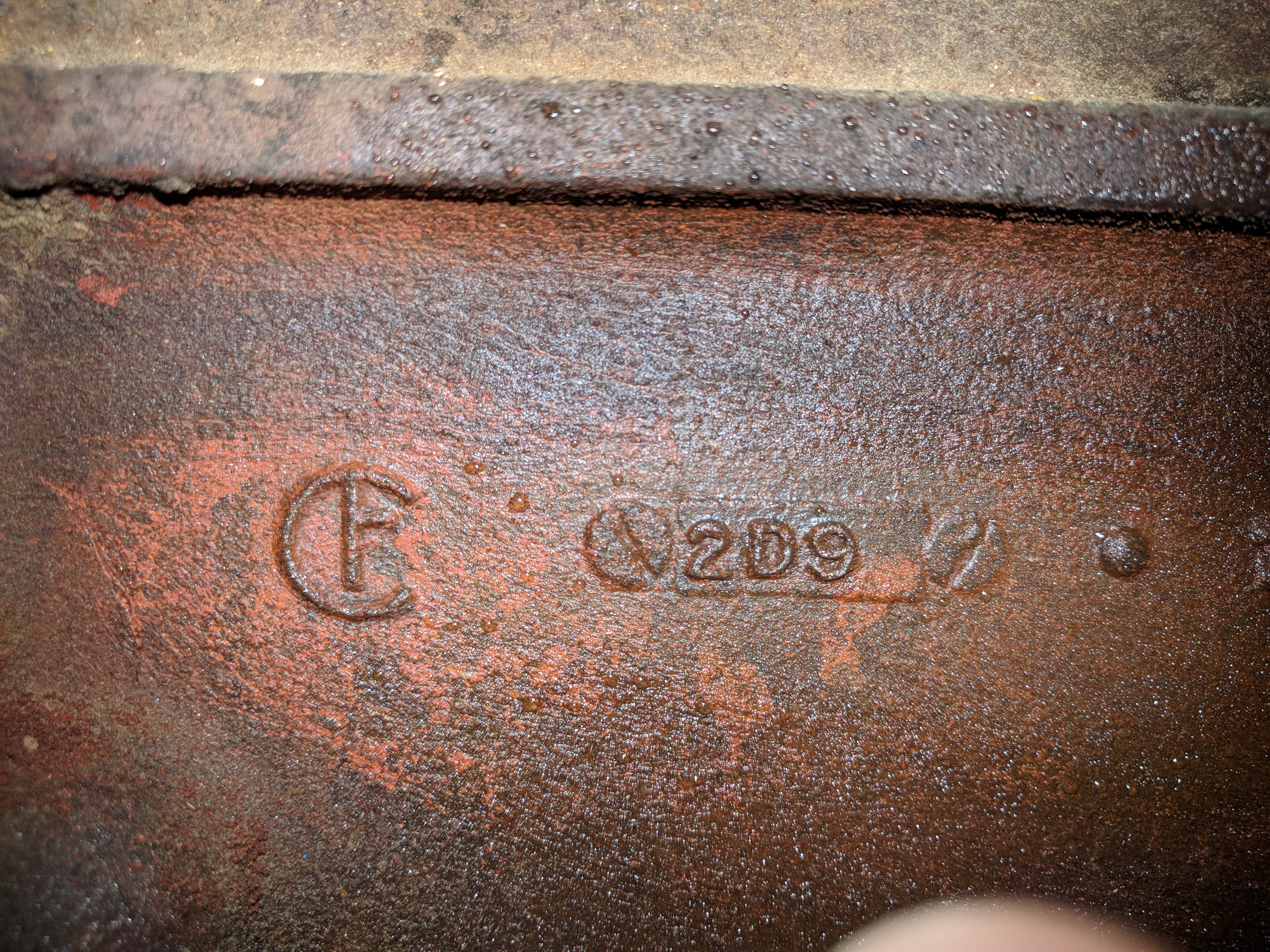

There is also what looks like an "F" inside of a "C" logo, followed by "2D9" on the engine.

There is one shifter lever mounted in front of the seat. I believe I have reverse and 3 forward speeds. It has 3-pt and PTO. The front axles are not adjustable. It is a gas engine. It has power steering.

You have a light industrial 2000 1962 with a 134 sleeveless engine. It's a 4 speed. look for the numbers on top of the tranny shifter cover. Looks like the rear might have been changed out to a late 801 or 4000 rear.

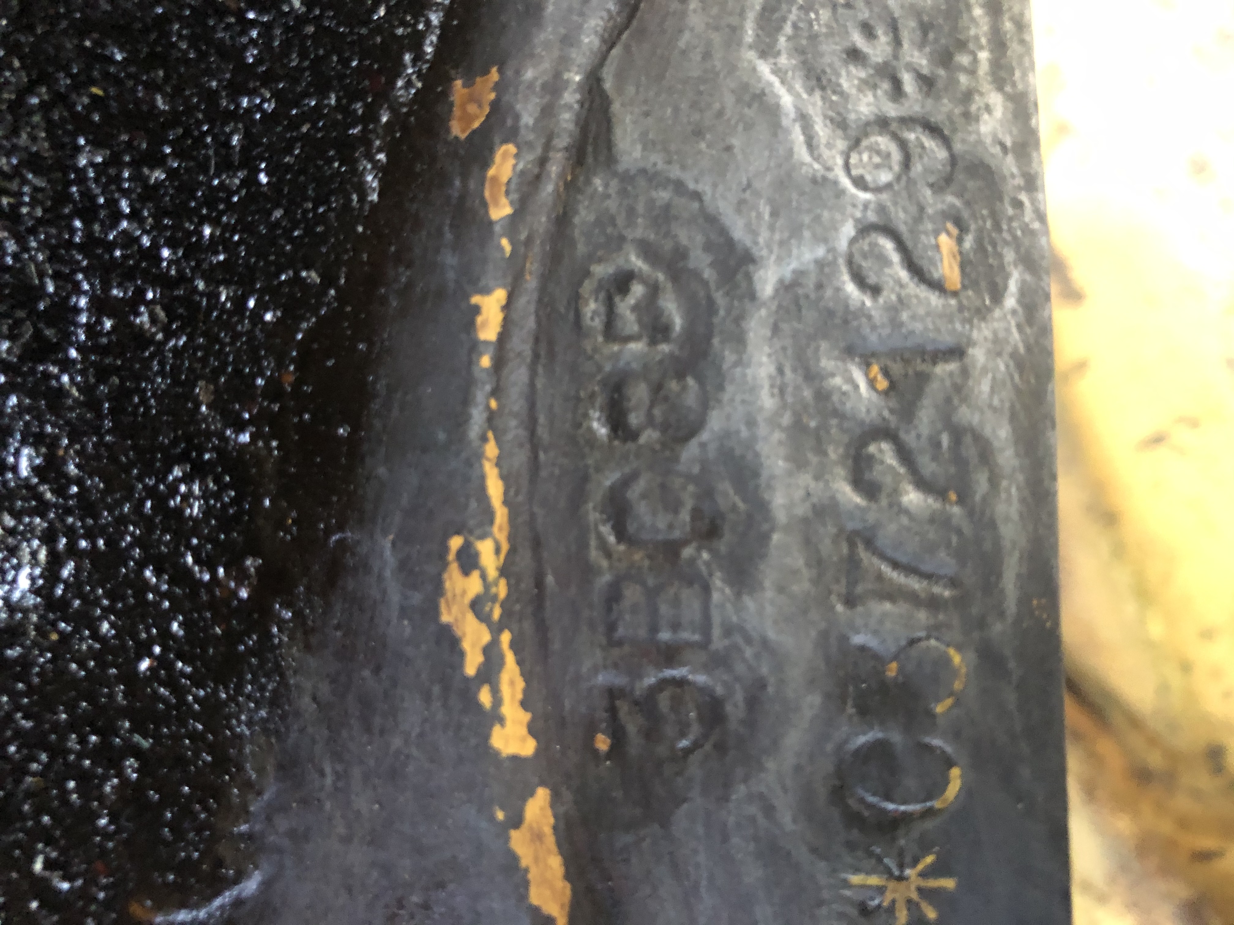

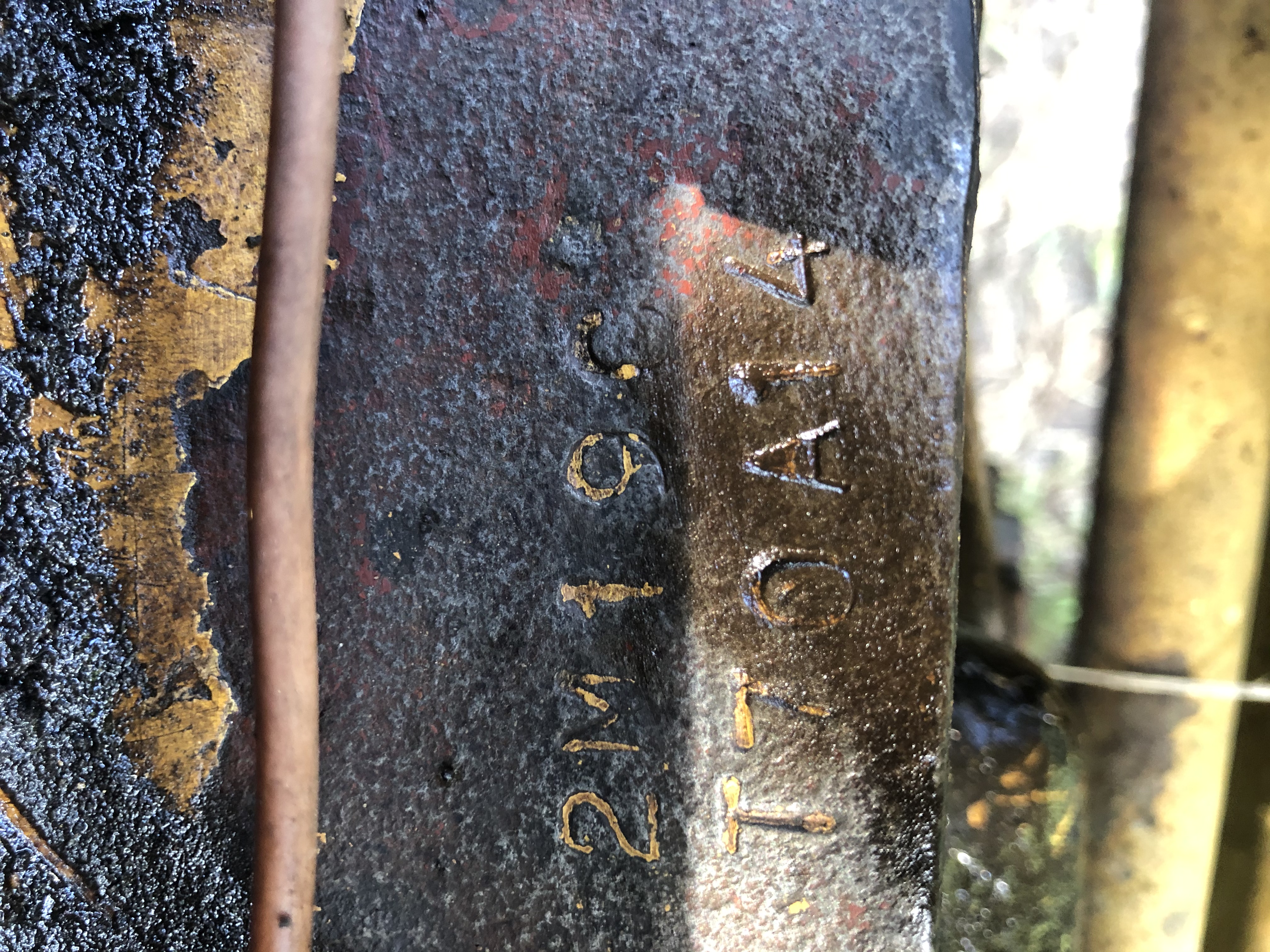

I too would like help identifying my recently bought old ford industrial tractor.
Here are the numbers that are legible: near the starter - 3BC85 - hard to see, may not be correct, below that number is *C372129*, on other side of engine is 2M19C, below that is T70A14. My research has resulted in much confusion.
