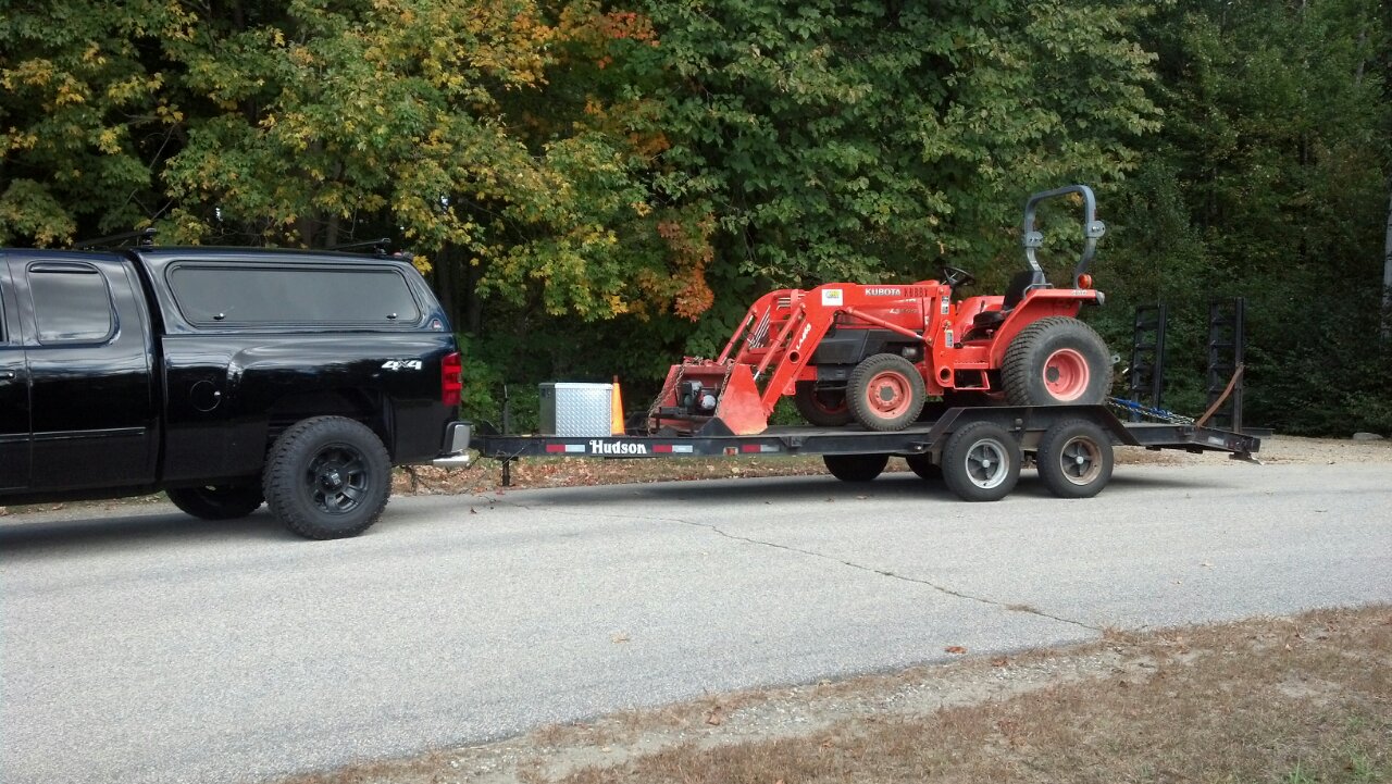

No way will that fit. I use a 16-ft trailer for my BX-25 and that's a nice fit. If I understand you right, I would stay away from those ramp gates for that size machine. Get the twin ramps that you can slide side to side. They are more heavy duty. In the pic, here's my neighbor's 18-ft trailer which he let me use one time before I had my own. He hauls his L-35 back hoe with it with no problem.

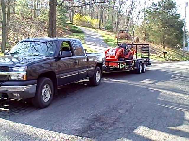

I moved a friends tractor... Not sure of the model but its a 30HP . This is on a 16 foot deck. (14 +2 beavertail) You might squeeze by with an 18' if you put the bucket on the forward rail...
Something to keep in mind... Its unlikely binder chains will fail, but if they do , or the binder fails and you stop short, having the bucket pinned down behind the rail will keep the tractor from F'ing up your truck . Most forces are generated when braking. janes tractor.jpg
