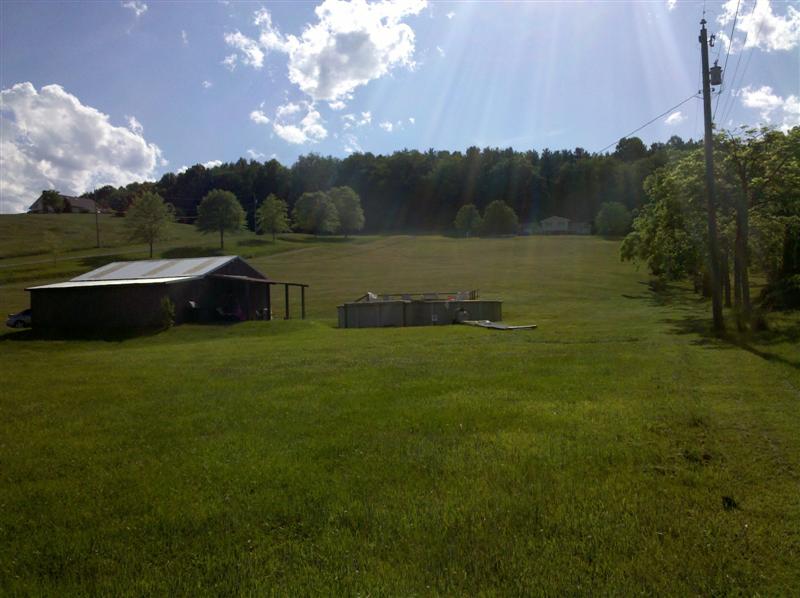

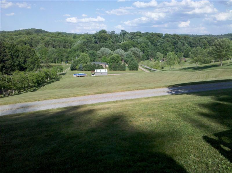

I've got 5 Acres much of it a grassy hill and a 1500ft drive that I've kept in check with a John Deere X500 a 54" deck and a 54" snow blade for the five years I've owned the place. My property lines are basically the tree lines in every picture.
It takes me about 3 hours to mow it with a fair cut but my back and everything else takes a beating. I'd like to reduce that. I can mow the hills well thanks to the locking differential on the X500, without it it would be a lost cause. I'm kicking around letting 3 or 4 acres go and getting a brush hog vs a finish mower.
I'm get by with snow removal as long as I start on the top of the hill with wheels and chains. But in heavier snow I just barely can manage. I can do some driveway maintenance with the steel blade but have no hydraulic down pressure so I've gotten some occasional driveway work done from a friend with a bobcat for washouts etc.
I think I'd like something to help keep the driveway pothole free, maybe a loader or blade with down pressure. Maybe some dirt work the field is pretty bumpy with the size tires on my x500 so box blade might be handy occasionally. I haven't ruled out doing something with the field if I had the right equipment maybe some larger scale gardening or fruit trees/berries.
I've attached pictures and am trying to keep this short. I'd be glad to answer questions. I've already learned tons from this site but wanted some input on what type of machine I should be budgeting for. I'm thinking 25hp CUT 4WD or a Ventrac type machine because of the hills. I'd likely be keeping the Deere because of a 60" gate to the backyard.

lawn mower vs larger size tractor, does help with beating. riding lawn mowers you get off and you feel your body still shaking. larger tractor no so. newer tractors have power steering, that helps out a lot.
bush hog = company name. a rotatory cutter = what ya talking about. (should help ya find the mower type better when searching to buy one)
if you go with a rotatory cutter, you will be wanting some sort of front weight. either make it suit case weights mounted to the front of the tractor or a FEL (front end loader) the front weight helps counter balance the bush hog. and helps to keep the front end from lifting up off the ground.
4WD / MFWD would help you out on the hills. you could prolly go with Turf tires vs R4's, and if you need some additional traction come winter. you could get some chains for rear tires. R1's would more likely tear your yard up and see little benefit form. vs going with turf or R4 tires.
it looks like you have some ditches along your drive way. but it would be advised trying to get the ditches in, so you can divert water away from your drive way. less water going across and on drive way. better the drive way will hold up long term.
length of drive way and amount of rock. i might suggest box blade, and a rear 3pt blade.
3pt blade is not that expensive. and can help with create ditches along with pulling rock off the sides of driveway back onto the drive. and will help with snow removal.
box blade can also help creating better ditches and smoothing things out. and filling in holes in road way.
25 HP, sounds good, if you can squeeze out a few more HP say 30HP. pulling the box blade and rear scrapper blade. can make you want those extra HP. so you can take a bigger bite out of stuff. and keep on going.
belly finishing mower, (mower fits below tractor and between front and back tires) i did not see a large shed, so you might see if dealer will offer a 3pt hitch rear finishing mower vs belly finishing mower. that way you are not having to pull the finishing mower out from under tractor, when ever you want to do something else. the belly finishing mowers can weight a good amount then fighting them constantly to put them on and take them off.... *ughs*

Believe that the long driveway is your main concern. If so, try to get some info on a York rake for smoothing out potholes. If you can spring the cash look for a quick attach feature on your front end loader to allow you to put a york rake, bucket or plow on easily. I hadf a 6 foot reat grader blade that I used for years plowing snow. problem was that if you make multiple passes the piled up snow will bog down the tractor when making the second/third pass. Hence. a front blade would make for a better clearing. Essential that you can easily change angle too. 4wd would probably be essential and make sure the tires are filled for weight/traction. As to HP. I have always used Tim the tool man's advice. Bigger is better. good luck
