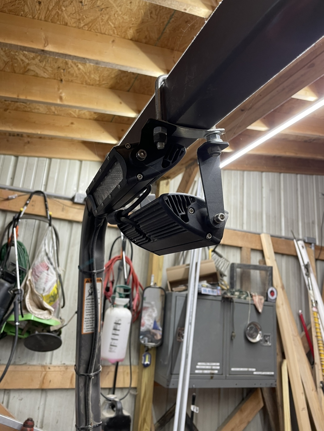

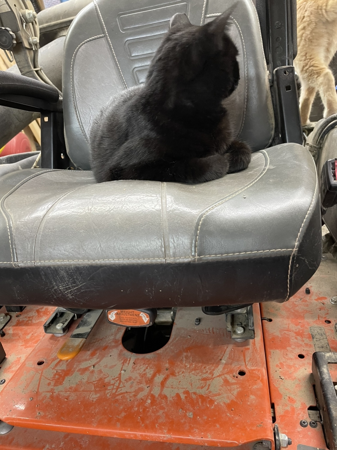

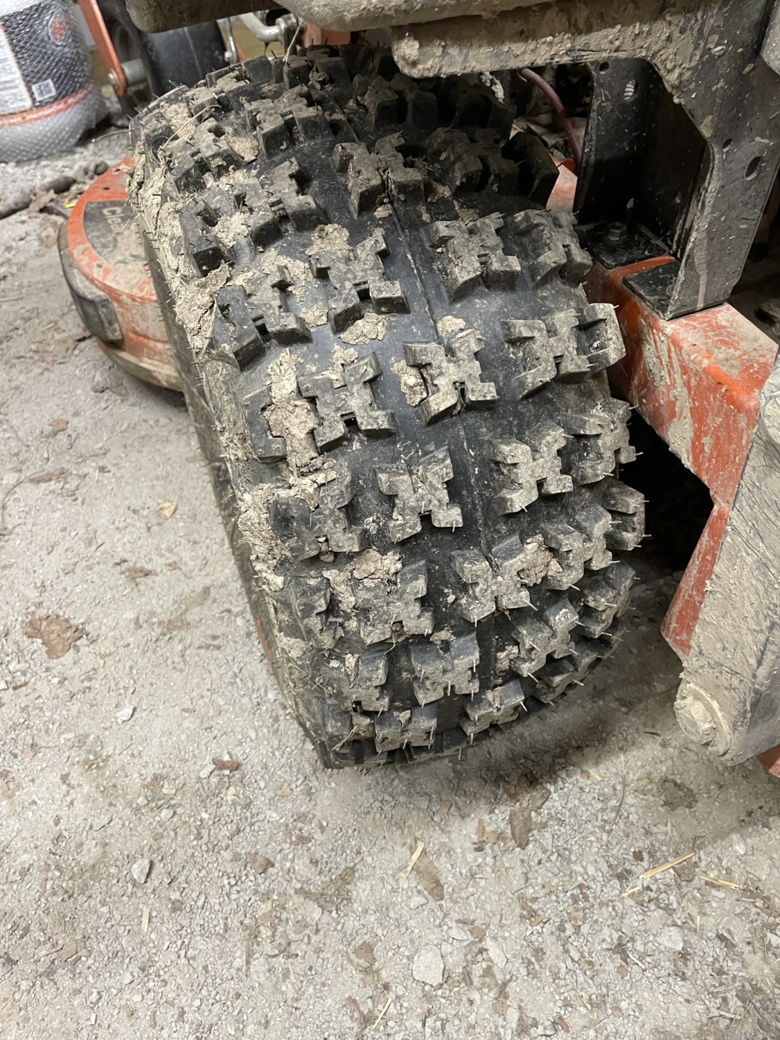

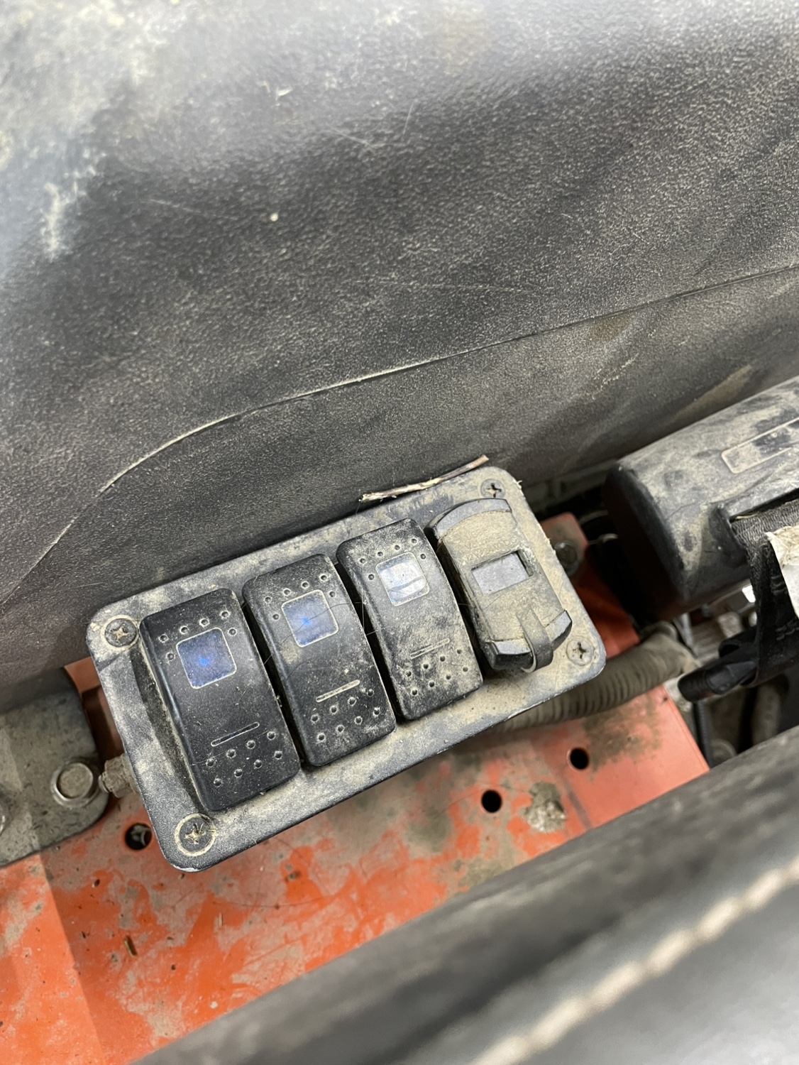

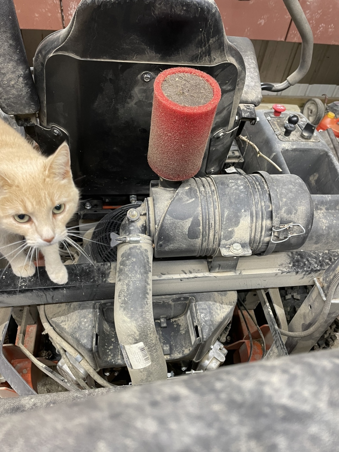

I took the money I saved and did some upgrades.
Vevor seat suspension
Bagger
Better tires
Air cleaner was free just had to make the mount and put a Uni in place of the cap.
Lights and switches.
Forgive the dirt and dust and the cats.
View attachment 3539659View attachment 3539660View attachment 3539661View attachment 3539662
