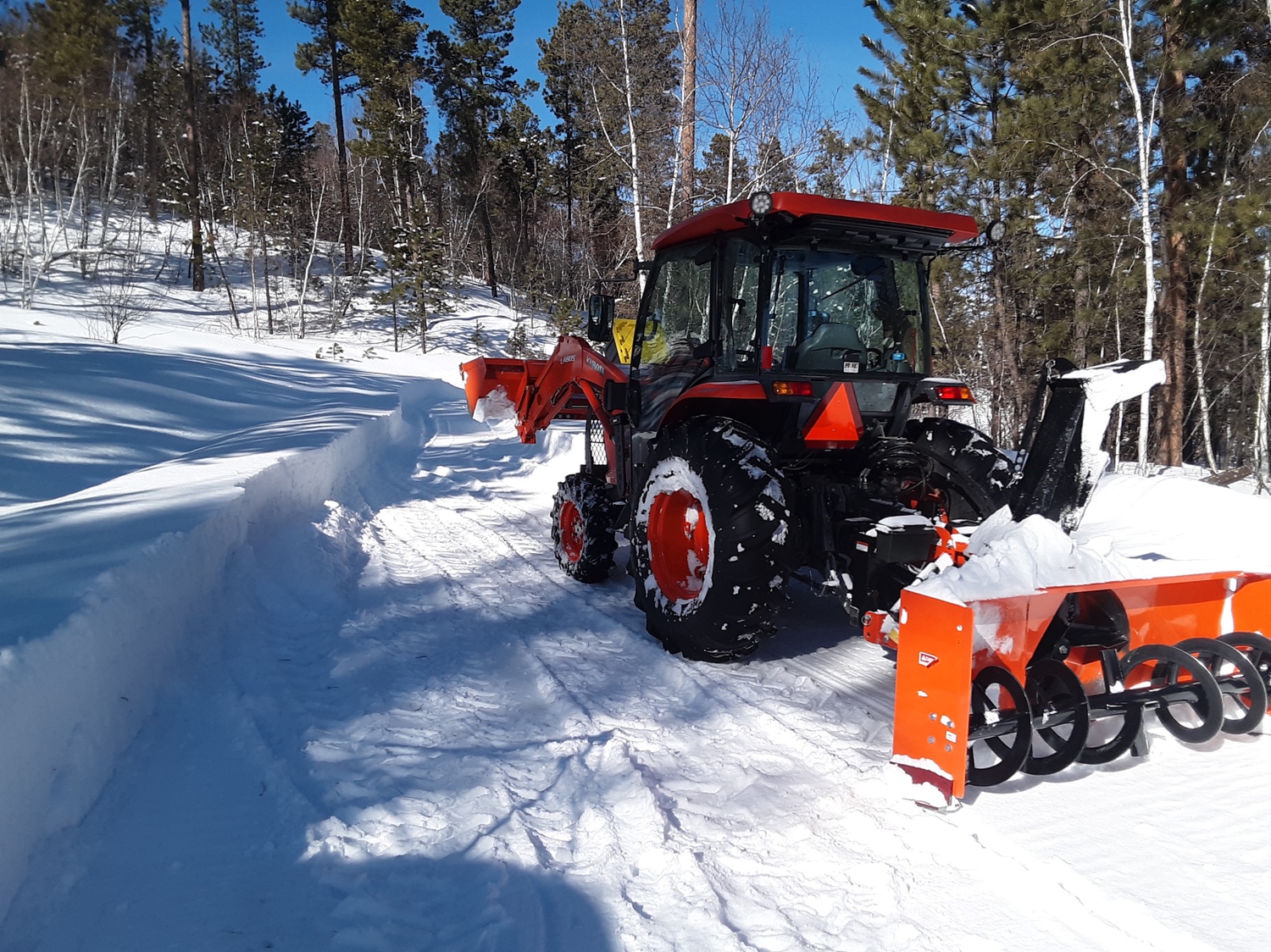

The L4060 suits my needs on my steep terrain running a 72” snowblower in snows up to 20”. This is at 5000 feet of elevation.

Do you have problems with the L4060 hydro stalling out or running out of power in the hills?
   / Help Me Choose What to Test Drive #47
Citydude,
It’s never stalled out but yes if I’m in medium gear and rabbit speed and have my foot in it all the way, it lugs down to where I have to put it in the turtle mode to go up a steep grade.
