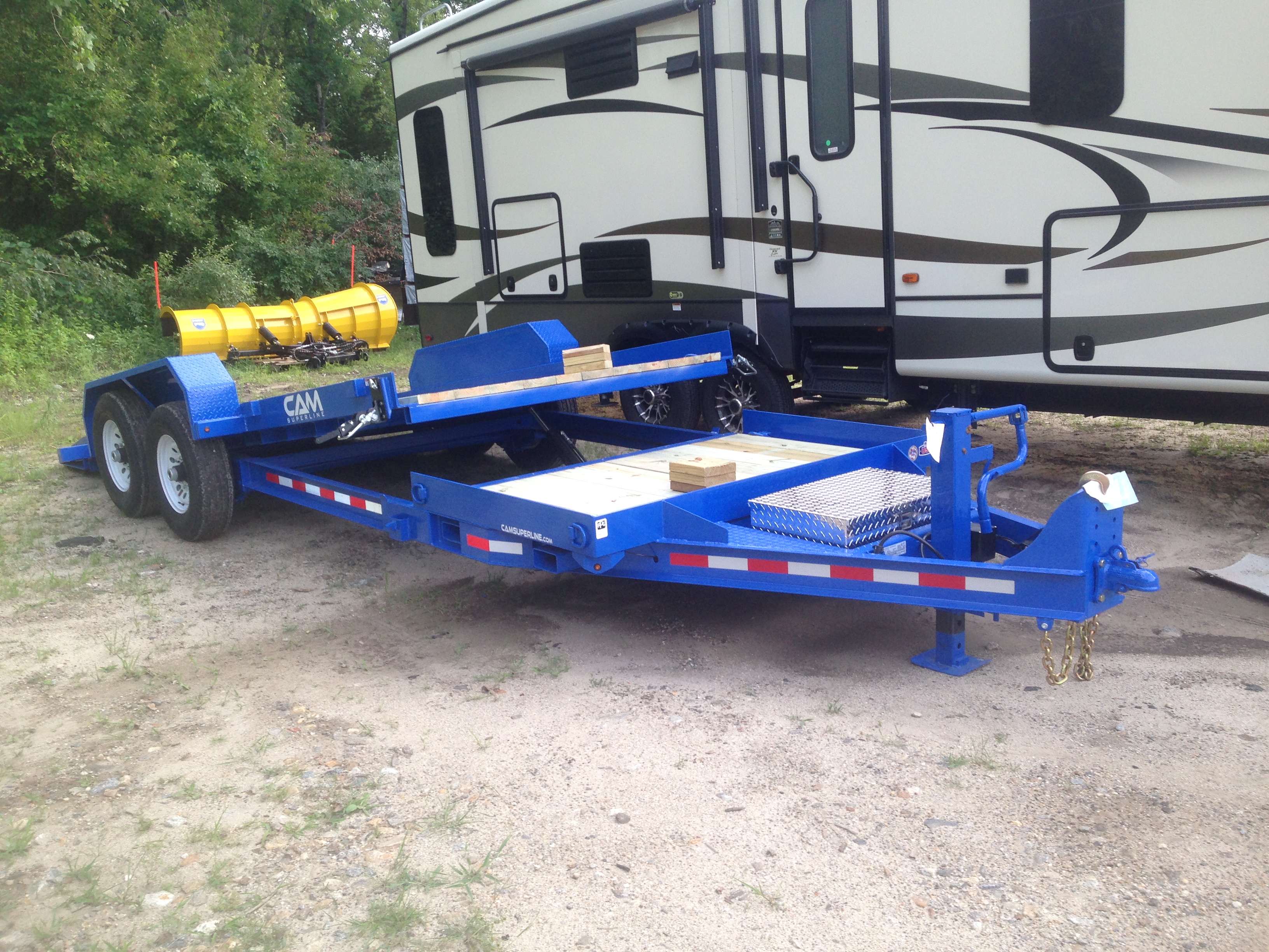

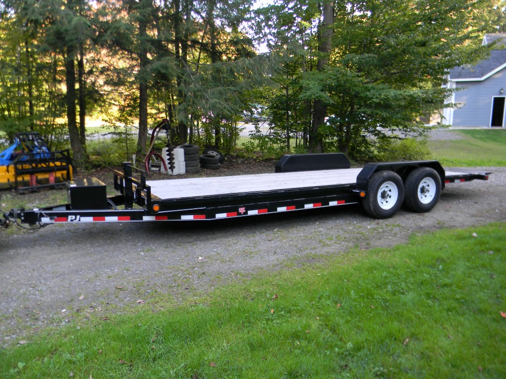

Congrats on the new trailer.
I have the PJ 22' TF model (Actual size 23'9" bed incl.tail) 14K full tilt but I know your not fond of PC trailers. 82" between the fenders.

Nice trailer . Where do they hinge the bed ? Curious .
