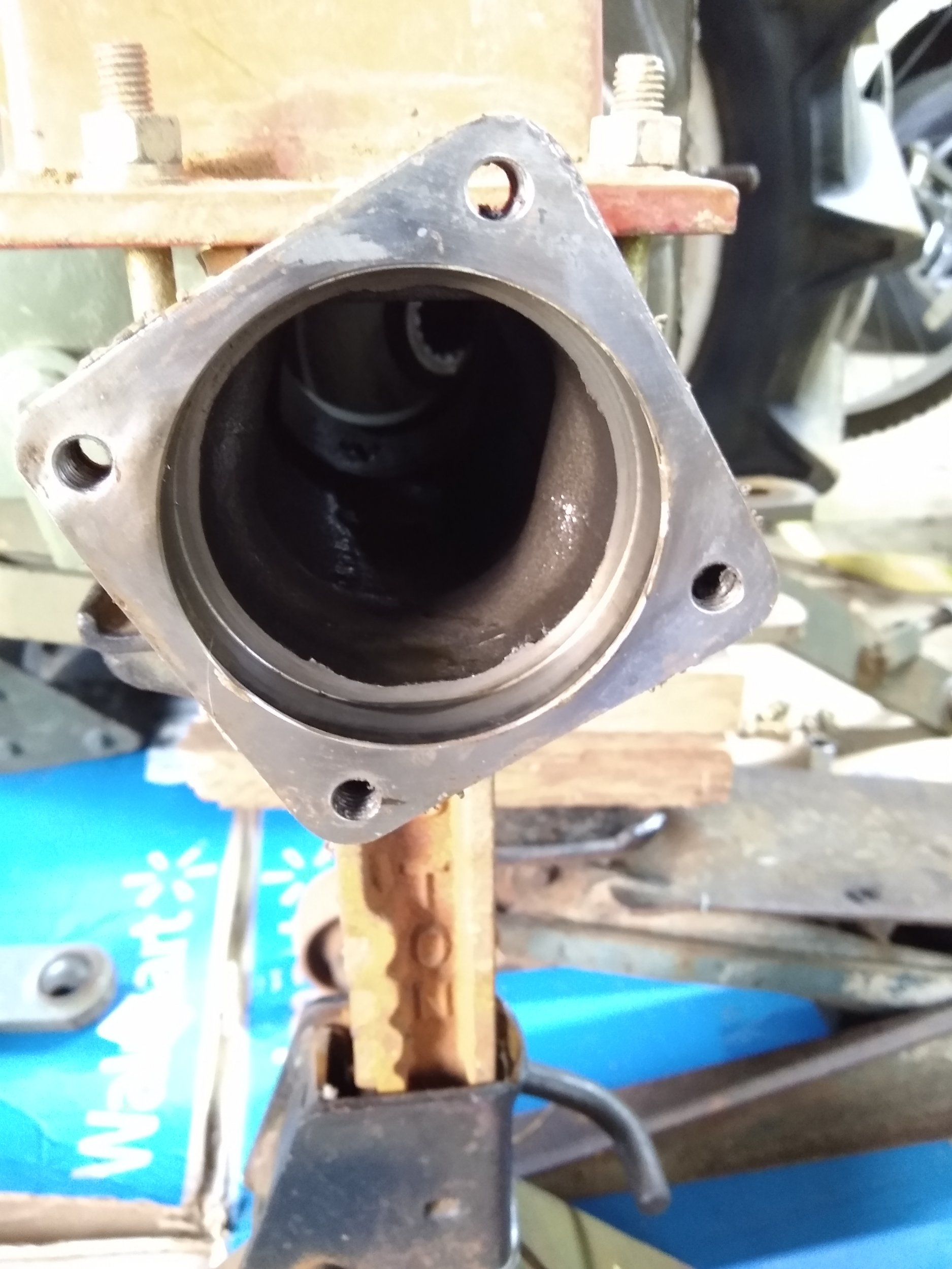

I would replace both bearings, and with non-Chinese bearings, if you can get them. Personally, I only put cheap bearings in light load, low use, easy to service uses.
If you have a real groove cut, you may want to sand out the groove as a few imperfections can trash a seal pretty quickly. You could try to find an oversized seal. (I have never had much luck trying to do that, but it might be a lucky size.) If it is really bad, a good machinist could spray weld new metal on and get it back to size.
All the best,
Peter
The wear collar get replaced with the seal. You can see it laying above the dead blow and below the snap ring pliers in the pic. Its about 2"s in diameter and provides the seal a sacrificial surface to ride on.

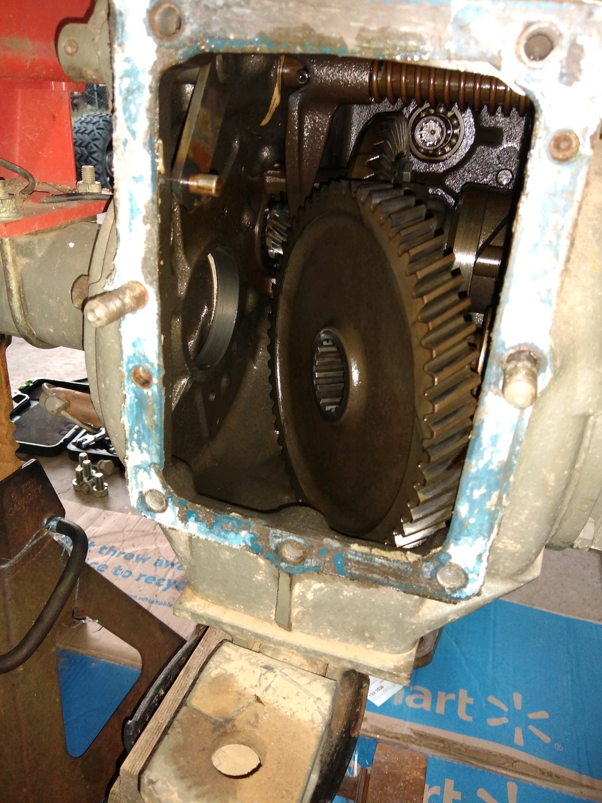

Here are a few more pics for those who want to see more details and for those who like to see how this stuff comes apart.
   / Help me identify this noise. #38
Does the inner bearing slide out still attached to the axle, or do you need to drive it out toward the bull gear using a pipe etc?
#39
No it Just pulls out of the housing by hand. Its a slip fit, not press. Pull the shaft out, to let that bull gear clear the diff lock on that side. Bull gear let drop down and angled out from under the fork. I set it over to the side and you just pull the bearing out. Comes out to the inside of the trans housing. You can see it's machined surface .

No it Just pulls out of the housing by hand. Its a slip fit, not press. Pull able out to let that bull gear clear the diff lock on that side. Bull gear let drop down and angled out from under the fork. I set it over to the side and you just pull the bearing out. Comes out to the inside of the trans housing. You can see it's machined surface .
