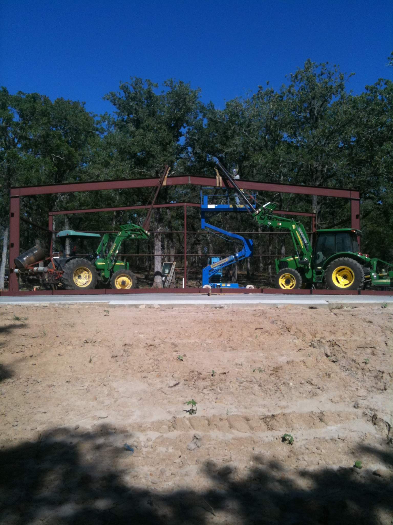

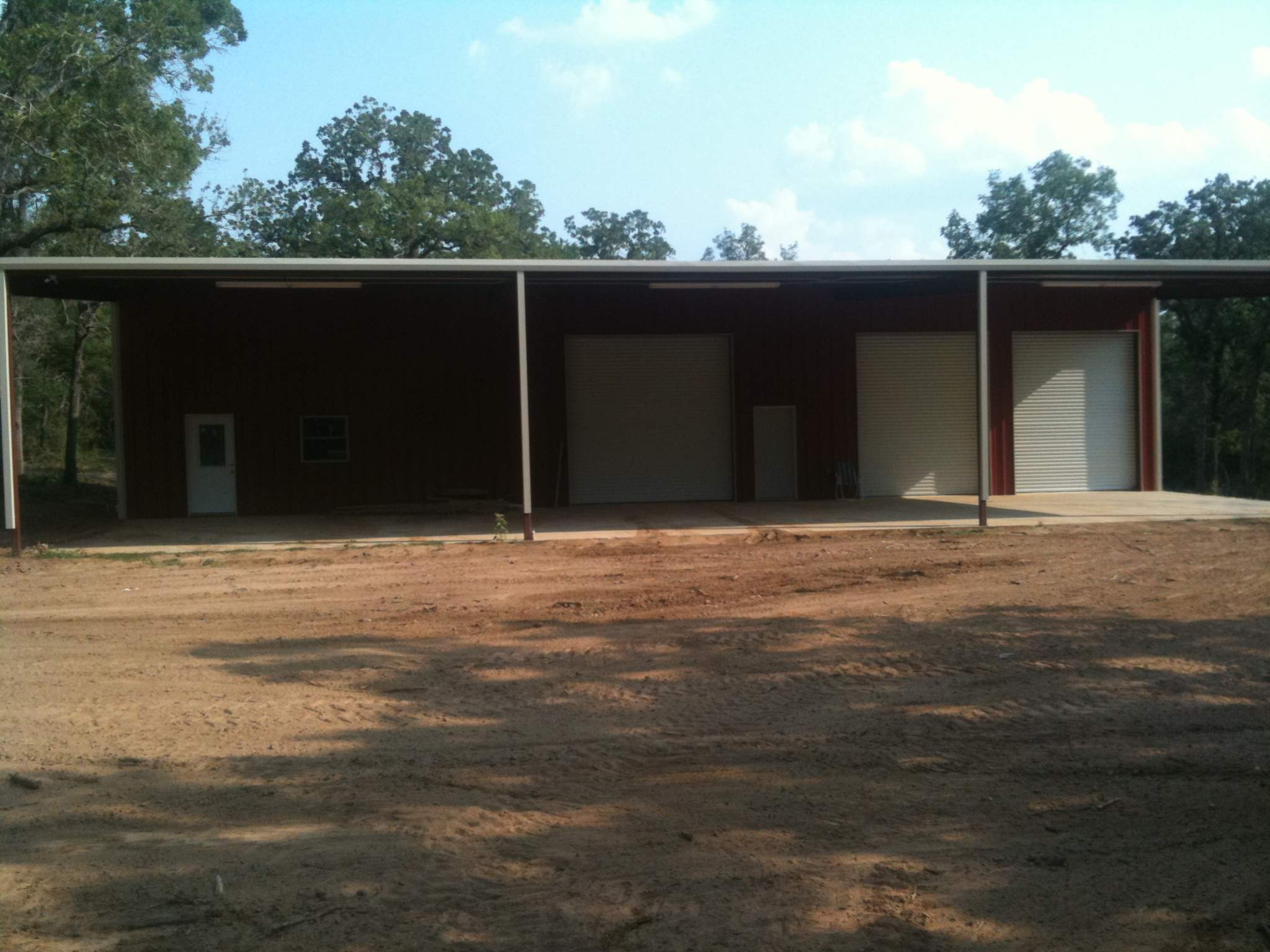

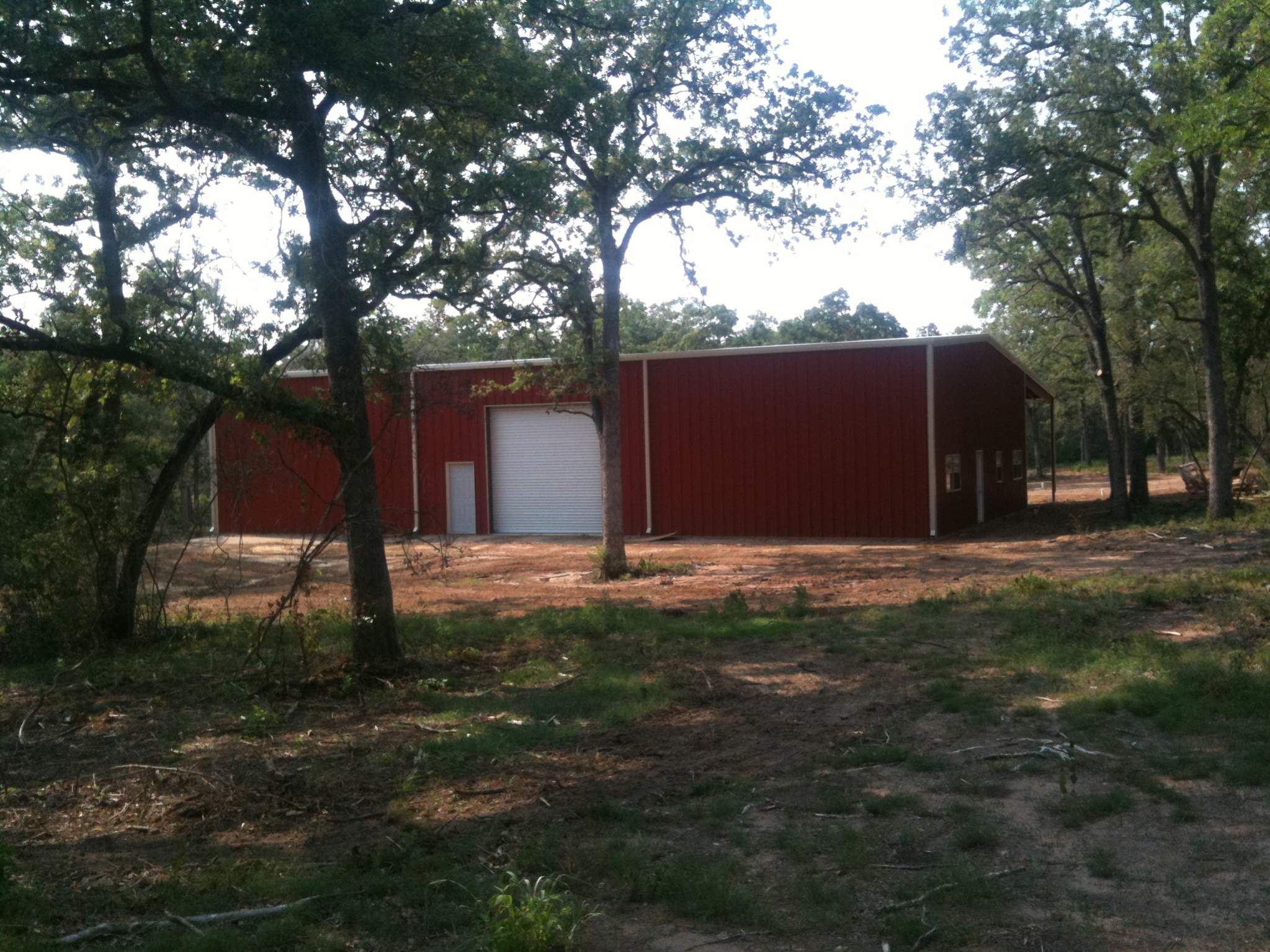

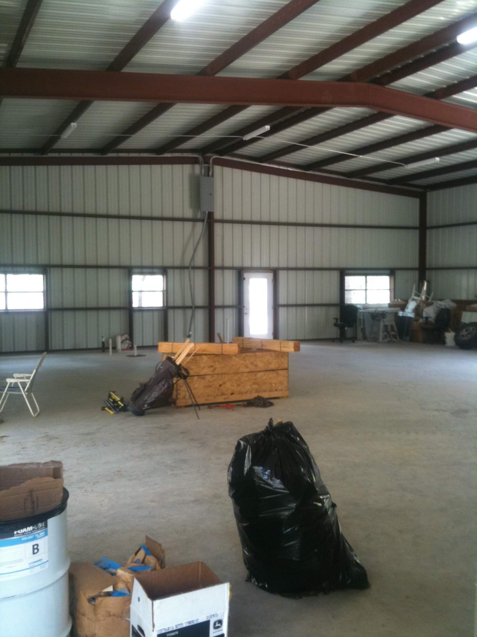

Where you are building has a lot to do with what the final cost will be. The other variable that can be quite pricey is site prep and pad. I just finished a 50x75x16 with 25x75 lean to and 3-12x12, 2-10x12, and 3-walk through doors. The slab is 5" with #4 rebar on 16" centers. The building with labor was 40k as a weld up. That included building, windows, doors and gutters. The slab cost 21k for everything, or a little over $3.00/sf. Electrical in rigid conduit ran 8k. I don't know what the pad actually cost since I excavated the 800cy of select fill from my pond site and put it in myself.

That's a nice building AGGIE. Like that overhang on the front!
It's a work in progress. Still need to put in the drain line in front of the lean to to catch the downspouts and then lots of gravel. Inside we are starting work benches, the 20x50 office build out, and insulation. It only takes money and a lot of it. I thought it was overkill in size, but we have already filled it up.
