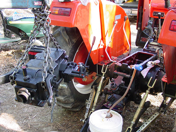

#60
Hello All!
Sorry I have not let everyone know how things are going. Last week I got her all back together and have been getting in some much needed seat time this week. It’s pouring the rain the morning and I am babysitting, so, trying to get caught up here.
Got it all back together and only had two parts left over – the parts are 2 of the 4 bolts that hold the seat on the top of the reservoir; hard to get to and the two that are on there now should be good enough – will get back on soon enough.
Can’t stress enough, as was previously posted, get an engine hoist if this work has to be done. I should have listened. Was alright getting it off, but, putting it back on and protecting the gasket and sealer an engine hoist is a necessity.
This picture is the reservoir on the hoist and I am draining the tranny.
