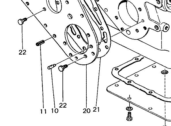

Yes i have taken off the oil line to the pressure gauge and it has flow, but not much pressure at all.

#15
Found the problem. As i tore my engine down, i found a very small part in the bottom of the crankase. Couldnt find any other problems with my oil system. Then i saw it on a parts picture page. The part was called a connector-oil,lube. It fits in the oil passage leading to the front main bearing, and its purpose is to lube the front timing gears. It had fallen out and all my oil was flowing there. Iam trying to include a picture just so someone else wont have to go thru what i have... Thanks to all for the advice......

#16
P.S. Look at the part labeled #10 in the picture......
