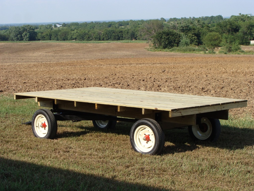

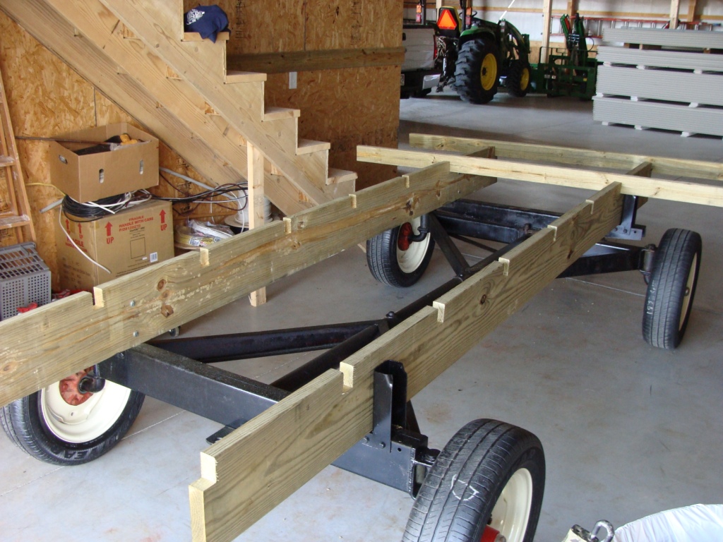

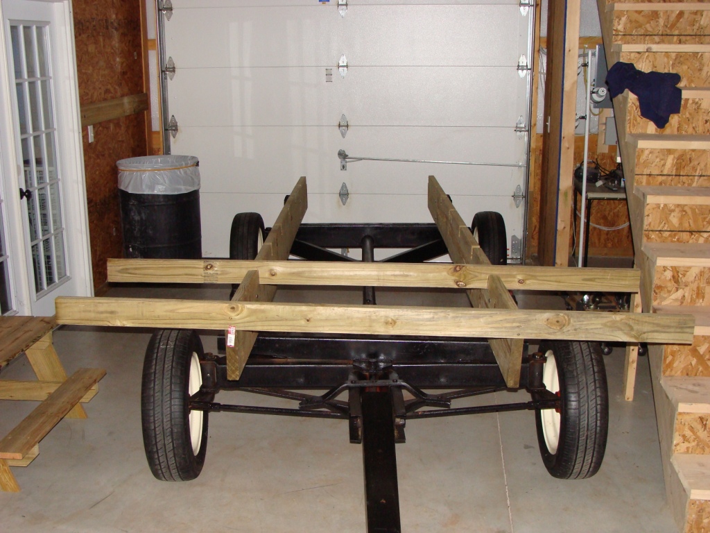

here is mine

Yes I used 2x10 hemlock planks for across, they warp a little but I cut them myself and they are tough as nails and last a long time. I stopped the decking about 1 foot from the back and bolted 2 4' vertical 2x6 (1 on each side) to each runner. I then fastened a few decking boards across them to stack the rear pile against, It is not nessisary but it helps lock the load and I gain a few bales by not staggering the back. We have been using rough hemlock for wagon and trailer decking for several generations, it is cheap, tough and lasts a long time, the draw back is it warps when dry, but as long as you fasten it while its green it is OK.
