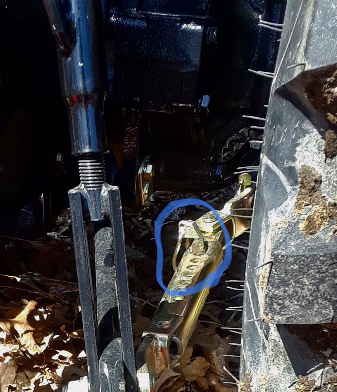

Curious too if the other side was the same way? Or if the cutter was just shifted all the way right for some reason?

Please excuse my ignorance but what is a "tail wheel" ? Also the stabilizer bar has several holes in it and the pin is in the hole closest to the tractor.
   / Help removing a King Kutter rotary cutter #23
Tail wheel = the rear wheel on your rotary cutter
Yes, you are correct, the pin is in the hole for the widest position, but at the end of the arm, where it attaches to the axle of the tractor, there may (or may not) be an optional hole so you can shorten the arm. If you can shorten the arm there, you can utilize the other adjustable stabilizer arm positions and make it easier to get the bush hog off

How big is the cutter? It might have a CAT 2 3 point (wider width at the mount) with CAT 1 pins on it. My XG3025 has at least 6 inches of side to side adjustability (4+ inches of travel on the stabilizers) . I would move the pins on the mower to face inboard.

From the pic, you didn’t take the stabilizer bar pin out.
   / Help removing a King Kutter rotary cutter #26
You’re talking about this right?

Thanks everyone for your input. I put my hay spear on did what I had to with it and put the 5 foot cutter back on. It was a chore but I had it on and leveled in about 30 minutes. Thanks again, Don
   / Help removing a King Kutter rotary cutter #30
So that means you figured out how to pull the stabilizer pins on BOTH sides to make the lower links as wide as possible?
