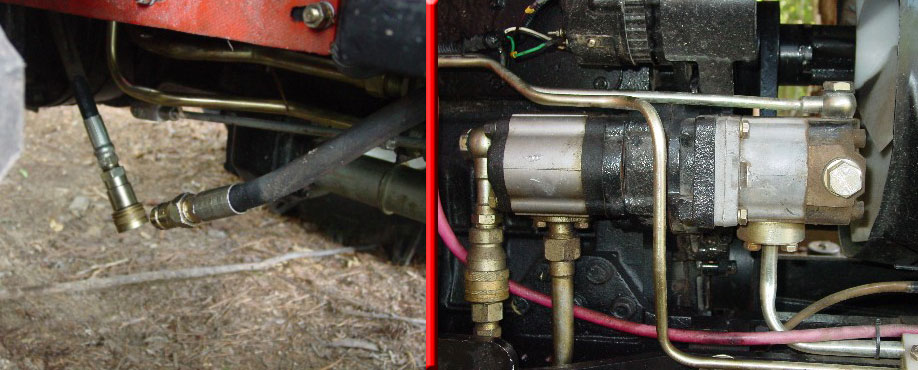

Here are some pictures and the process I used to replace the hydraulic pump on my Jinma 454LE after a coupling was disconnected moving some brush. Please see this link, cheap insurance, for a very inexpensive way to help prevent this from happening to you. The sad part is that I had seen this and had purchased wire ties, was just waiting for time to perform this task.
Well, I have the time now….

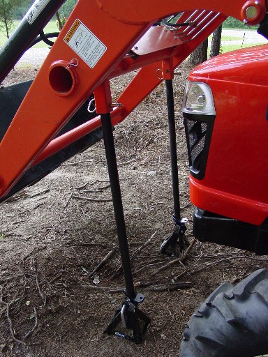

The first thing I needed to do was get the pressure relieved out of the hydraulic system. This was necessary so that I could safely unhook the pump and get the coupling joined back together that caused all of this mess.
I used the stands that came with the Koyker loader to prop up the FEL. I did not want to lower the FEL any lower so that I could have good access to the pump. So, I used jack stands under the FEL stands to hold the bucket up.
Once secured, I put the FEL joystick in the “float” position. I went back and forth between the “neutral”, “lower”, “raise” and “float” positions several times ensuring the FEL was lowered as much as possible. Once the FEL looked to be lowered firmly on the stands, I left the control in float and pushed down on the bucket and tried to shake loose off the stands. The stands held. I then put the 3PH in float and went to the back of the tractor and pushed the 3PH all the way to the ground.

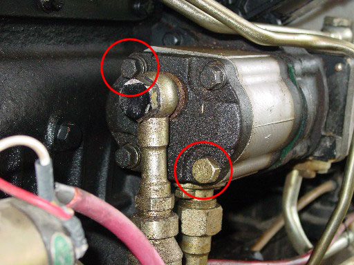

To verify some of the pressure had been taken off the system I tried reconnecting the coupling that was the source of my problem. Previously I had been unable to reconnect the coupling. After the FEL had been propped and the pressure relieved, I was able to snap the coupling back together without any issues. I then disconnected so that I could refill the reservoir without having it run out the loosened hoses at the pump.
With the pressure relieved I set out to remove the pump – see attached diagram. I started with the pressure, or work side, connections on the pump. The bolt that connects the hose to the pump is actually hollowed out through the length with a hole through the diameter near the bolt head.
I carefully loosened the bolt wearing gloves and protective goggles in case pressure was still in the system. There was not any pressure and the connector bolt came right out. I then tried to loosen the flange connector on the bottom of the pump but could not get a wrench or socket to the bolt heads. So, I loosened the connector nut for the pressure/system hose. Be CAREFUL when removing the hose connector from the flange as there is a small o-ring.

With the hoses removed I was now ready to remove the pump. The pump is held on by the two bolts circled in the attached picture. With the bolts removed I tried to pull the pump loose, but, it would not budge. I tried a few knocks with a rubber mallet but this did not do any good. I pulled and tugged but the pump would not budge. I noticed there looked to be a brass gasket, had turned green, between the pump and the mount. I tried gently wedging the pump off behind the gasket with a screwdriver but to no avail.
