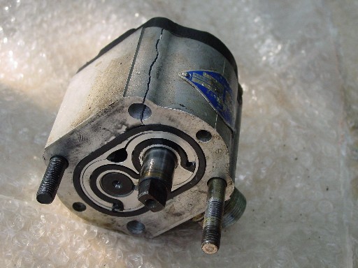

I ended up removing the other two screws and taking the pump housing off. With the housing removed it was very clear to see what had happened. As someone said earlier, all that pressure has to go somewhere…
With the pump housing removed, this left the cast end piece, stuck, to the mount. I took the two bolts that were used to hold on the pump and screwed them in the near side of the pump end cover. I them took a couple of box end wrenches and slipped over the bolts and placing the box end up near the bolt heads to get a little leverage. With gloves on to protect fingers, I pushed down on the wrenches to get some leverage to hopefully pop the pump end off. It took just a little bit of pressure and the stuck pump cover just popped right off. (Sorry I do not have pictures, but I was concerned at this point and really trying to come up with a fix.).

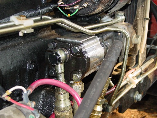

With the old pump completely removed, I prepped the new pump to be installed. I was now able to remove the flange connector from the bottom of the old pump and install on the new one. Be careful when removing and installing the flange as there is a small O-ring that’s a devil to find if it pops out and falls on the ground – don’t ask me how I know this….
I put a little hydraulic fluid in the cavity of the new pump. I then took pliers and turned the shaft to get the fluid circulated. I then mounted the pump to the bracket. There is a small collar in the mount bracket attached to the drive shaft in which the hydraulic pump shaft has to insert . It took some effort, but once lined up, the pump just slid right on. I put some light-weight oil on the pump cover that joins to the mount to hopefully avoid the stuck cover should I have to remove later. But, I really doubt it did any good.
With the new pump installed I was ready to reconnect the hoses.

I reconnected the supply side first and filled the hydraulic reservoir. I then attached the coupling under the floor board to see if fluid would be gravity fed into the pump. After a few minutes I saw just a tiny bit of fluid coming out of the pressure side of the pump. I ran the hose bolt through the hose connector and tightened onto the pump.
I was unsure of how much to tighten the bolts, so, using the SWAG method, I tightened to what I remembered as being the approximate tightness before I removed the bolts (before removing, I try to tighten just a little to get a feel for the pressure needed to tighten the bolt). The bolts were on really tight, so, I tightened them down with quite a bit of pressure.
