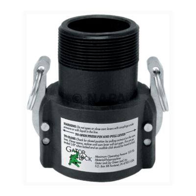

The return needs to have NO restriction (if it did, it would slow the drop), I think the only place to plumb it is the transmission fills. Both the Kubota and Kioti had them on the back which were 1" or 1-1/4" NPT, so I went to a local farm store and used the black quick connects to connect it, they look like this:
My L4400 has a 1-1/4NPT fill cap. I've never seen a coupler like the one in your image. I'll need to go take a look for one.
