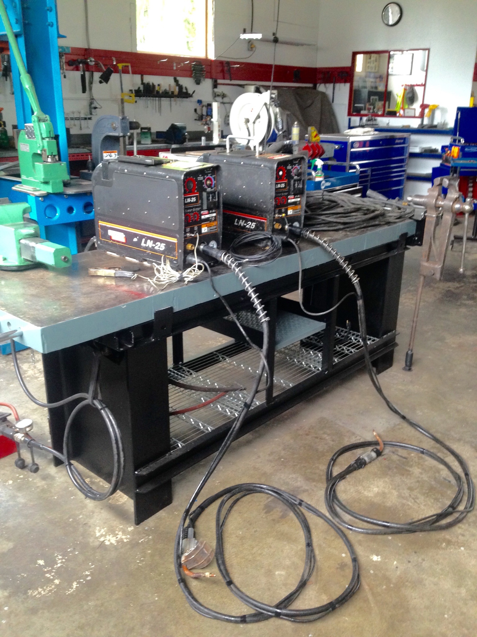

Look for a used Lincoln LN-25 to run with your Trailblazer.
   / Help Setting Up A MIG Welder, or Selecting A New One,,, #3
If you want portability for mig (or fluxcore) get a suitcase welder for your Trailblazer. I like my Lincoln LN 25.
If you intend to only mig in your shop, then a MM252 would be nice.
Edit: Shield Arc beat me to it
LN 25’s are so rugged even older used ones are usually in good working order. ( compared to the Miller equivalent. )
I purchased these TWO with fluxcore guns for $800 Cdn. and they worked perfectly.

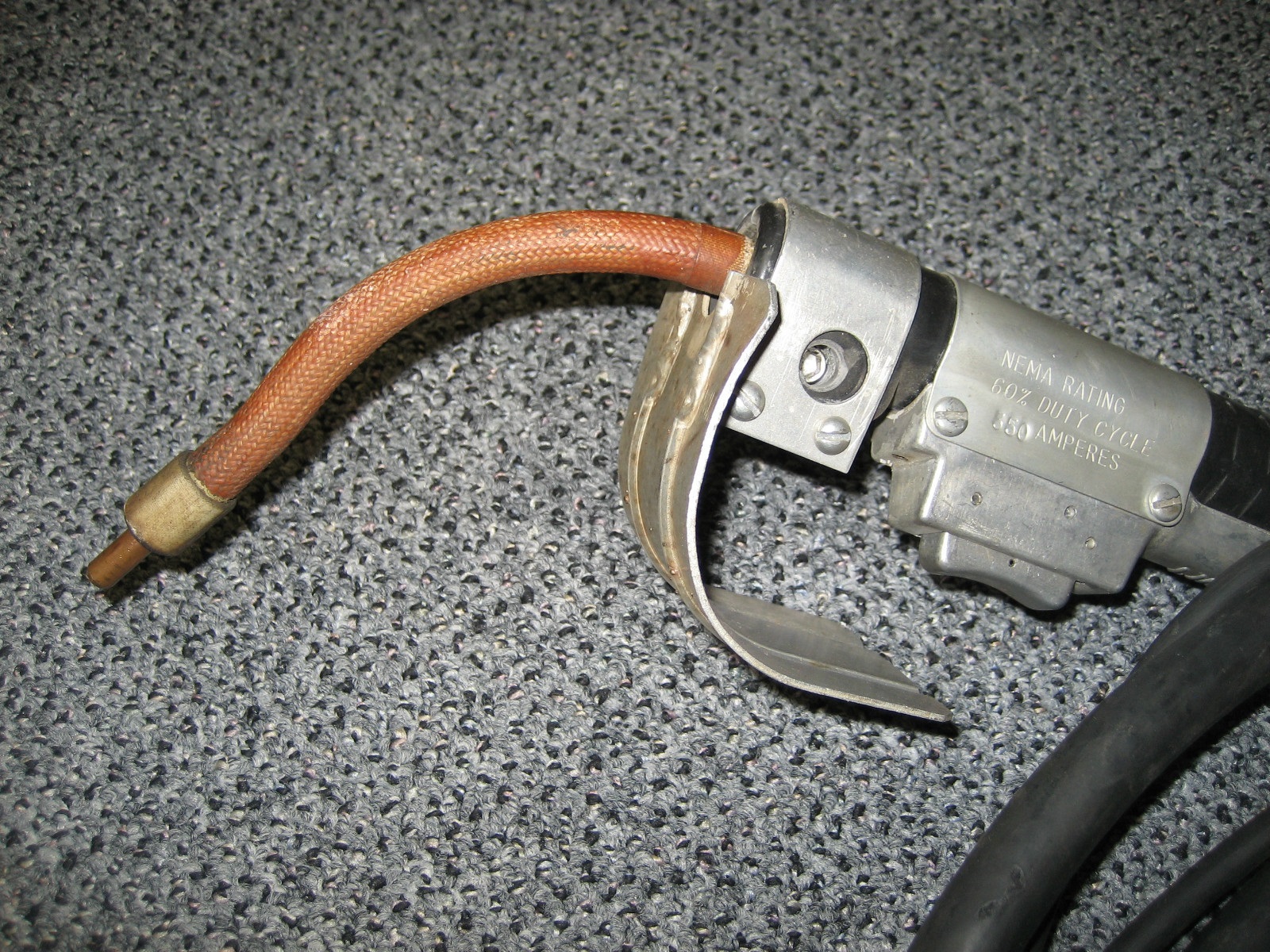

Is anyone using self shielded flux core with their LN-25? Which gun did you use? I have a LN25 that's set up for hard wire, gas shielded.. I'm thinking about trying flux core, but it has the older magnum 400 gun that I don't believe works well with self shielded flux core, maybe I'm wrong.
   / Help Setting Up A MIG Welder, or Selecting A New One,,, #8
We always used the Lincoln K-126 self shielded flux core guns.
