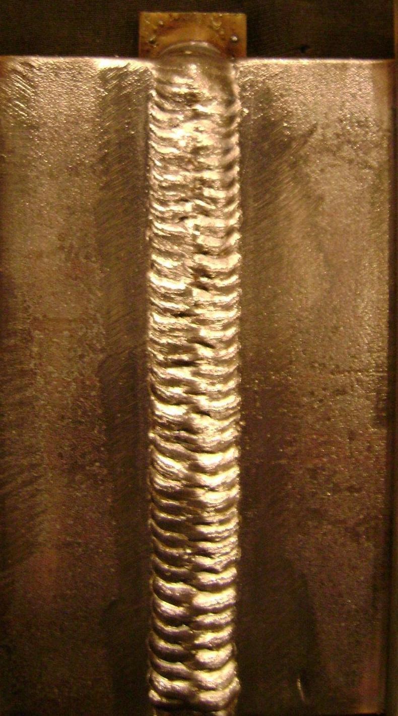

CADplans I use to own a Trailblazer 55D. 450-amp diesel drive. I've never run the new Trailblazers, or a Millermatic 252. But I have read several times that people who own them just love them!
I run a lot of Mig in my LN-25s, to me they work just like a dedicated Mig welder. Here is a vertical up Mig weld with my LN-25.

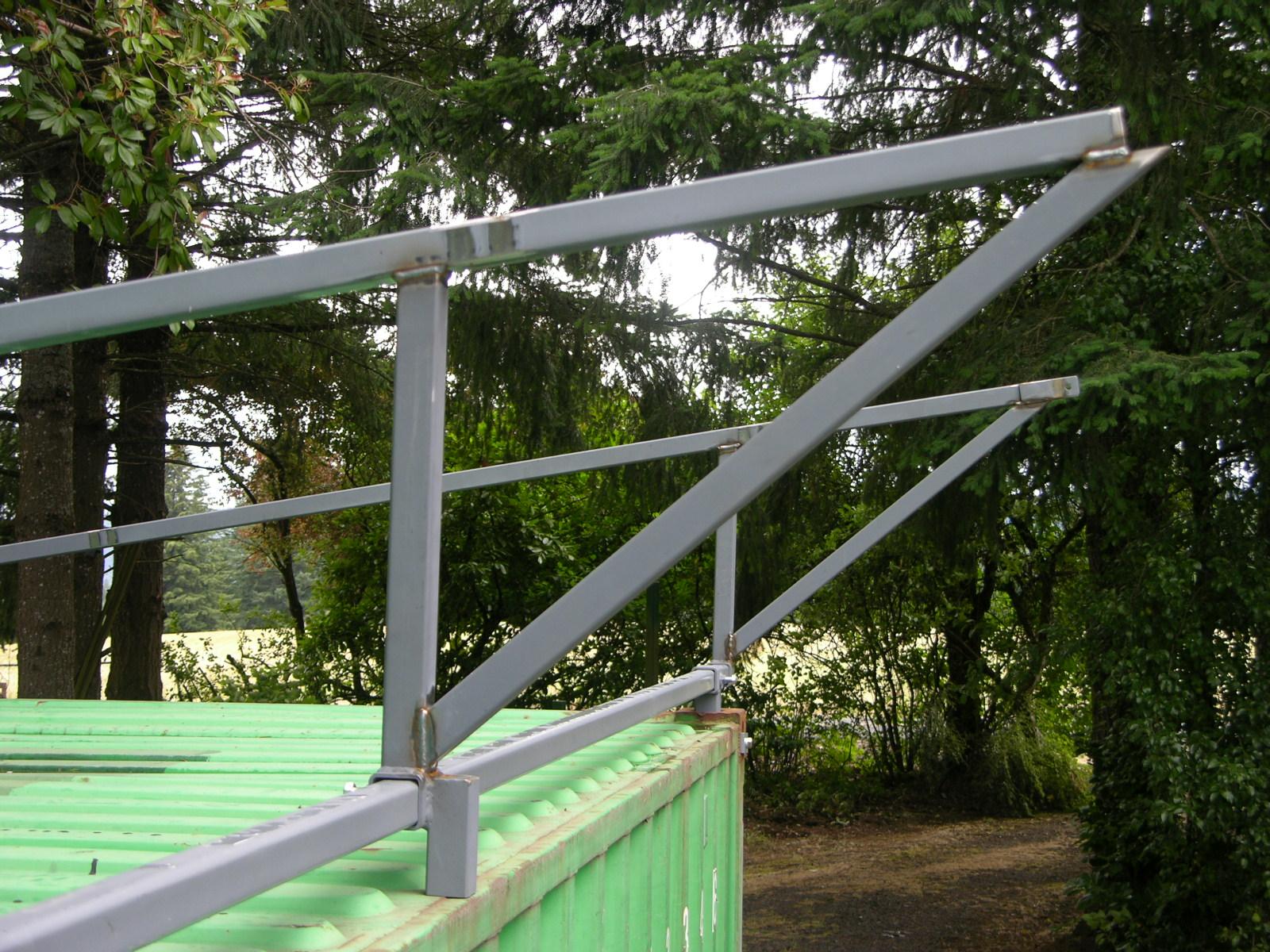

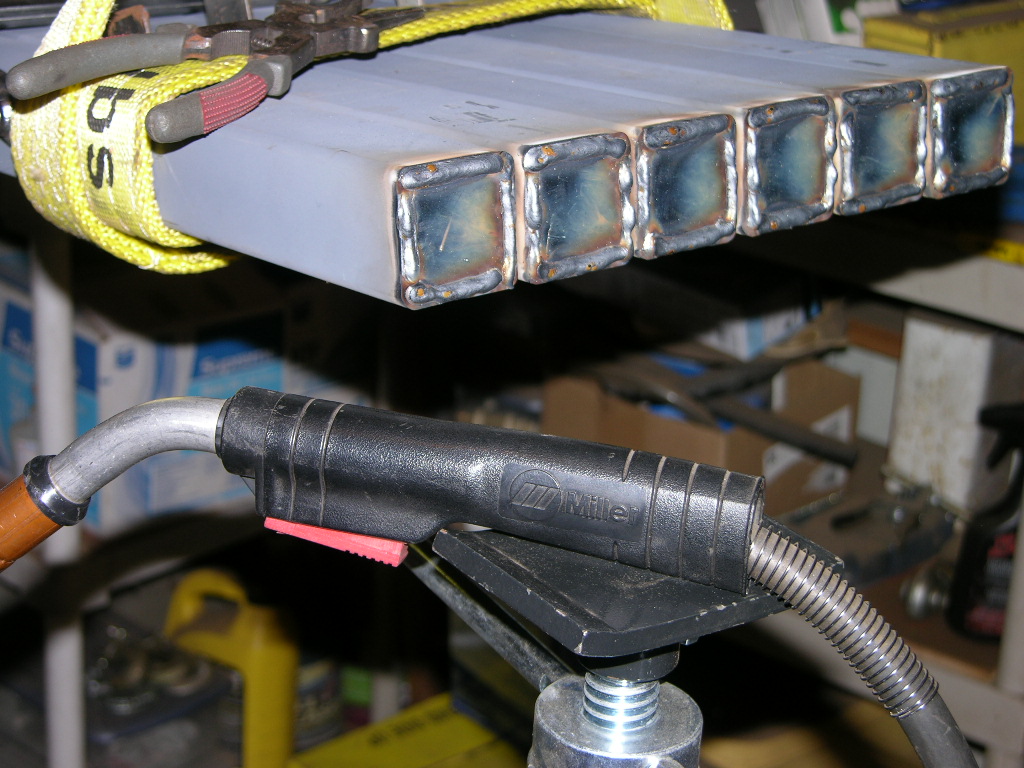

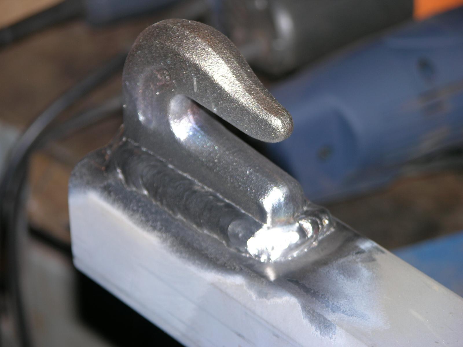

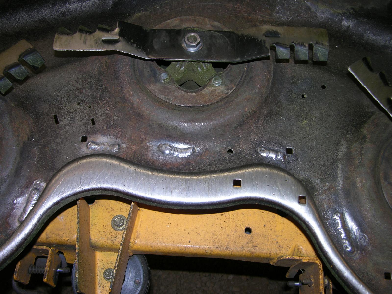

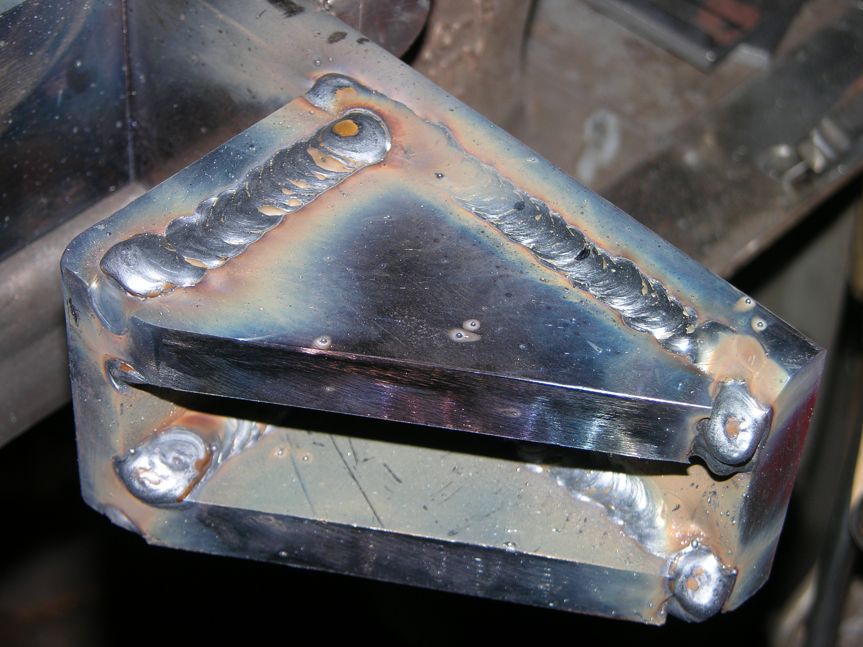

I've been really happy with my 252, I've only run about 100# of .035 hard wire thru it so far, but I've welded everything from 16 ga. to 3/4 plate with it, same wire - I haven't done aluminum with it so far, got a 30A spool gun with it and I usually keep a 2# spool of .023 hard wire in that if I need REALLY light stuff glued together - couple pics, .120" wall square tube, plug welds on mower deck, grab hook on 2"x.250 wall tube, and 3/4" FB... Steve

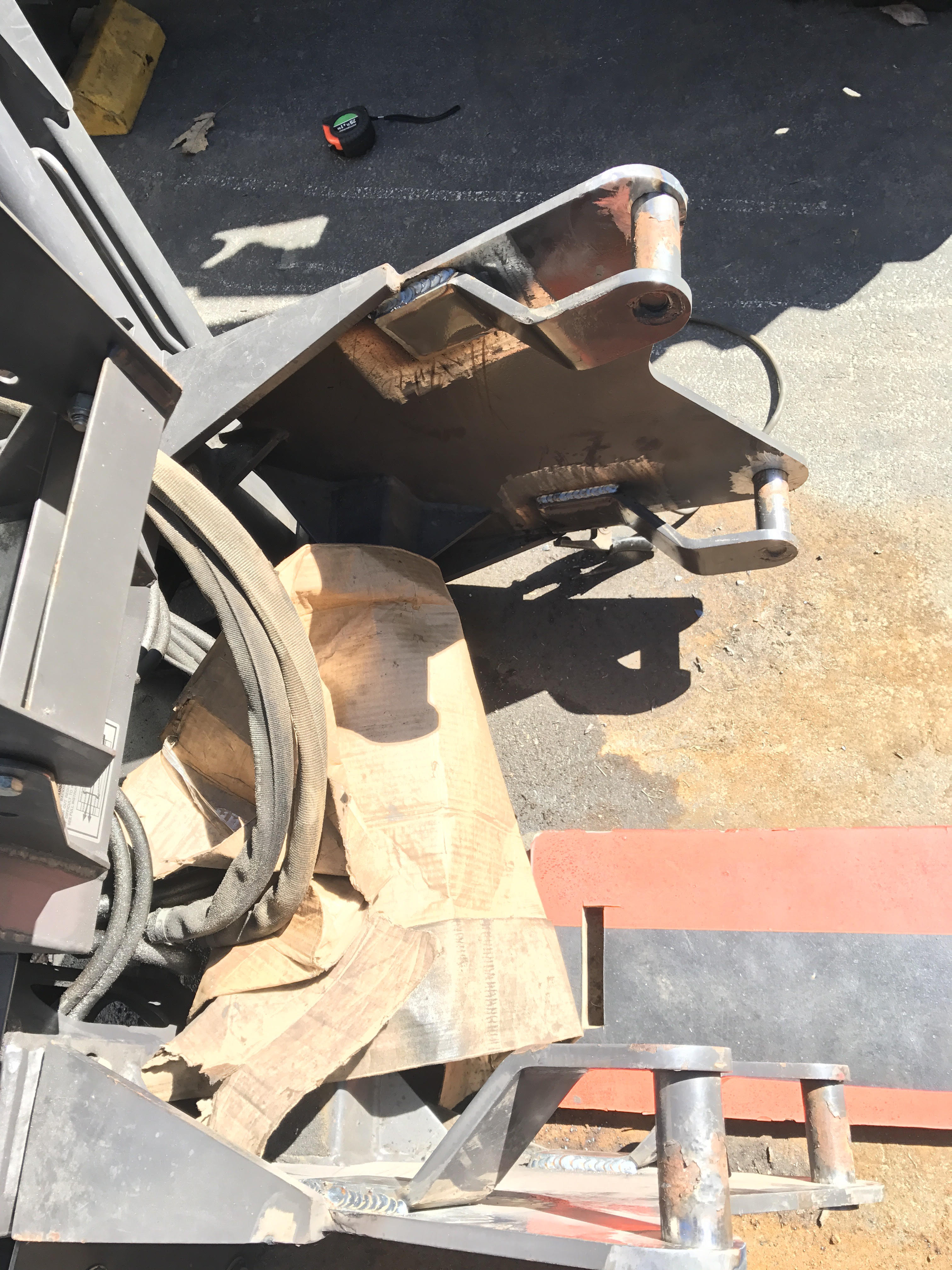

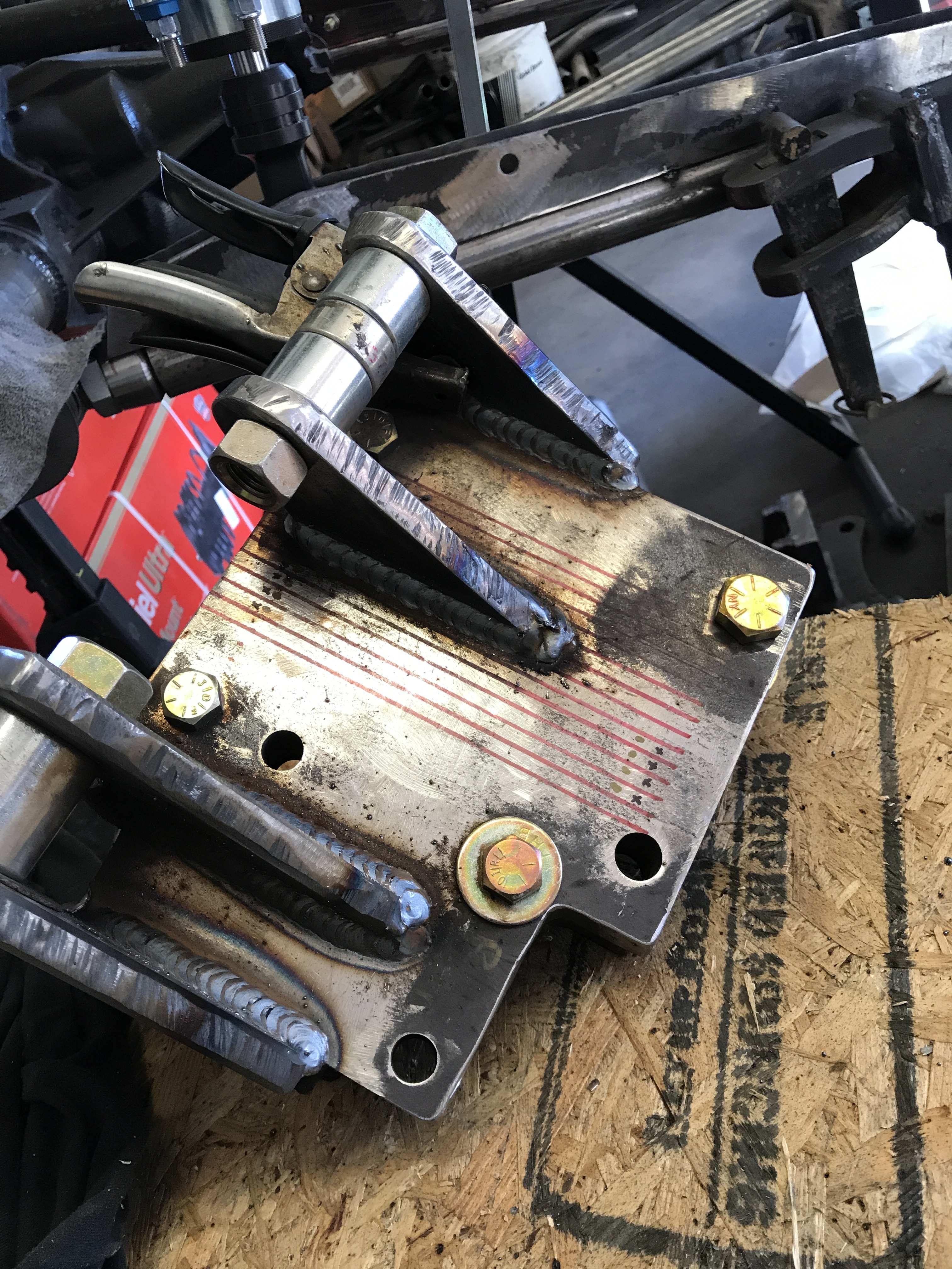

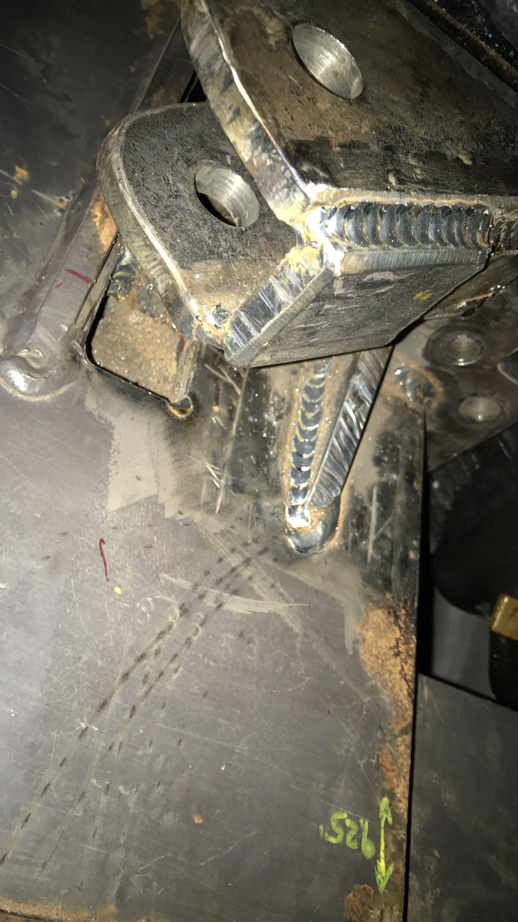

1/2" tabs welded to 3/4" plate, with another 3/4" plate bolted to back; no pre-heat
5/8" welded to 5/8"; no pre-heat
1/2" tabs and bracing welded to 1"; no pre-heat
