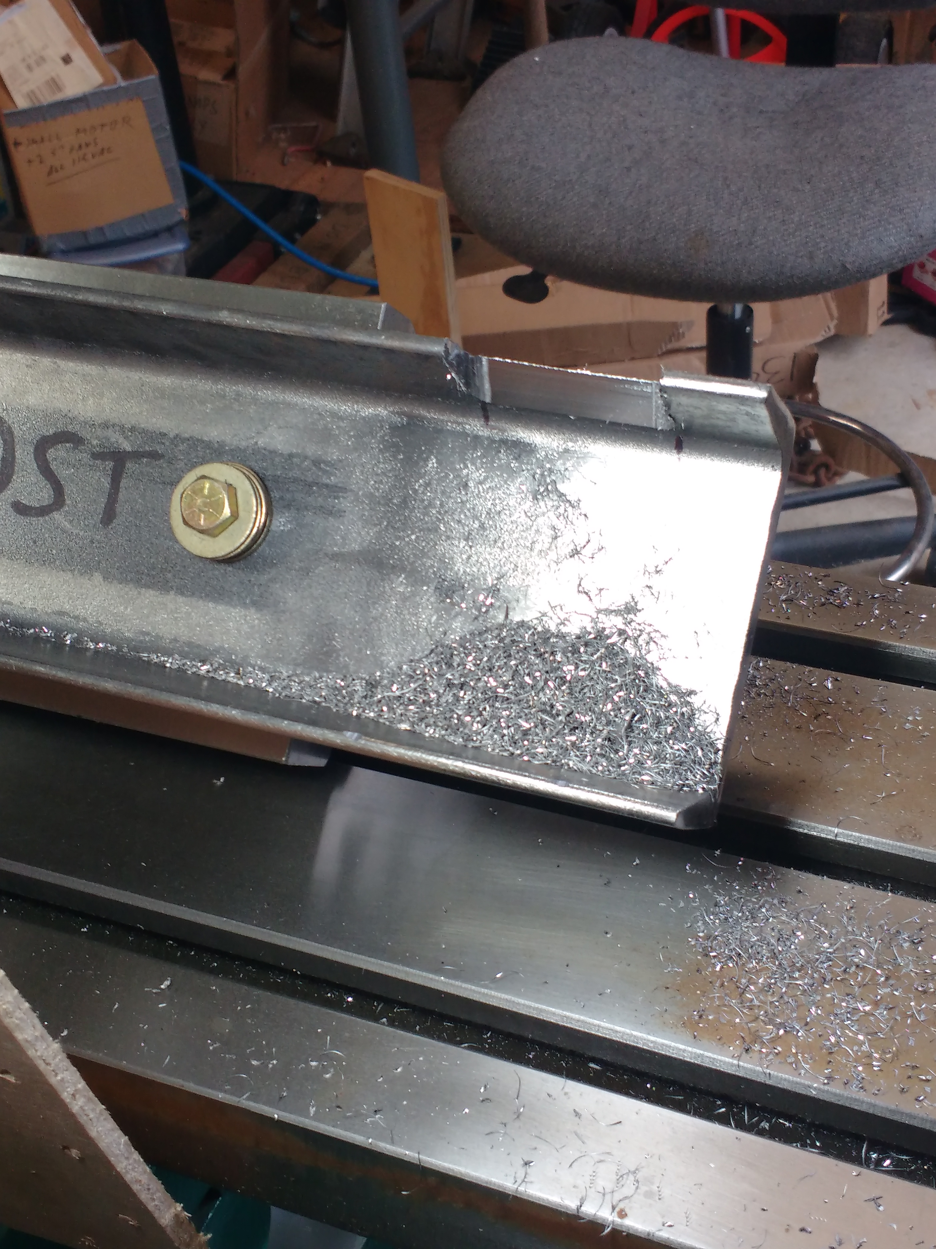

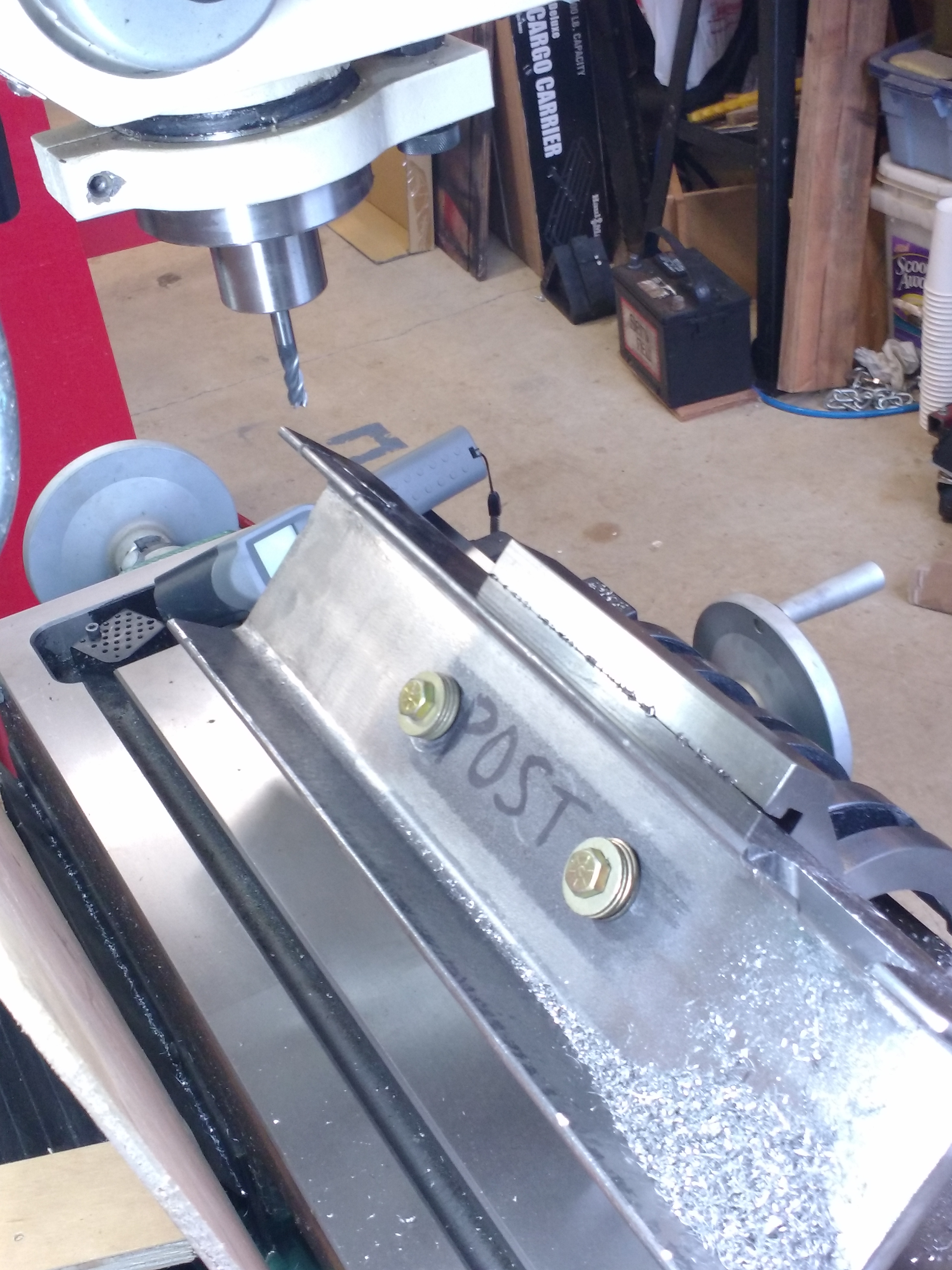

Well, supper's over; back to the shop - some of my fit up on the corner bracing on my modded HF crane are so weird I had to break out the mill to get the angles right - needed to "let in" 2" tube into 4" channel @ 45 degrees, bit tricky to get right with a side grinder :D
Well, back to the same ol' grind (er, I meant "mill") :laughing: ...Steve
