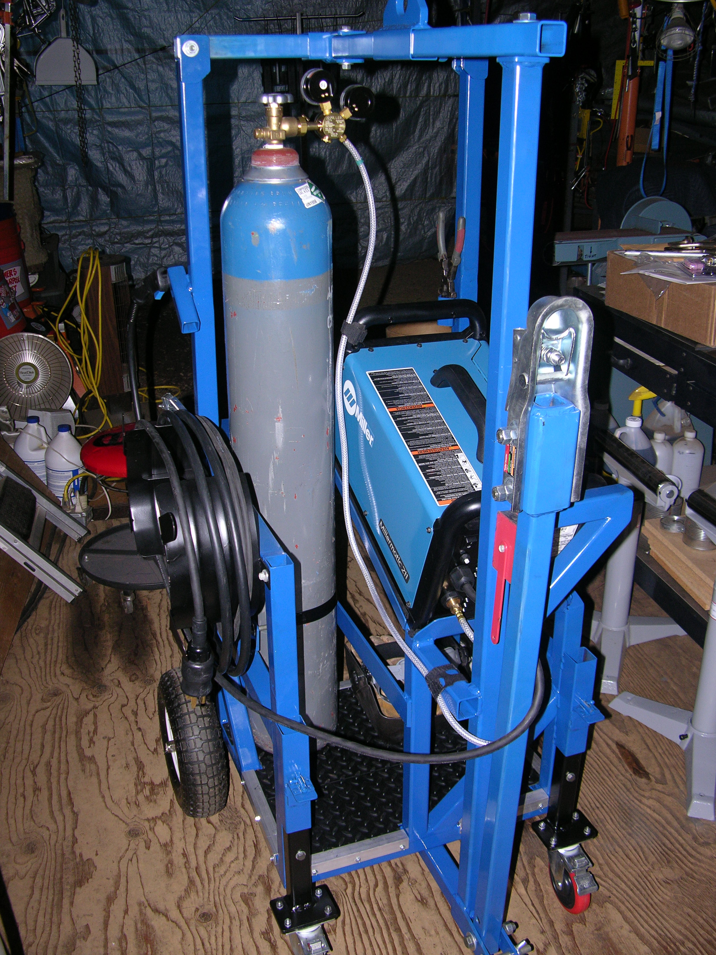

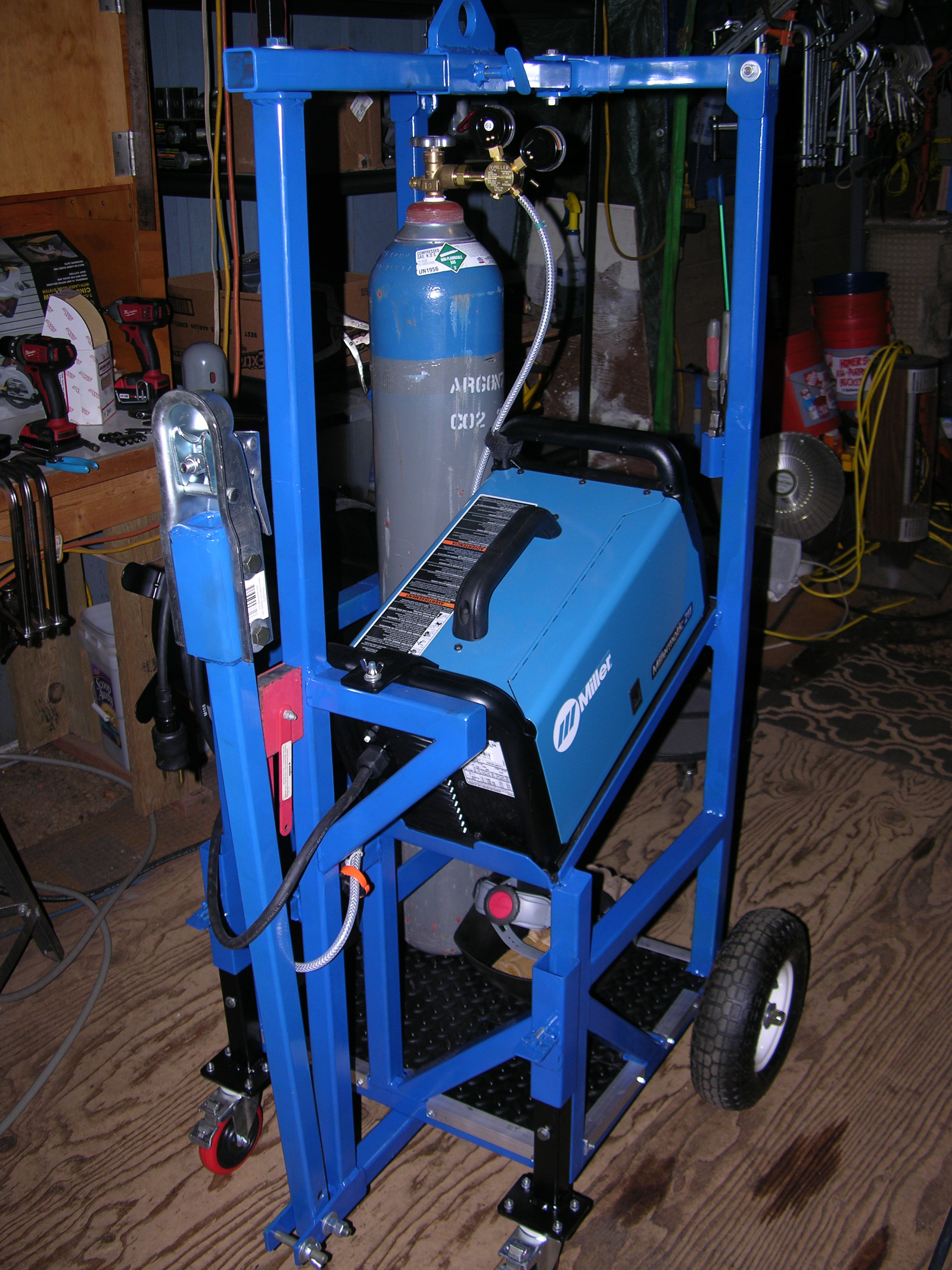

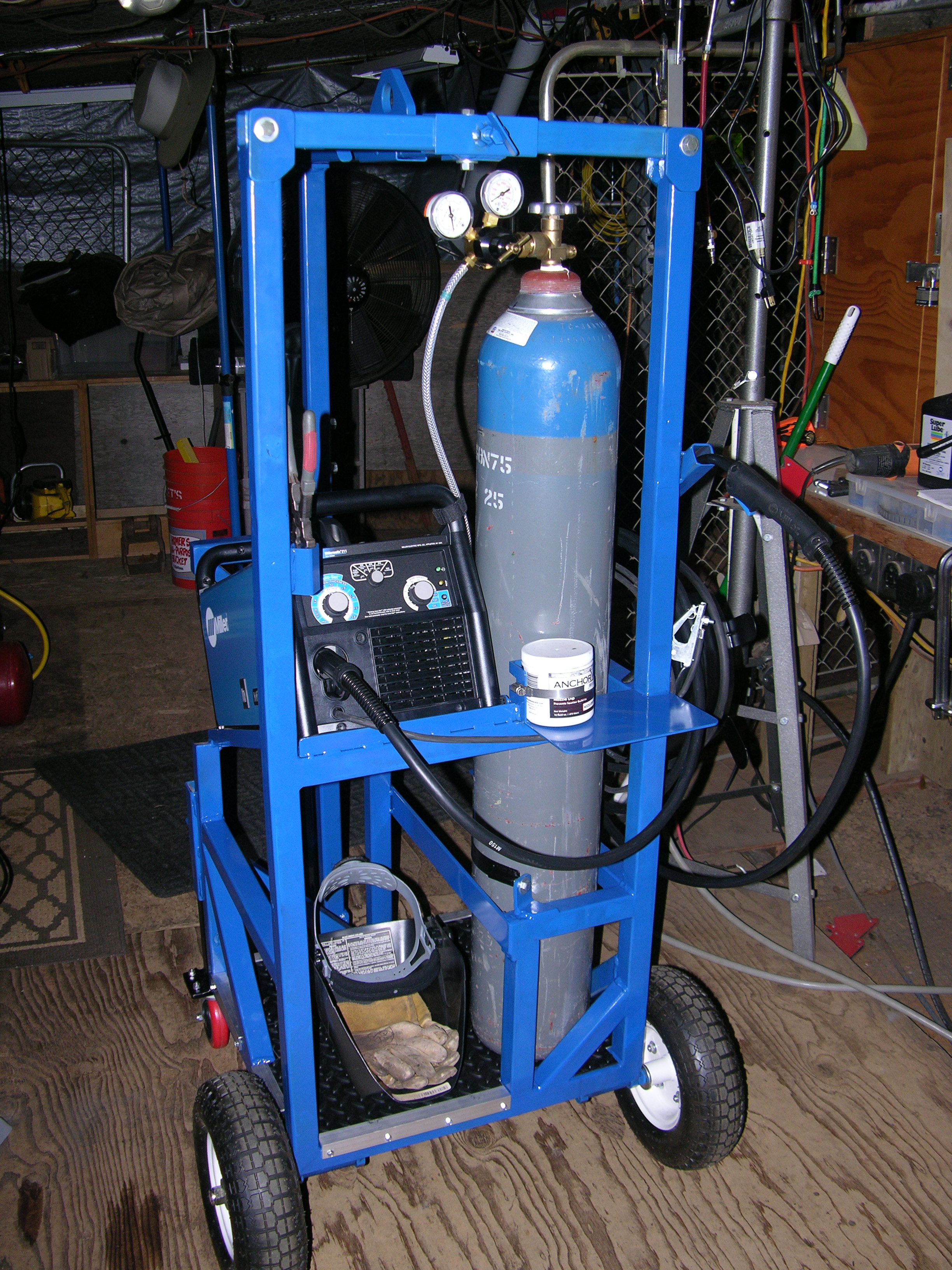

I have to agree that if you have a stick welder for bigger stuff AND want more portability, the newer MM211 is a good choice - Before I got the 252 I had the original transformer based mm211, MUCH heavier than the newer MM211 - I doubt I will EVER sell the 252 while I'm still BREATHING, but I have a few places I need to weld that are either outside, or just without the power required for the 252; so I bought a new MM211 a few months ago - not seeing a noticeable difference in arc from the MM252; also, Miller addressed every shortcoming of the earlier MM211 - weight is less than half, autoset is MUCH more flexible (manual is still there, which I tend to use), fan is now "on demand" instead of always on, the inverter can handle "dirtier" power inputs and 50 OR 60 hZ - my only complaint is that you have to buy a SEPARATE 15' gun if you want one, they will NOT let you "trade up" for a little more $$$...
I built a "4-way movable" cart for it - it can move around on smooth floors using 2 13" tires and 2 5" swivel casters, or I can tip it back on JUST the 13" tires and move it like a hand truck (shorter trips on gravel, etc) or I can flip its "trailer tongue" down and TOW it with my ZTR (the smaller casters retract for this), or (finally) its "roll cage" has a 2-way adjustable "picking eye" so it can be balanced to hang straight regardless of things like changing spool weight/bottle weight - with that I can either pick it with the backhoe or a crane and set it on a trailer or pickup bed...
The "roll cage" is also designed to protect the gauges, as well as support a standard "barbeque cover" during periods of non-use - here's what it looks like... Steve

Wow, what a nice set up! Great work on that cart/wagon :thumbsup:
Good feedback too. Glad you're happy with it.
I use pillow cases to cover all of my welders and plasma cutter haha. I just cut down the long edge and slide it over the front. Keeps all of the dust off of the machine and dust out of the internals when it's not in use.
The new machine is definitely an improved version over the unit i have.

I've been known to be unreasonably critical but I REALLY like that cart.

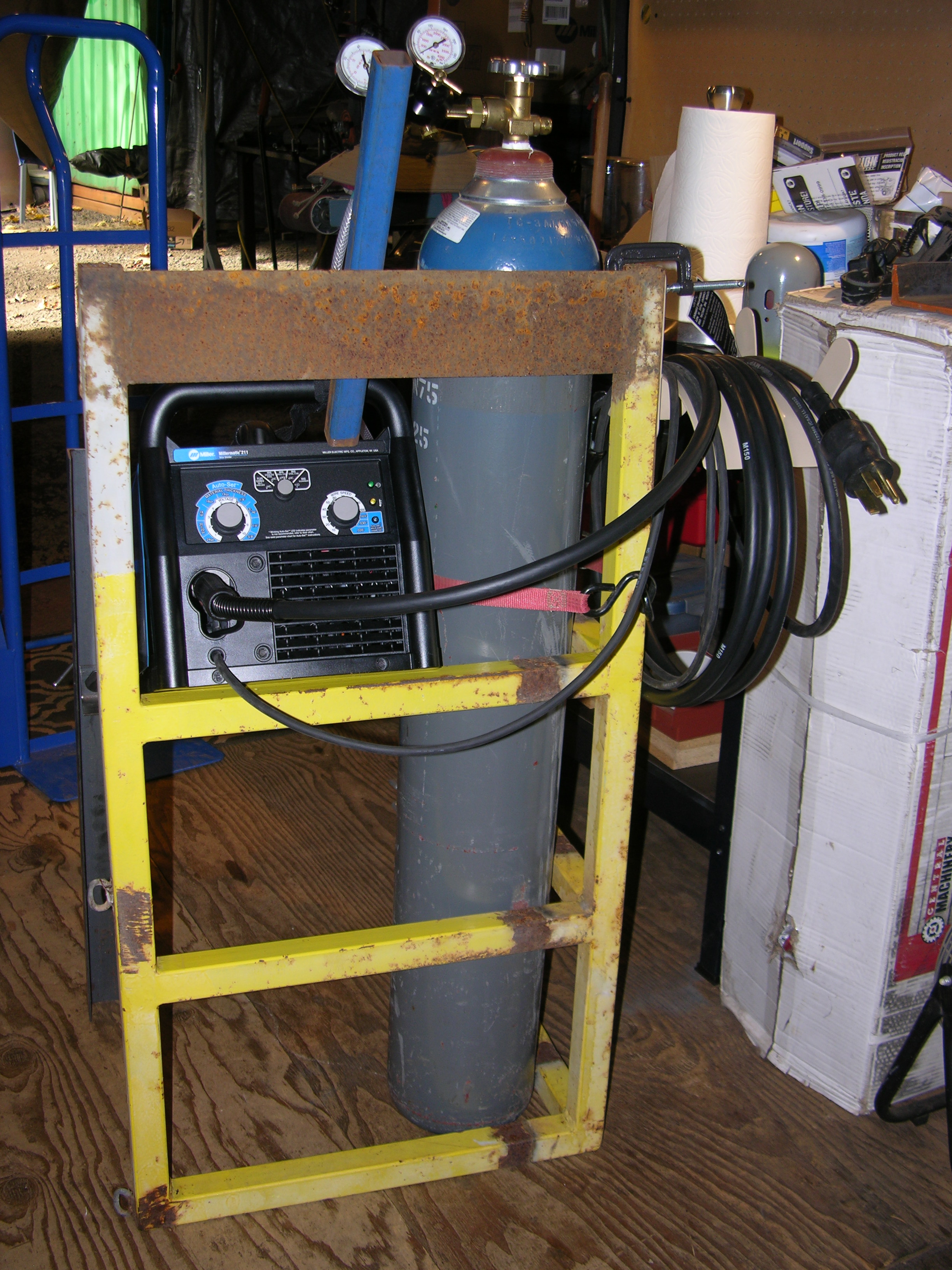

Thanks guys; it probably woulda taken me HALF as long, if I'd started from scratch instead of tryin' to "repurpose" this leftover from an old safety rail :laughing:
Although I'm pretty sure it would've taken a whole different direction WITHOUT that "kick starter " :rolleyes: ...Steve
