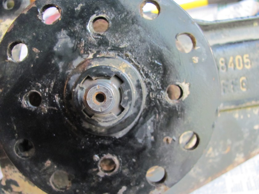

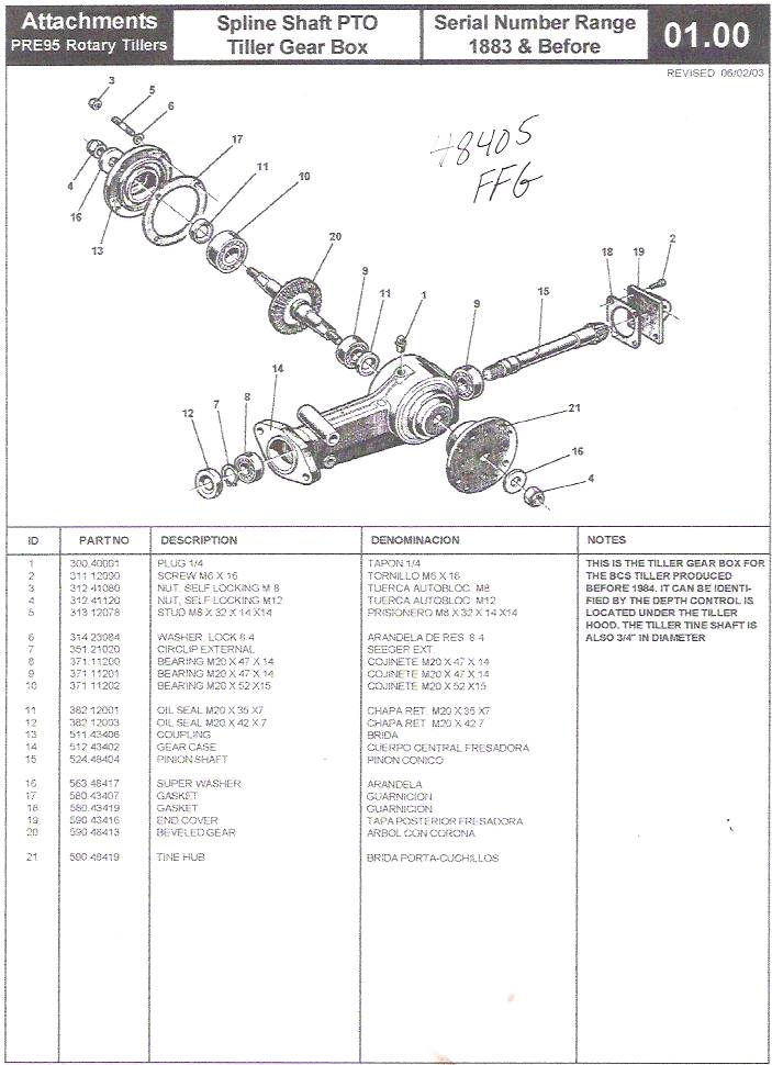

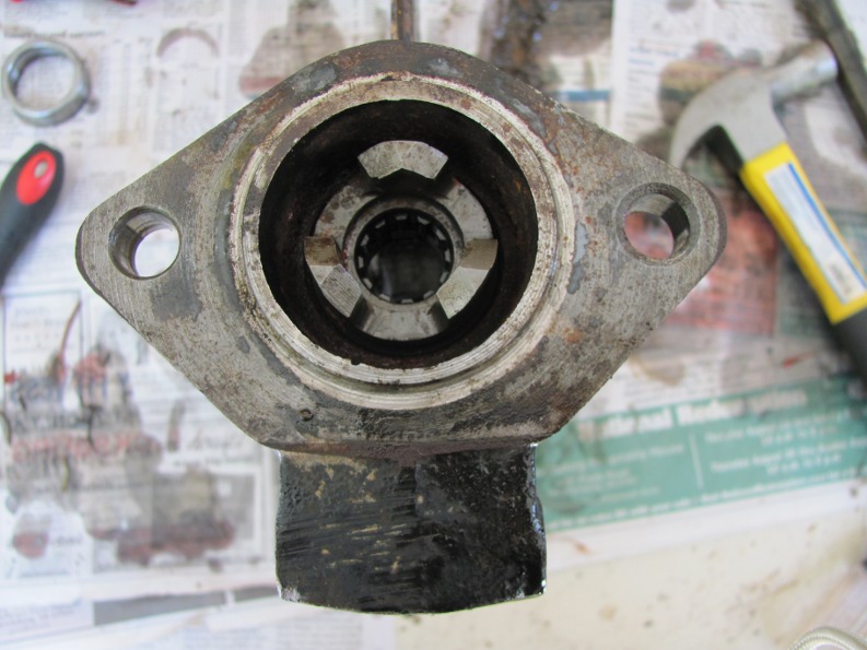

Okay, I tried attaching some files - including the diagram. Preview looked good, so this should do it.

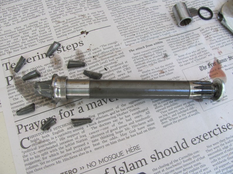

I was able to get the hubs and the coupling off. The bearings on the side of the coupling look good. I was going to try and push the ring gear and shaft (beveled gear) through, but I thought it might be good to take the end cover off first. After doing that, I'm beginning to think that I should have started there - ugghhh. After taking the end cover off, I can clearly see the ring gear and it appears to be in good shape still. So... I think I'll try pulling the pinion shaft from the front side if that works. Maybe I have to pull the ring gear out anyway to get to that - not sure. If the pinion shaft does not pull from the front, that's my only option. The diagram shows the pinion shaft from the rear of the box, so maybe that's the way it goes.
I'll update with a final post when all done (if I ever get there). For now, I'm good - thanks to you guys for all the help.
   / Help taking apart a tiller gear box #13
The shaft has to come out the back of the box, so the ring gear has to be out first. Is that an extension on the tiller? If so maybe you got lucky and it broke?

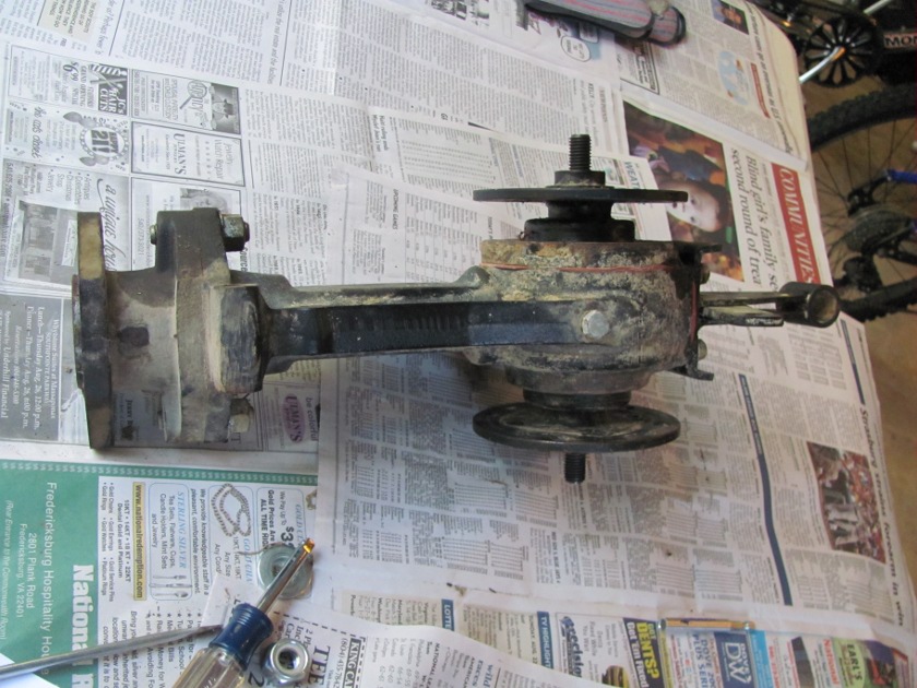

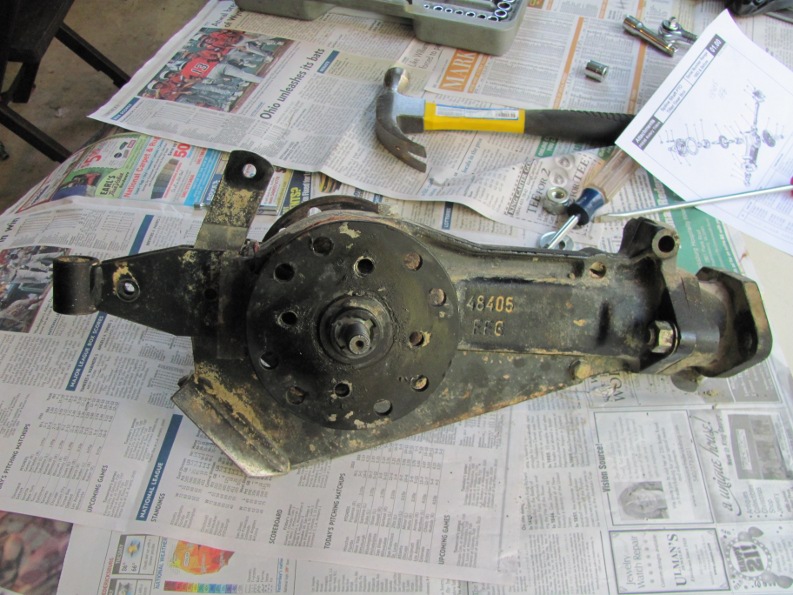

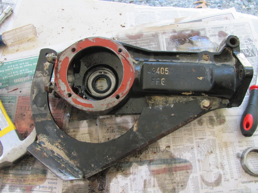

Clytle, yep I did have to remove the ring gear - was able to tap that out without damaging the bearings. I was not as lucky though removing the pinion shaft (name?). As soon as I removed the ring gear and turned the box upside down, 8 teeth fell out - came right off the pinion shaft. The pinion shaft is 7 1/4" long. All said, it appears that I'll need the following parts: pinion shaft, gaskets for end cover and coupling and the bearing that goes on the end of the shaft inside the gear box. The ring gear has 27 teeth whereas the pinion shaft had 8 teeth.

Again, thanks for all the info - you guys have been a big help. Attaching some other pics just for info:

   / Help taking apart a tiller gear box #15
Glad to hear all is tore apa.
Hey I bet gorrilla glue might hold those teeth on that bald shaft for ya--hahah
wow you said you hit something--man that takes alot of force to remove those so neatly!!
ya if you could find a nice used tiller that was babied that may be the way to go considering the parts cost.
Ya the side load bearing at the coupler I think was the one which could be replaced with just a stadard bearing of the same size according to "Pointers on rebuilding a BCS tiller gearbox" in this section

Looks like I'm late to the party. I'm really shocked that shaft could be damaged like that. Were you tilling a parking lot? :p You have a newer style round-top tiller since it's a 3 dog PTO, making it even more surprising.
You'll find that shaft is well over $100. A new 20 inch tiller box is $500. By the time you buy all the necessary parts, you may as well pay the extra money and buy the new box. As others suggested, you could find a used box in time, but it could be awhile. Anyway you got a good buy. The tractor alone is worth $500.

   / Help taking apart a tiller gear box #19
I'm wondering if the pinion shaft bearing race broke and first got between the ring and pinion gears, that would explain tearing the teeth off like that. I honestly thought that those gearboxes are strong enough to stop the engine cold. Is that a 5 or 8 hp motor? Either way, I think that is the same gearbox as the 30" tiller that Earthtools sells with 11 hp diesels. Our 715 ate a 1" steel pipe and stopped it cold, and it had an 11 hp Briggs on it.
Are the teeth wore real thin?

To answer your questions though: it has an 8 hp Kohler engine. No, the teeth were really not worn thin at all - they were just separated from the pinion shaft - all of them. Hard to believe, isn't it. The tiller attachment is 26"
