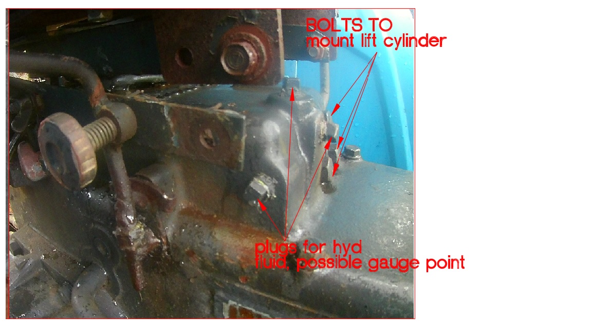

itsmesrd;4896605 It also seems that if I want to test pump pressure I will have to CUT the high pressure line and install some sort of tee in the line for the gauge. Not something I really wanted to do.[/QUOTE said:
The original design must have contemplated a way to measure and adjust hydraulic pressures without cutting into the4 system. Hopefully a manual will say more.

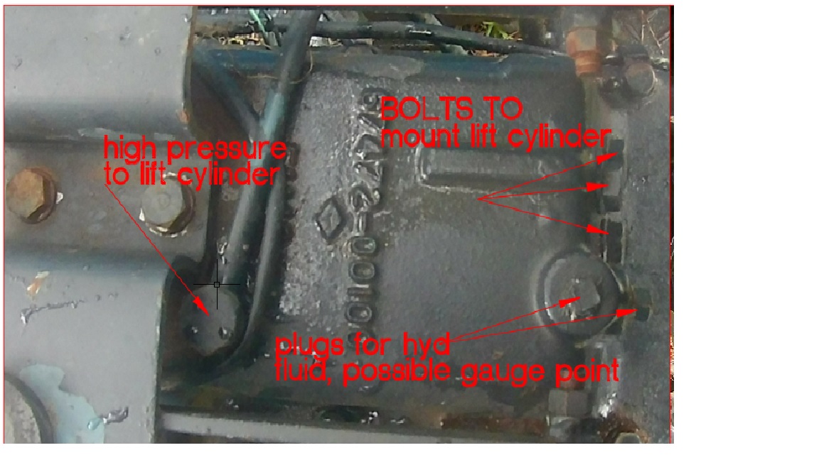

Your photos are helpful. FYI the ones formed into heavy castings are of little use and likely contain manufacturing info such as the date it was cast.
The Aluminum label is the sort of thing that I am looking to see.

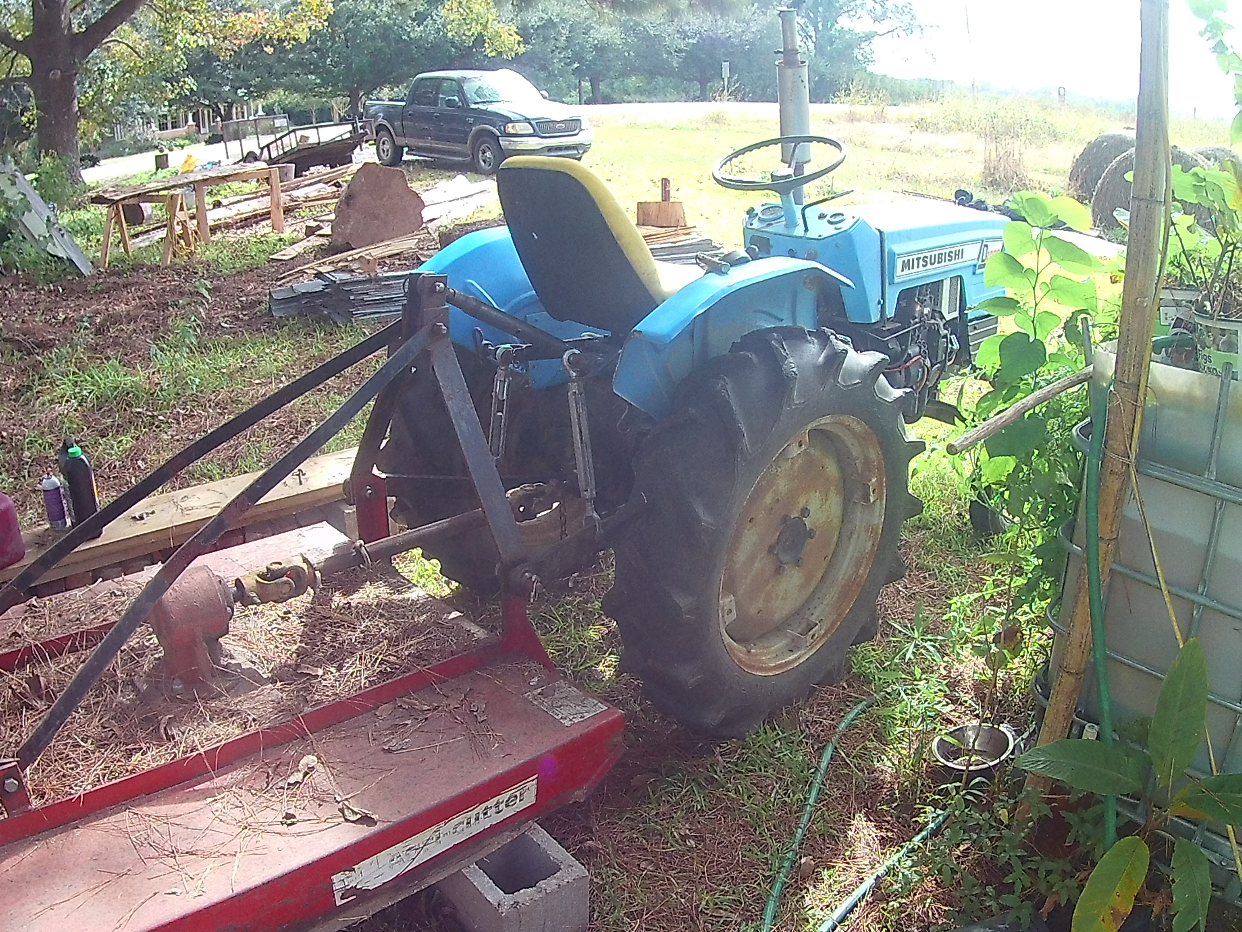

You mention a "bush hog." I keep asking you how a standard Bush hog could work when you have a reverse rotation pto.
Now as I study the underside of your tractor looking towards the rear, I see a red brush cutter that looks like someone fabricated themselves and it is not from a factory.
Did you actually see the name Bush Hog on it or were you just using a generic term?

I cranked the tractor yesterday to put it under the lean-to on side of the garage out of the rain. And tested the PTO for direction. It turns clockwise when looking from the rear. "Bush hog" is use around here to mean any sort of rear mounted lawn mower type bush cutter.
Yes the tires look likely to be original to the tractor. They have been beat to death because the person that hooked up the 3ph on the tractor didn't use the proper type or length of sway chains. Also probably the wrong length lower arms. If the bush hog isn't lifted at each hard left or right turn the bottom arms try and hang up in the tire treads. The original owner, not my nephew, is a little on the dopey side. If you know what I mean. He used the tractor for 4 or 5 years before it came to us. Very little in the way of maintenance. I've located a set of rear tires with probably 75% tread left for $500, still seems a little high. At least for me right now.

shot showing the "bush hog"

The number on the side of the transmission housing is just a manufacturing date and of no use to us.

Shots of the front of the front of the lift housing cover.
Could the number on the housing indicate the year the housing was made and the number of units to that point?

I think the number cast into the housing M62-73908 is likely 1973, 9th month 08 day of Sept 8, 1973.
