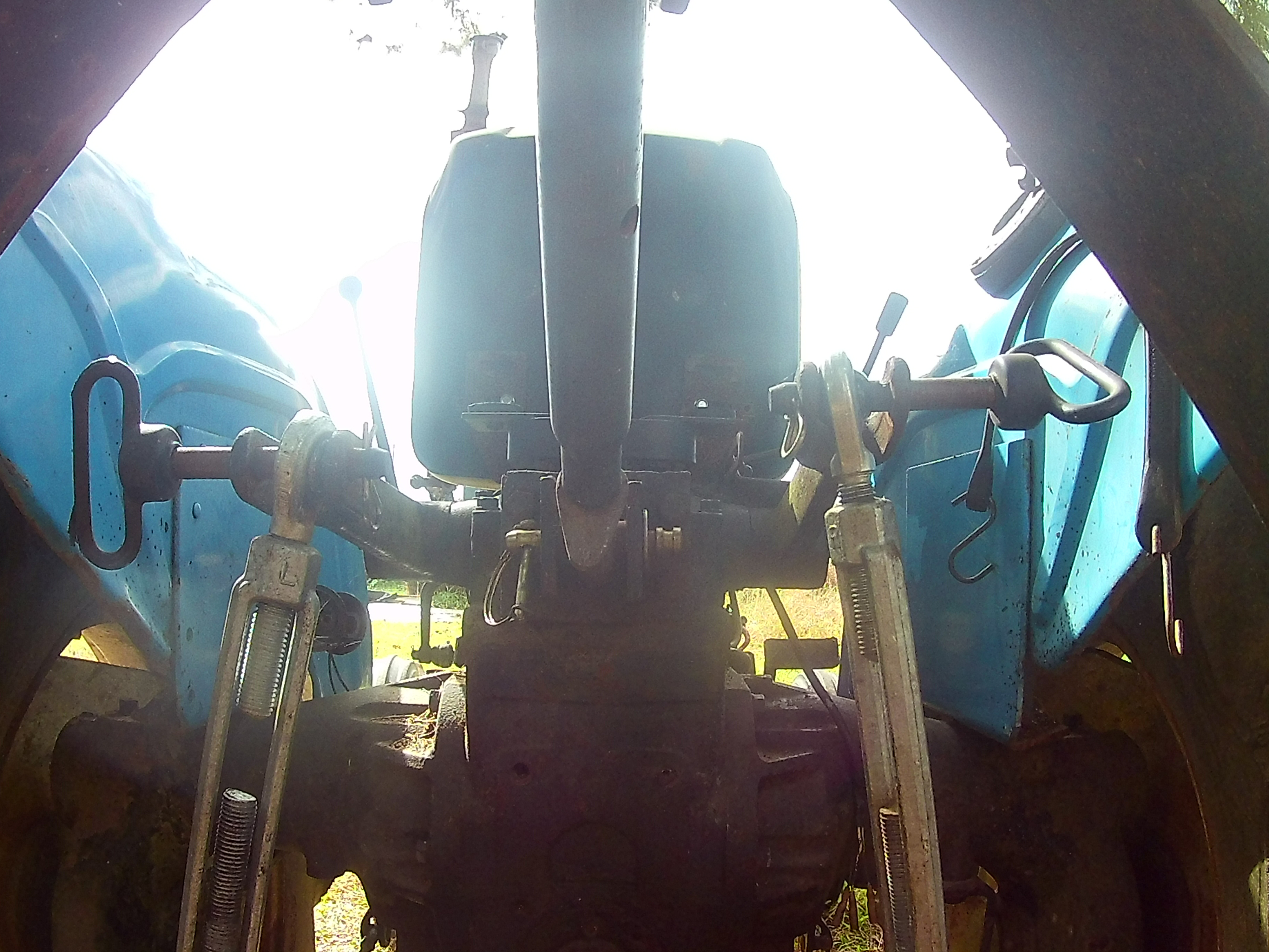

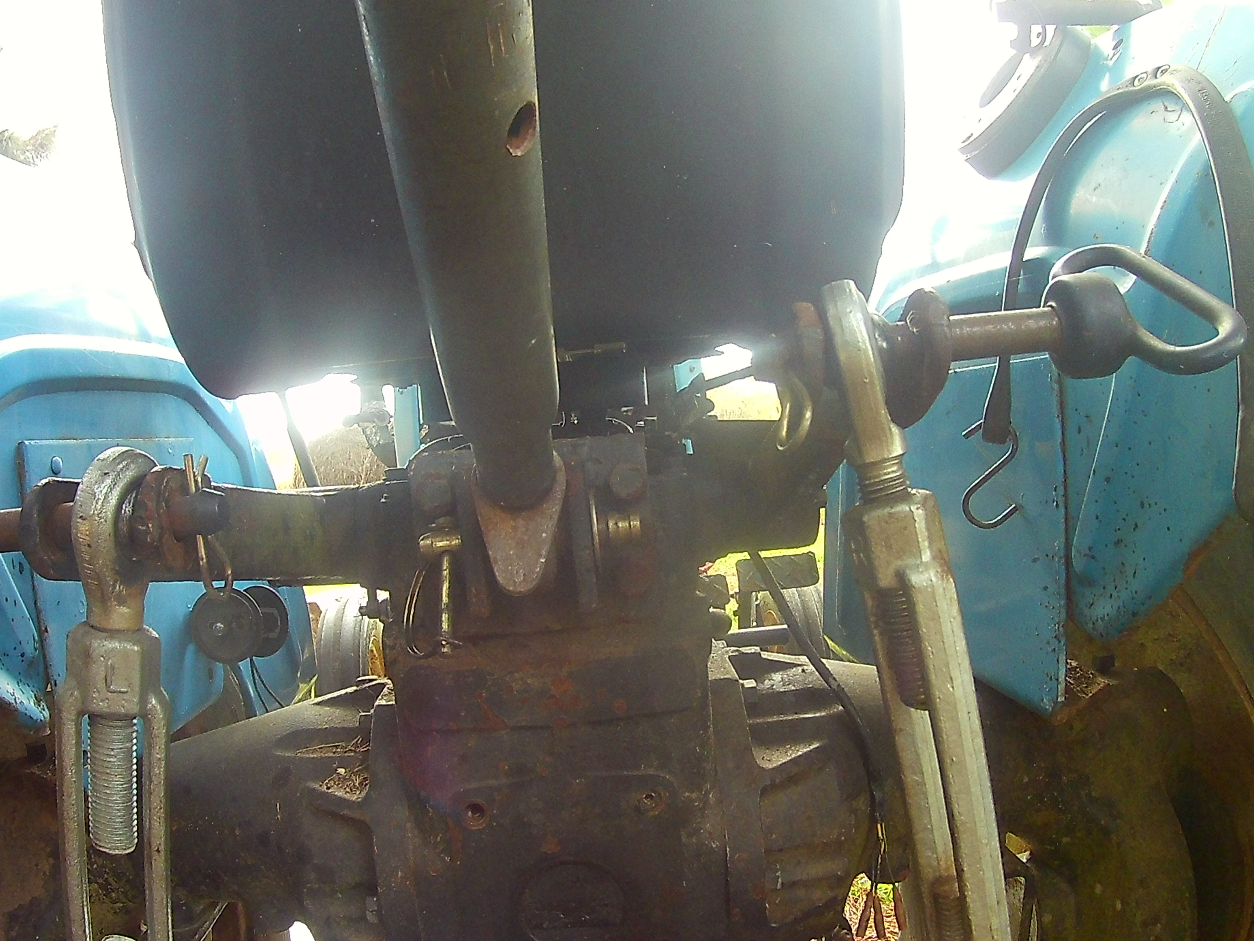

Lift arms have easy to use adjustments as not all implements need arms at exactly the same height. Usually, one of the links between the lift arms and the higher up arms driven by hydraulics, have a screw or multi hole adjustment which should not require you to remove anything.
This is one example:
On this Kubota, the right lift arm is screwed longer or shorter by the two handles on it, in order to adjust the side to side height of the lift arms.
Dave M7040

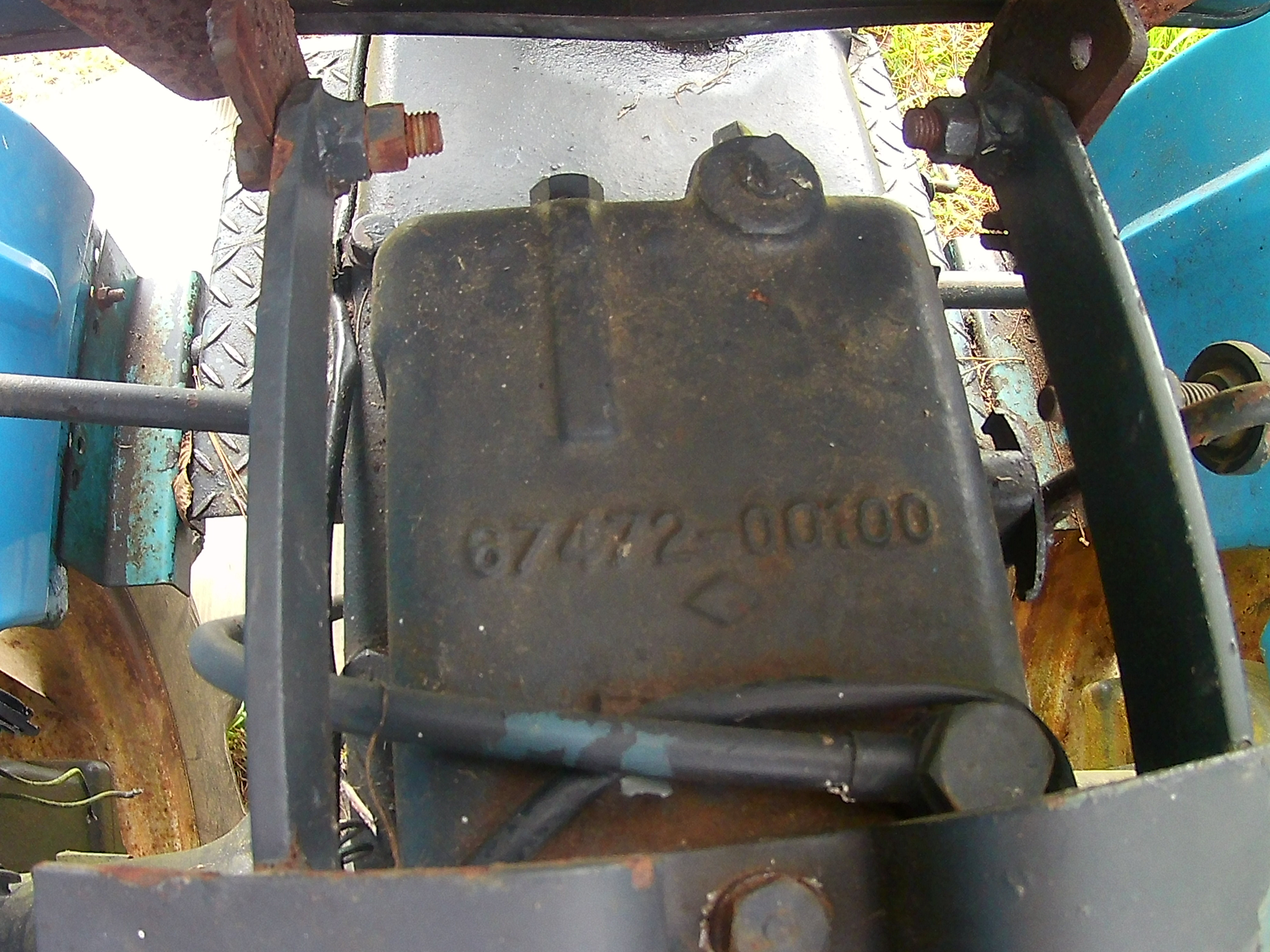

imagine that it did insert an image for me. this shot shows the unevenness of the two top links that I was talking about.

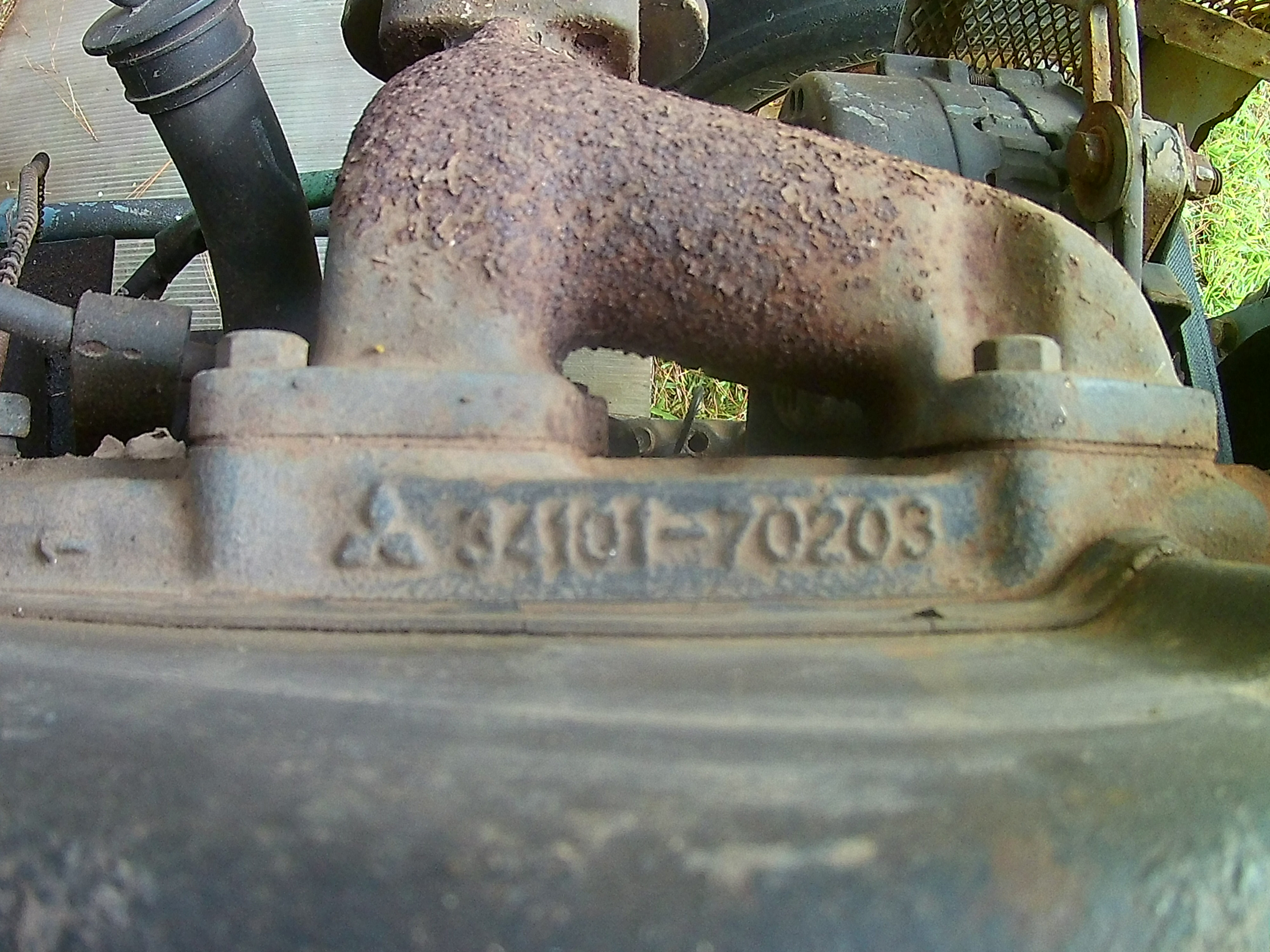

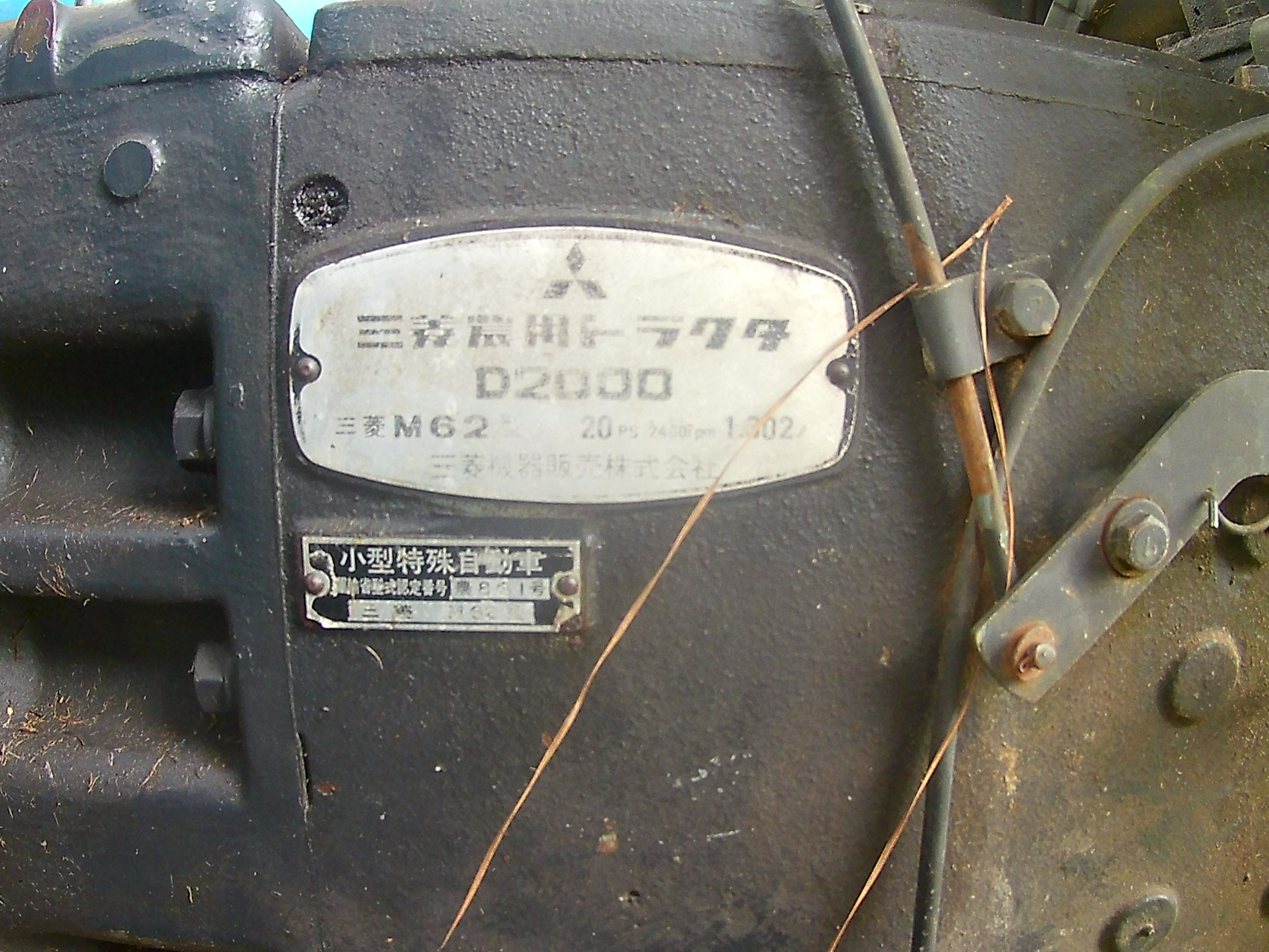

20161222_041510.JPG this one is the plate on the right side of the trans housing

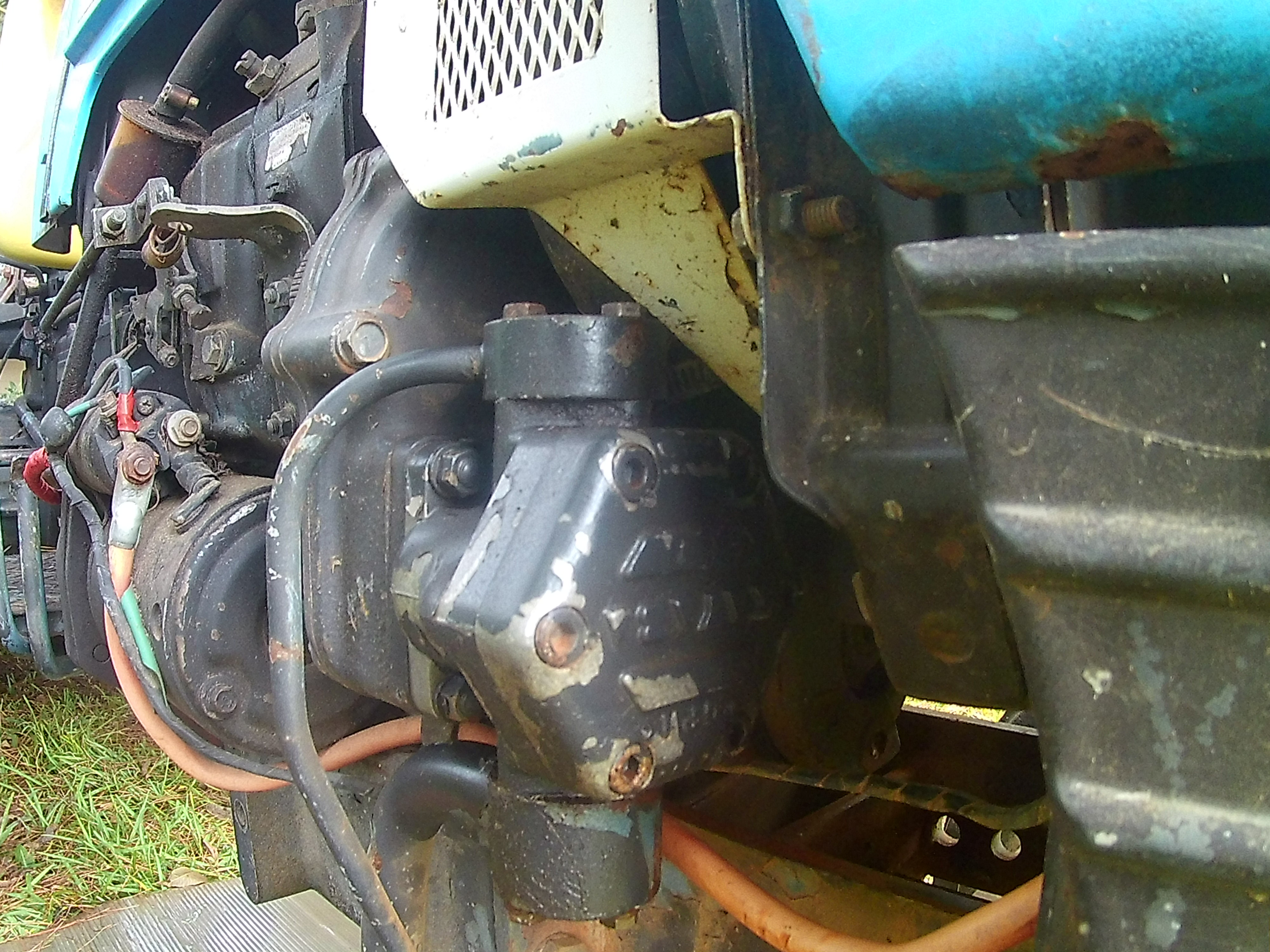

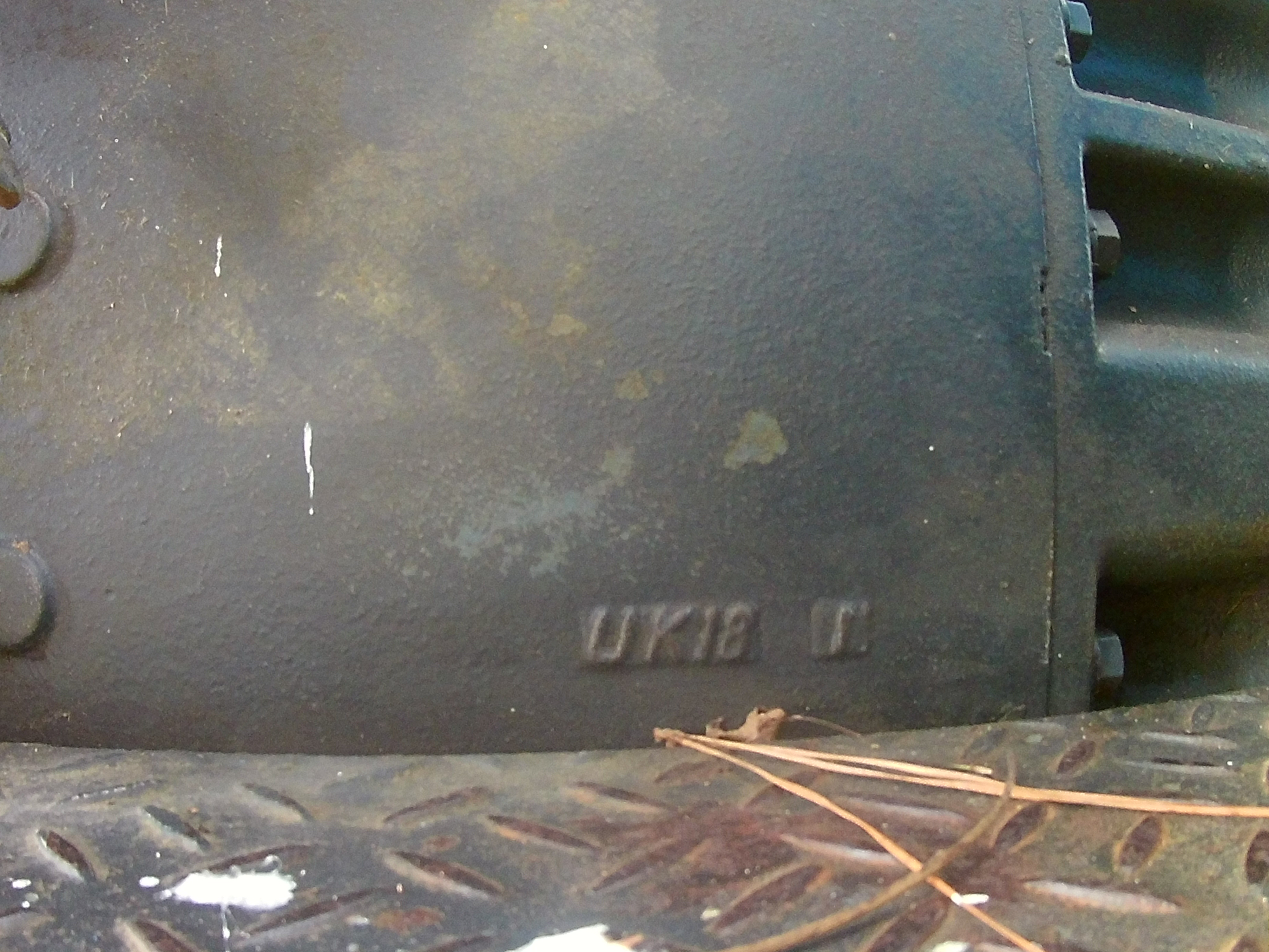

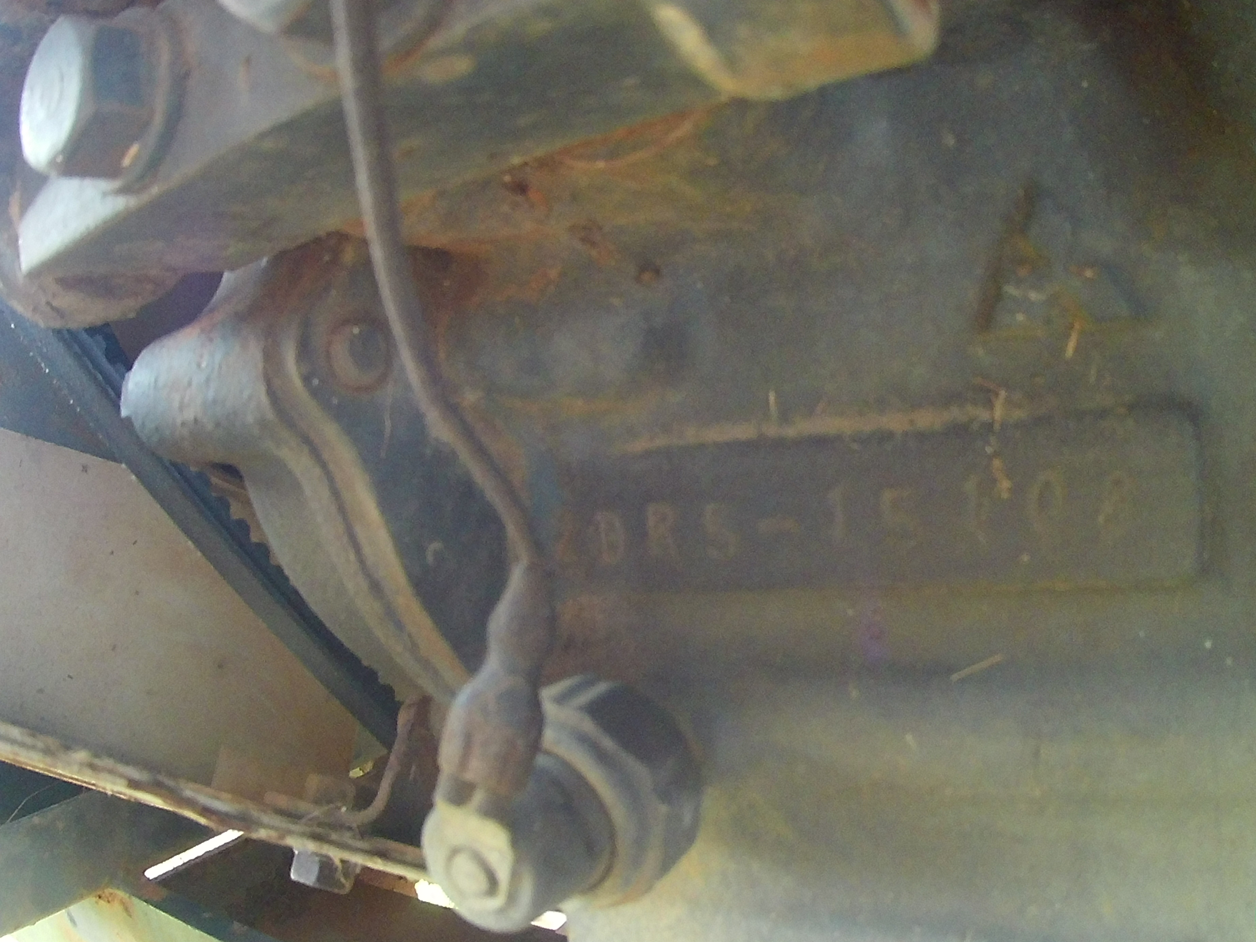

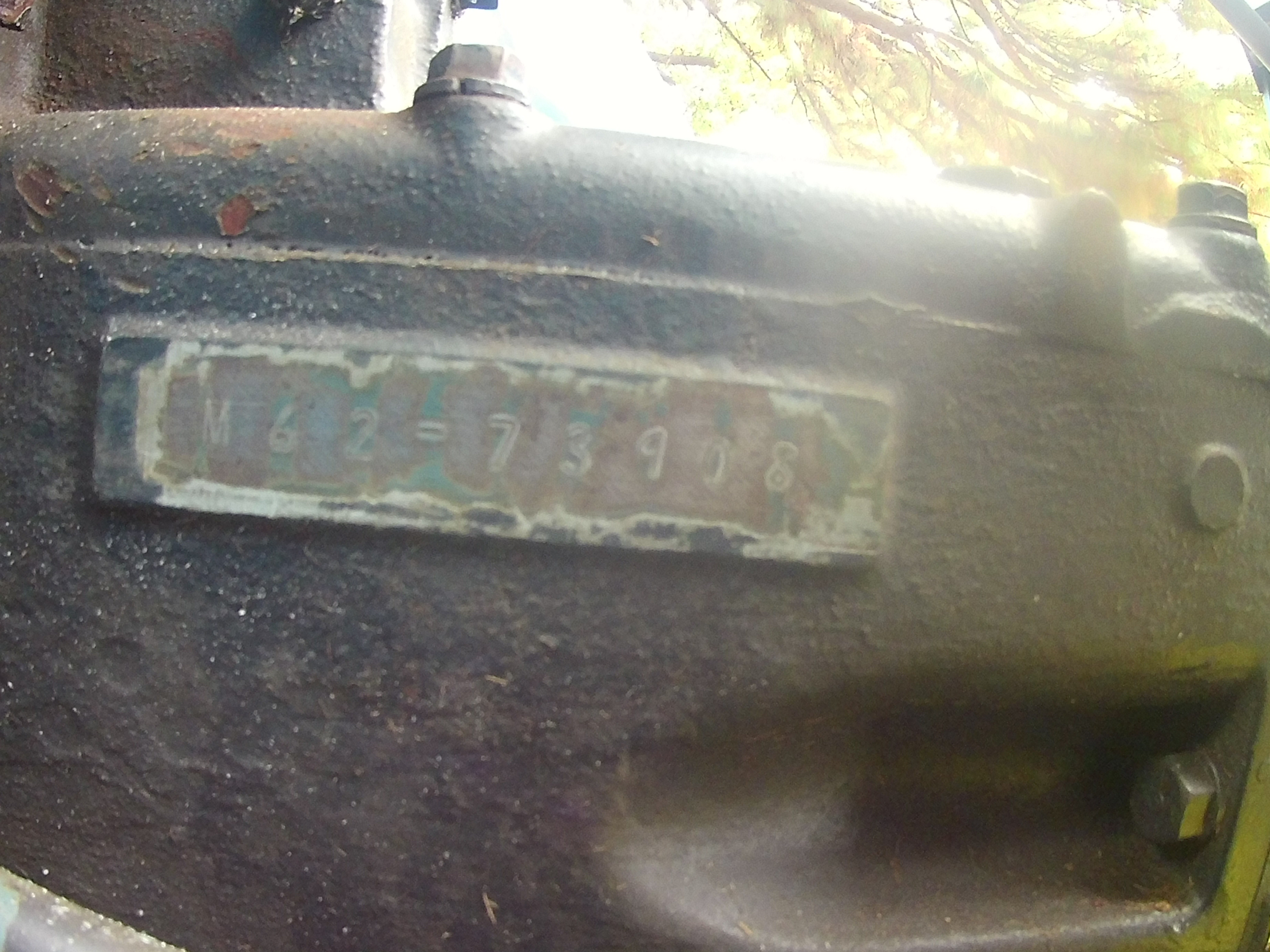

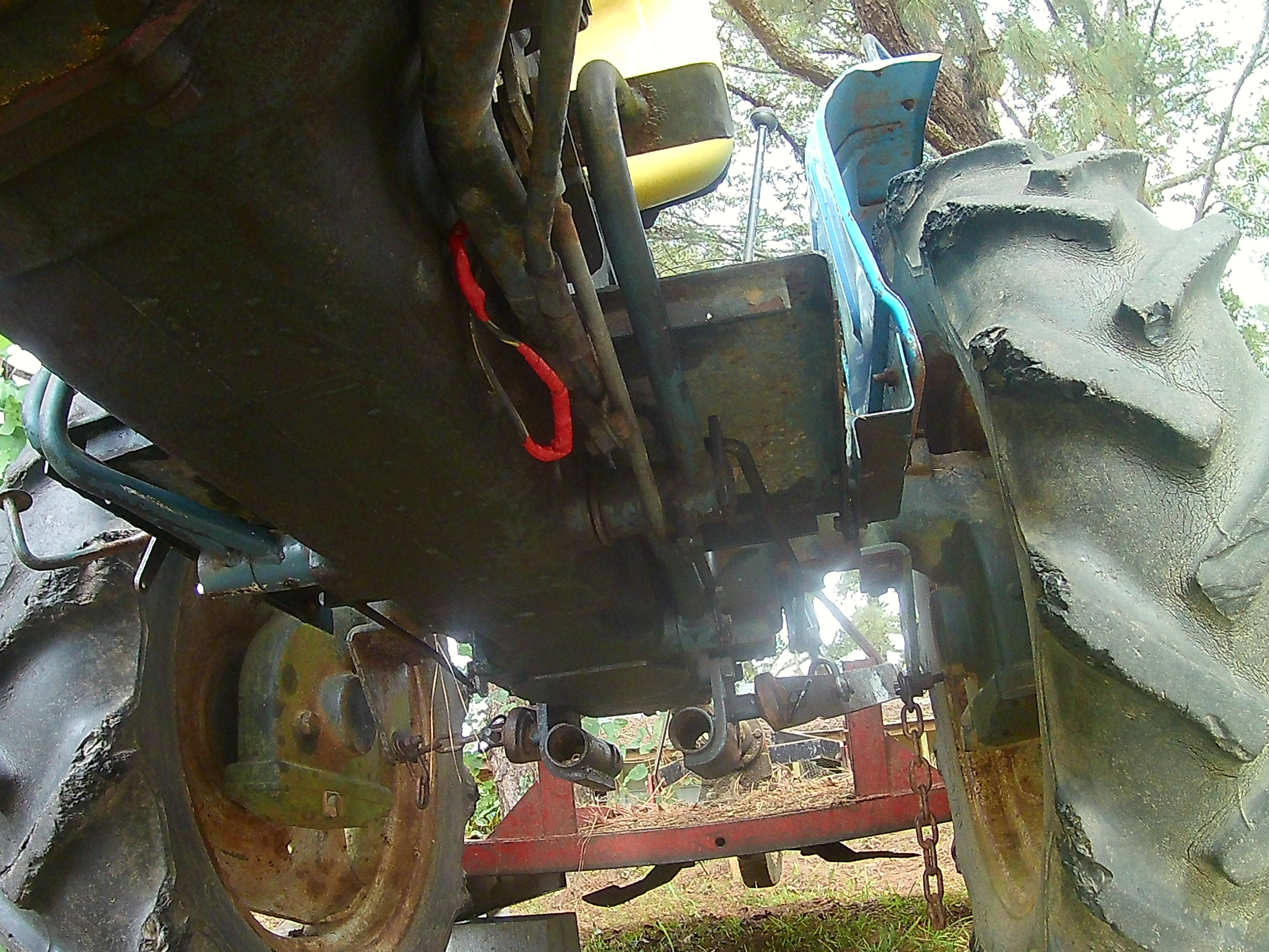

When you were posting about milky hydraulic oil you were asking where the drain or drains were if I remember correctly.
Your photo, which I have marked up with notes, shows gear sets for each rear wheel. These gear sets are used to keep the underneath of the tractor up high and only going low close to each wheel.
These gears at each wheel need to be lubed. Right now I cannot tell if these gear sets are receiving oil from the transmission or not. They could each be separate from the transmission.
If they are part of the transmission, then this is where any water would collect as oil will float on top of water and water goes to the lowest point. It is important you clear this up quickly as these wheel gears will not tolerate being lubed by water. When you have your eyes up close to these gear sets, a drain may be more apparent than I see in your photo. I see one large plug which could be a fill plug for oil for each wheel.
Loosening a plug at the bottom of these housings on both sides after the tractor has sat overnight would have water drain out first when the plug is removed,

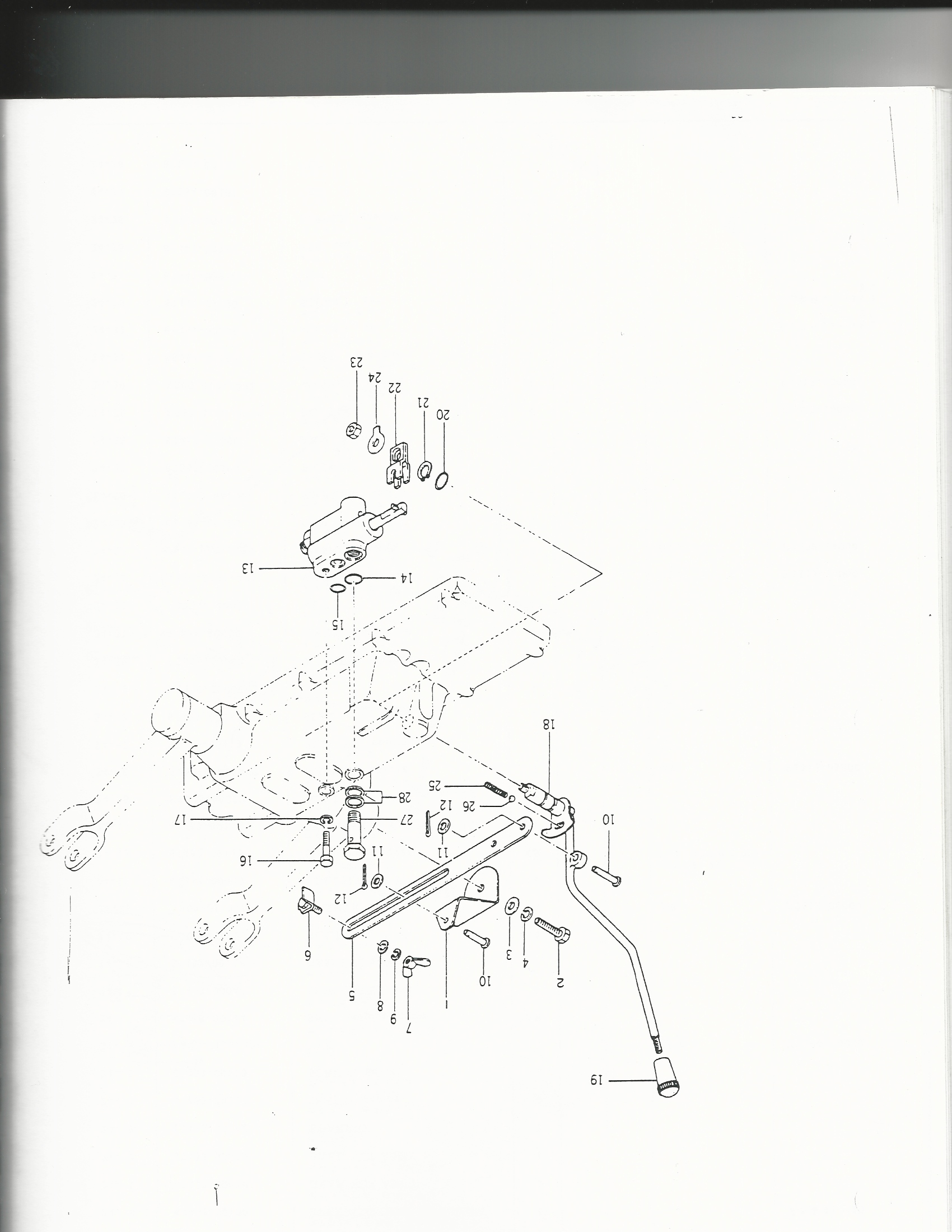

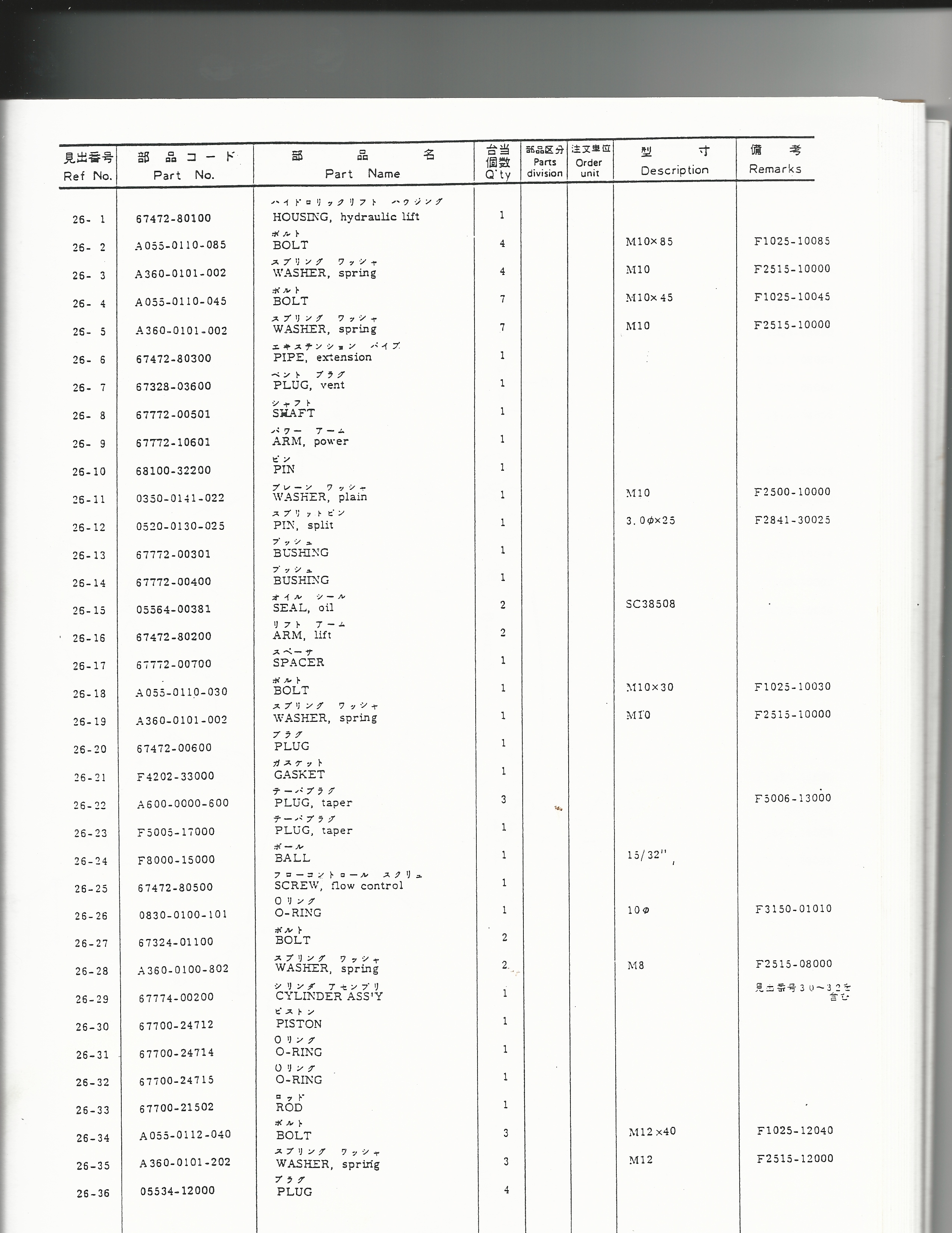

Did you look at the ebay manual?

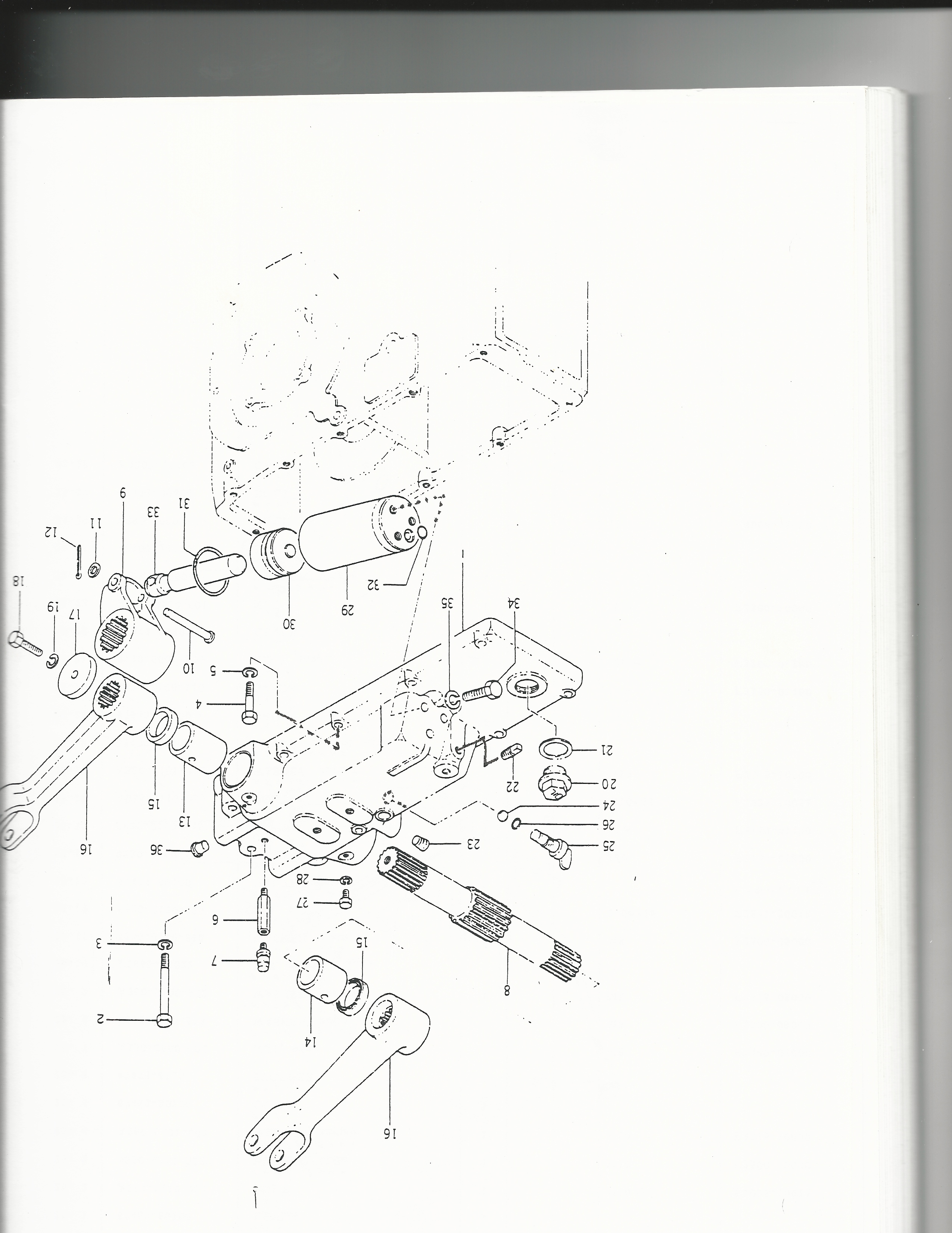

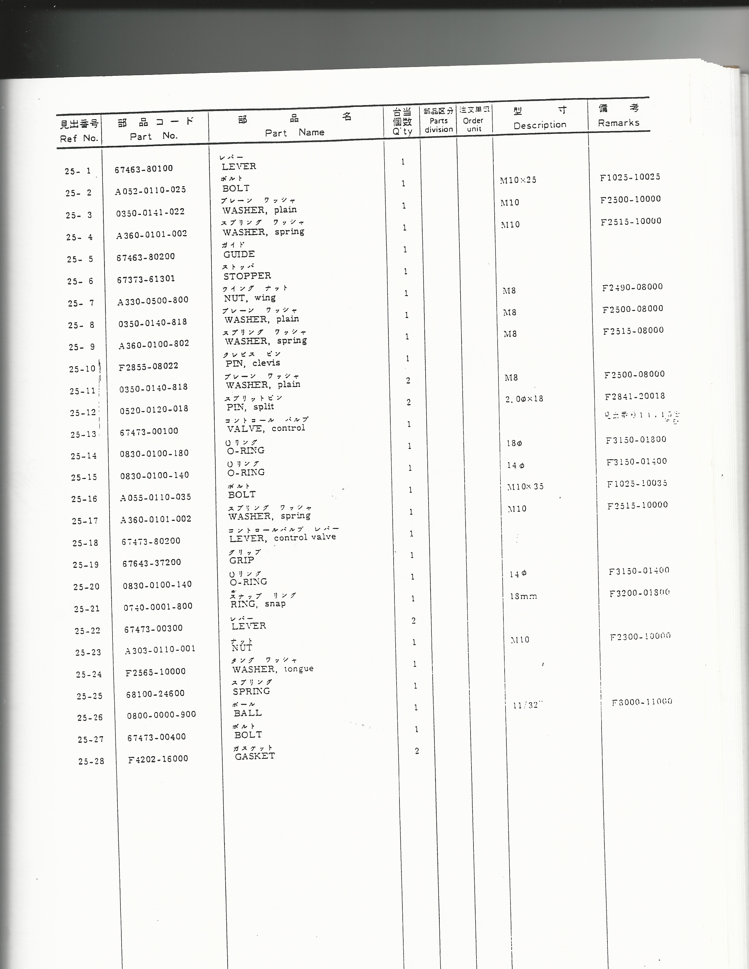

From what I see in the parts manual the top plug in the pic is to show oil level, the lower is to drain. What isn't showing is a plug at the top of the axle housing that would be used to fill. I'm not totally sure but looking at the book it seems like the axle housing is separate from the trans/rear end housing. But not really sure. I think the best drain for the trans housing is the plate covering up the hyd filter. It is as close to the bottom of the case as anything I can find. Yes I did check out the manual. I am however working with the folks at Southern Global trying to get one for this tractor. I can also have my brother who lives in Mississippi pick it up for me to avoid shipping. $17 seems a little steep just for shipping.
It also seems that if I want to test pump pressure I will have to CUT the high pressure line and install some sort of tee in the line for the gauge. Not something I really wanted to do.
