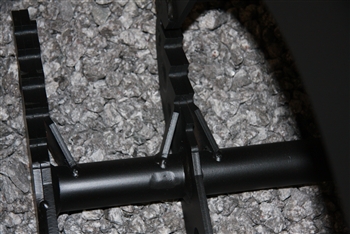

Would a pic of the Wicked Grapple in the buff help sway your decision? She's a beauty!
Travis
/ Help with decision on Grapple #9
Notice the laminated tines with no bulky gussets to prevent you from running the tines through the ground to grub roots/rocks. The rounded tube serves as a gauge to prevent excessive ground penetration that would hinder traction.
Travis
Here is a better look at the tines:
Travis
I do like the looks and engineering that went into it but is it $200.00 worth??? I don't know. Any more thoughts???
/ Help with decision on Grapple #12
Yes, more than $200 IMO. If you saw them side by side, you'd agree in a hurry.
