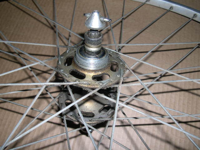

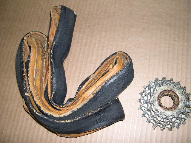

I took the rims to a performance bike shop today. They pulled the rear gearset for me, so I can get to the bearing(clean and repack).
The gearset is with what is left of an old tire...

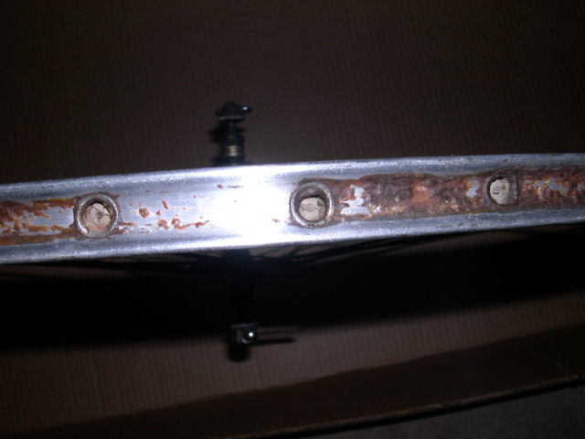

The shot of the rim has a small spot I have been able to clean, compared to the rest which is, well, old caked on glue.
The bike shop had a higher end Continental tire for $80. It was ready to run; the tube was sewn in already. I'm looking at other tire options... I'm just not ready for $160 to $200 for tires. Found some online(thanks Egon!) for a lot less; nice road tires instead of race tires.

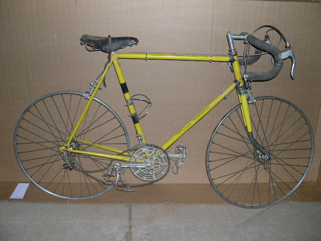

You can see the fingertip shifters. I think this is the only bike I have seen with those.
The rubber covers on the brake handles are shot.
Overall though, it is in great shape. Mostly dusty from being in the attic the last few years.
Tomorrow I'll work on cleaning the glue some more. I tried acetone. That seemed to work ok. Tried "Goo Gone". It did nt seem to work as well.

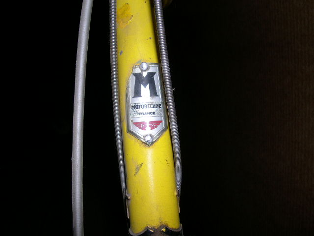

Hi Robert,
Are the Brakes Universal or Wienmann? I think Universal.
Looks like a French Stronglight crank as well. You are going to have fun rebuilding it. I love the "Nervex" lugs on the frames. They don't make them like that anymore - hand cut and filed lugs.
Post your progress -will be fun.
Lloyd
   / help with old bike
#18
Yes, you are right. Universal's and Stronglight crank.
Universals are, well, Universal's. Do you know if there is any story behing the Stronglight crankset?
