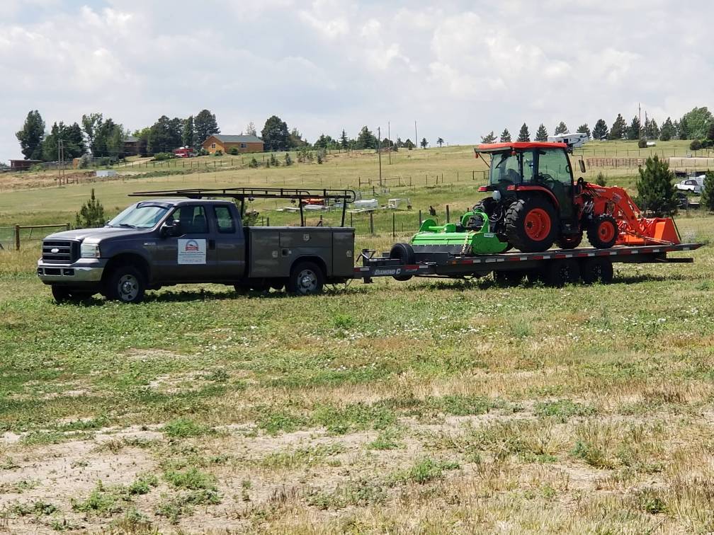

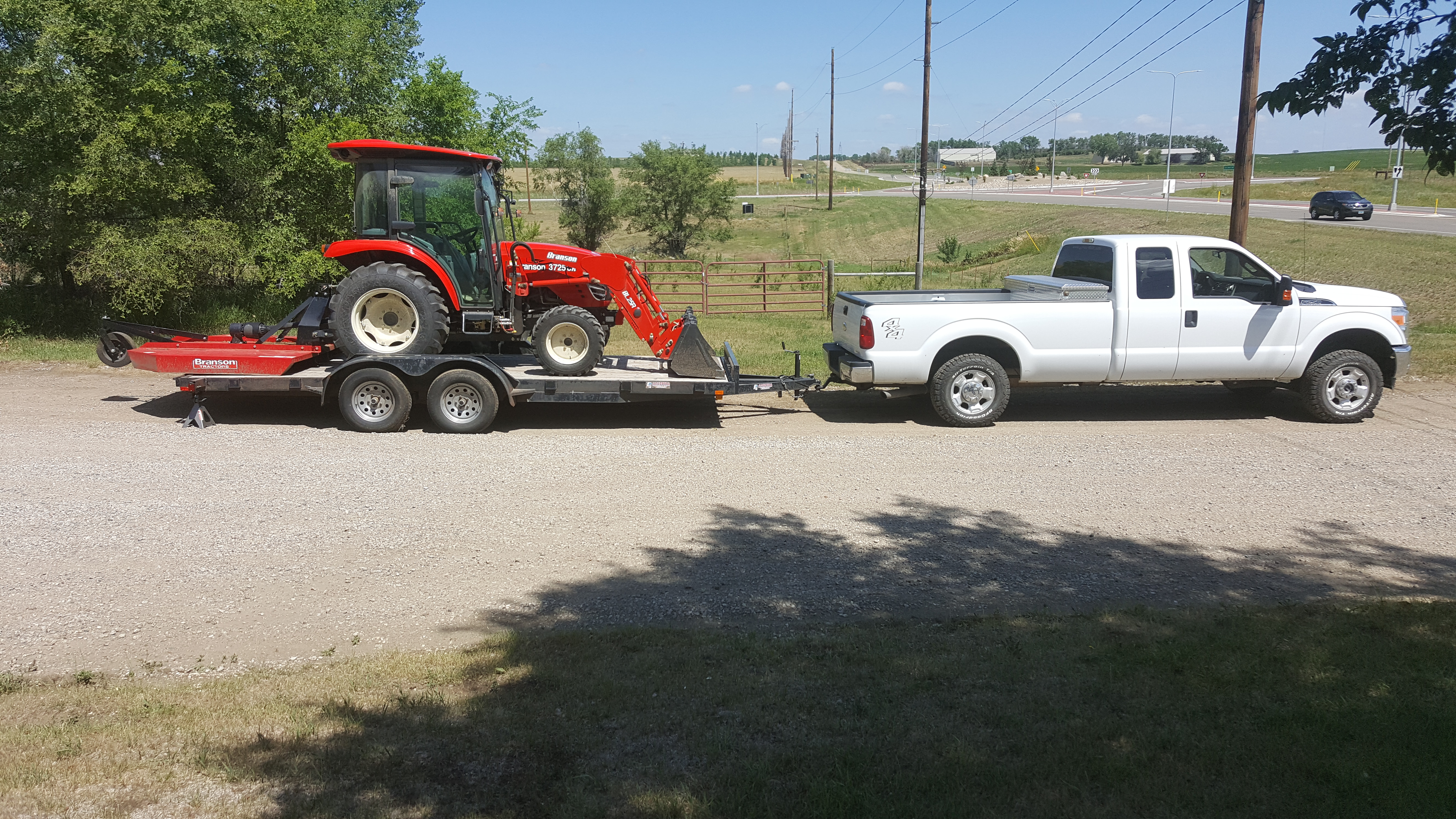

This is my tractor with brush hog on an 18' trailer:
As pictured, my tractor weighs just over 7K pounds.
I would not go a foot under 20' trailer, and probably 22-24', so you'll be "set" no matter what implements you have on.
If your tractor does weigh just over 7K as you say then your 7K trailer is way overloaded and 18' is too short. Your trailer alone probably weighs at least 2K which only leaves you able to carry a 5K load.
Which is why I have my eye out for a 30'-ish gooseneck.

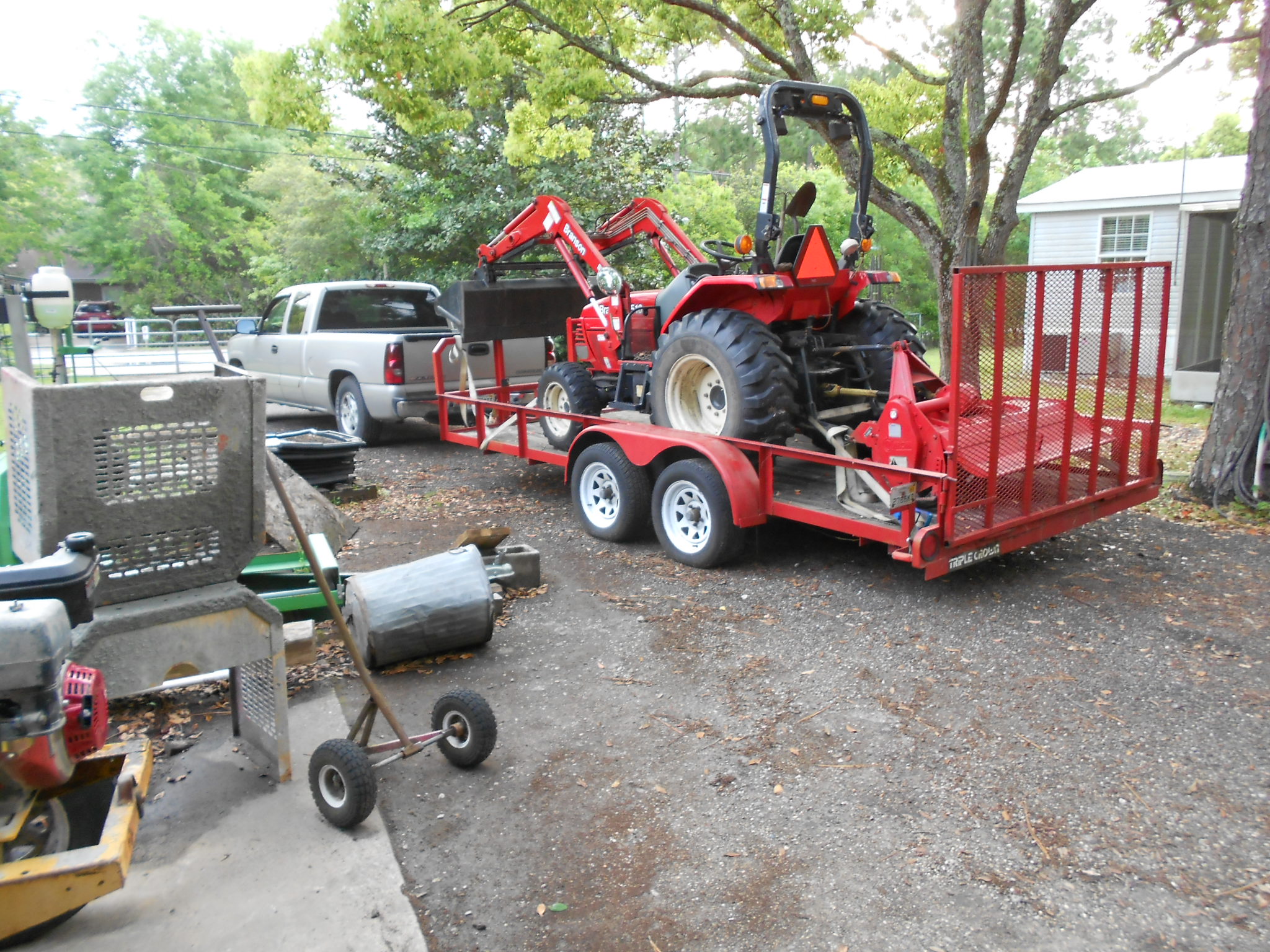

Here is my 35 hp Branson on my 16' trailer.
When I haul tractor with backhoe attachment I have part of the stick over the tailgate.
Tows really good.
I saw Rural King had a large selection of trailers at my local Gainesville Fl. store Sunday.
They had small to large steel and aluminum in the parking lot with prices clearly marked.
Make sure you get trailer brakes!
