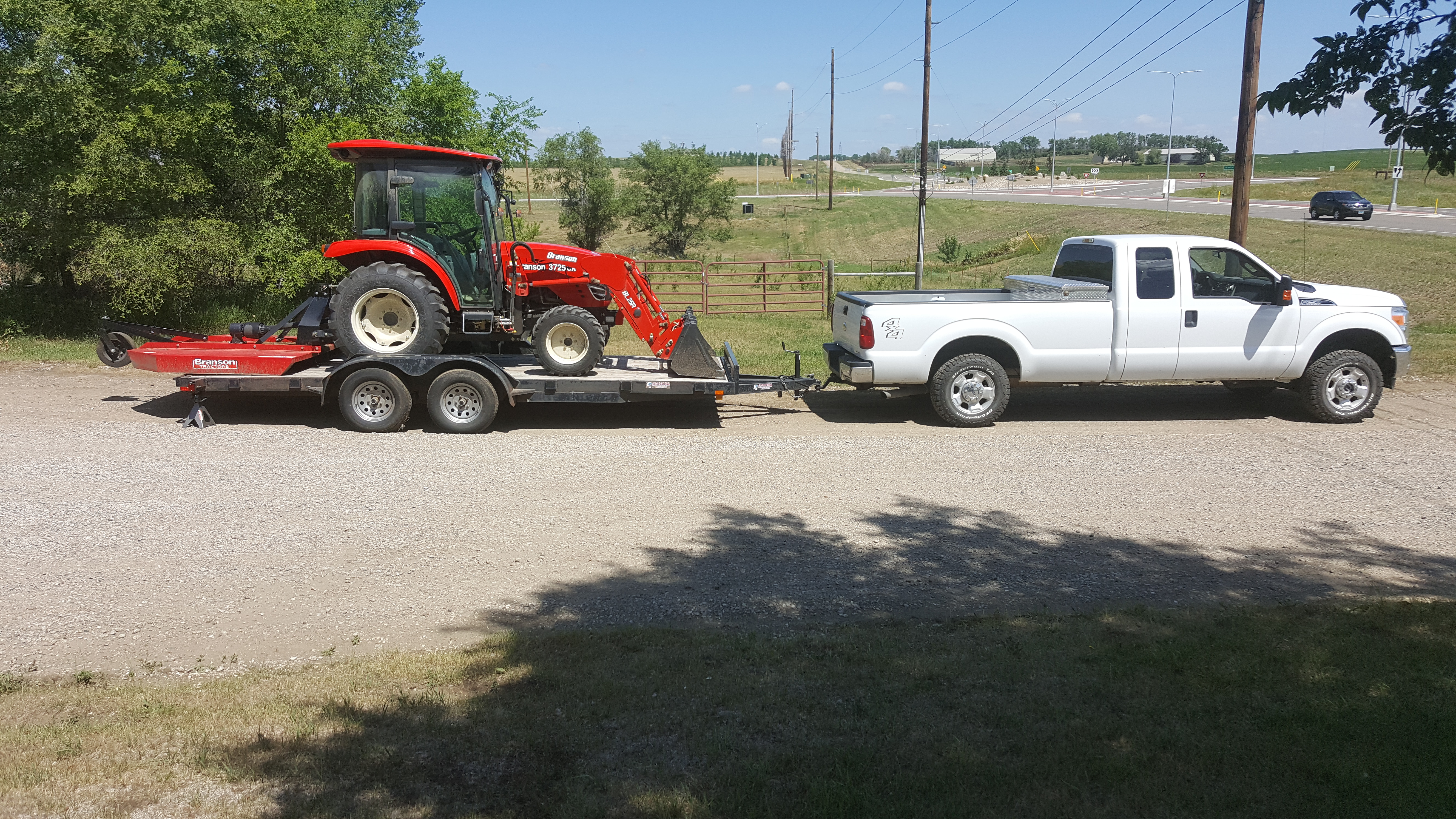

I recommend to a trailer that gets you just under the tow capacity of your truck. I have an F250 diesel and I am at 16k on a standard hitch/ball. Get a trailer that has a GVWR of say 14-15k. GVWR includes weight of trailer as previously mentioned, and in this class they will be a few thousand lbs themselves. So even with my F250 I am still around 10-12k of actual weight put on the trailer and tow. It really does add up quickly.
If you are ever going to be hauling more implements than the ones on tractor I do recommend getting more length. That also adds up quickly.

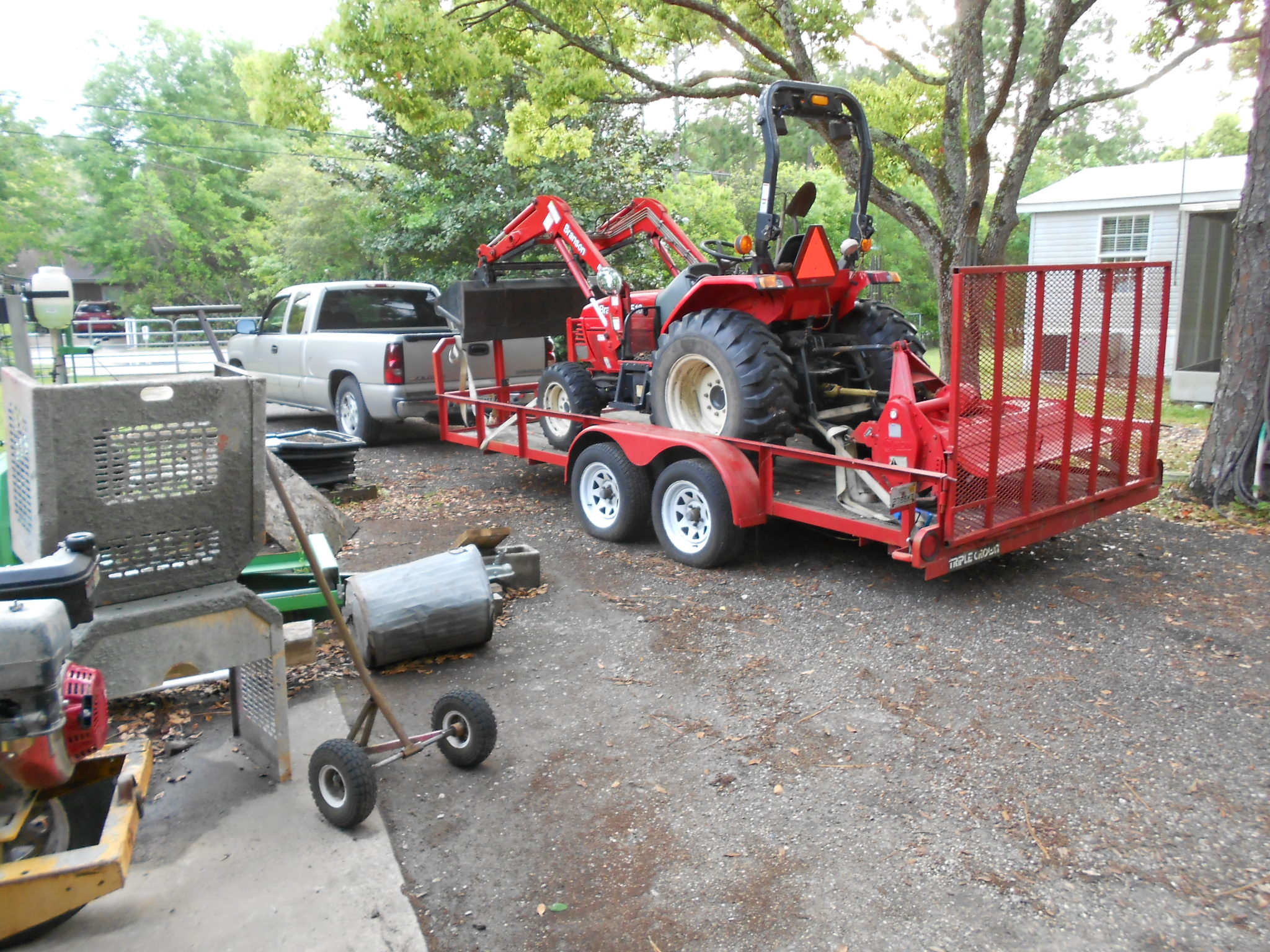

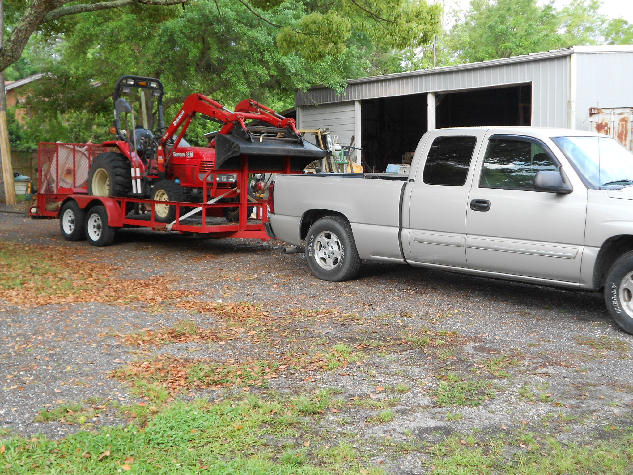

Some people can trade trailers and tractors, some of us tend to put a lot of thought into it, buy and never sell.

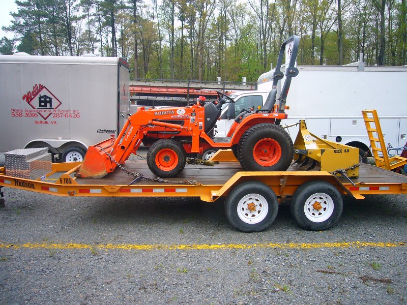

For my first tractor (B7610) back in spring of 2009 I searched high and low for something in my price range and feel I lucked out finding a 2007 package
for about 11K. The trailer was far more than I needed for the B7610 at the time. But it worked out with other things
For the trailer go as big as you can with your present truck within the parameters of wallet, skill and parking.
