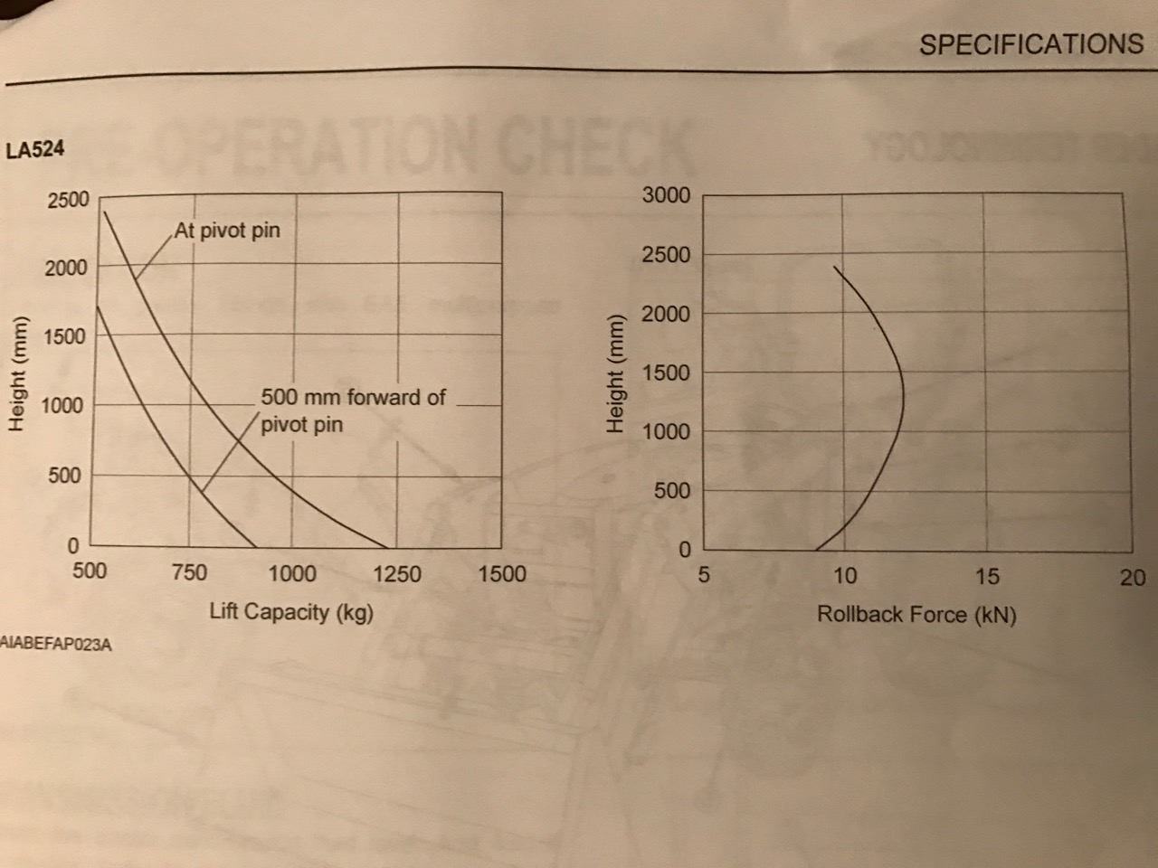

Does your loader manual have a lift curve?
   / Here are the ACTUAL Lift Capacities of the RK24 L75 FEL @ Varoius Heights (w/ Graph!)
#23
Correct. It dont account for being stronger at the bottom. But does give a good average value for what the loader lifts.
No. My comment was just in reference to an earlier reply about loader lift curves being more parabolic in shape and without the flat spots my original test showed.

Here's a typical curve:

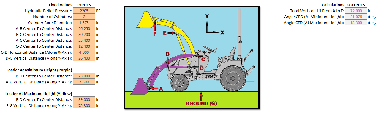

Here are the measurements I took tonight.
The relief pressure was listed in the manual.
I ran a few calcs (on the right) but I'm not sure where to go from there with calculating the forces.
It's been a few years since my statics and dynamics classes in college and I'm afraid I've forgotten a lot of it. :-/
Thanks for the help!

The first step is figuring the angle in which the cylinder's force is applied.
This isnt the angle with the ground, or any particular point that is easily measured. Thus the triangle measurements is all aI need. Knowing the Lengths of the 3 sides I can calculate the exact angle. (look up law of cosines for formula)
So we want to focus on triangle BDC, and in particular...we need to solve for angle B. And then EDC (when raised) to again find the angle of the cylinder
Law of cosines is a PITA to actually type out. I'll trust you can apply the numbers on your own and solve for angle B and E when raised? if not I can attempt to spell it out.
I come up with 21.08 degrees when lowered and 15.3 degrees at full raise.
________________________________________________________________________________
Step 2....Find the force of the cylinder.
40mm bore @ 2205psi = 4295 pounds of push force PER cylinder.
But cylinder mounted on an angle. To account for that, the vertical component of the lift force is the Sine of the angle.
So. Sin(21.08) x 4295 pounds x 2 cylinders =3090 pounds vertical force
....Sin(15.3) x 4295 x 2 = 2266 pounds vertical force at max lift
_______________________________________________________________________________________________
Step 3: The above is the lift force where the cylinder attaches to the loader. Now we need to figure how that relates to the Pin location
Now it becomes a lever......A-B-C with C the fulcrum, and B where the force is applied......At point A....you have 0.539% of force applied at B.
So at ground level, 1665#
At max height, 1221#
______________________________________________________________________________________________________
Step 4. This is a bit tricky to "actually" measure. Especially without a force gauge. And that is Just how much does the weight of the loader/bucket take away from the capacity? IT can be measured with a pressure gauge and reverse calculated. But given the "spec" is 947# to max height....and the cylinder force NOT accounting for the weight of the bucket/frame is 1221#....I'd say that's pretty close.

Wow, thanks for all that!
A couple of questions, both regarding Step 3:
1.) Did you mean 53.9% (aka .539)?
2.) For the ratio of the 2 levers, I agree that the C-B distance should be used, but shouldn't we be using the C-A distance as the length of the overall lever? (Instead of using the sum of C-B & B-A.) That would be the true radius, would it not? This would change the 53.9% to 55.4%, which in turn would increase the results slightly. 1712# & 1256# respectively.
