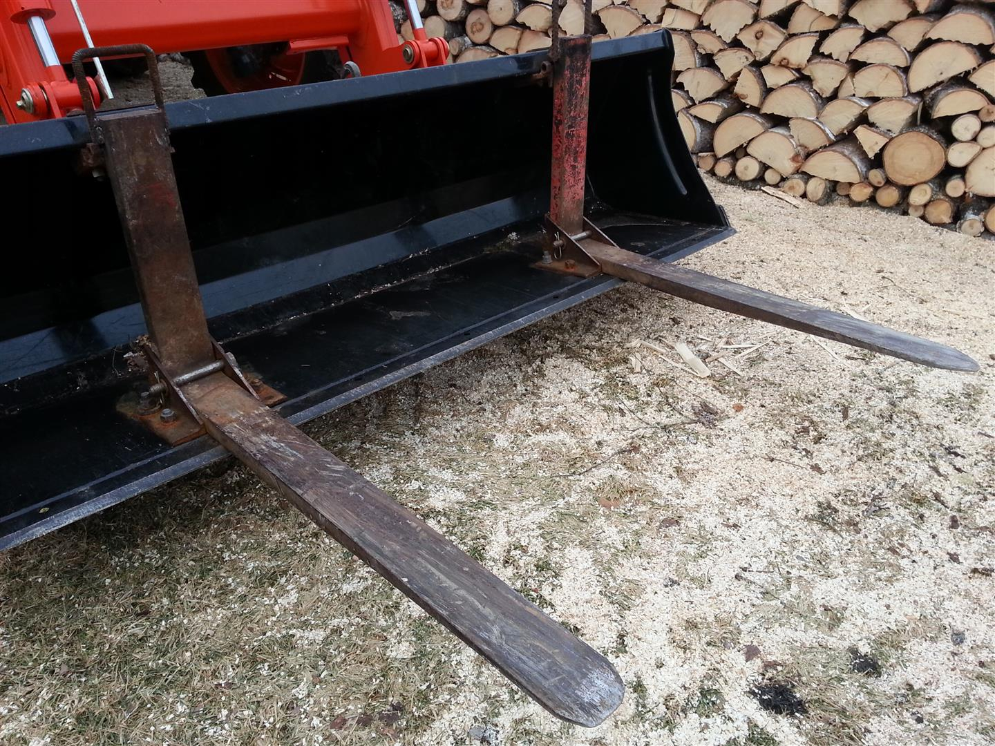

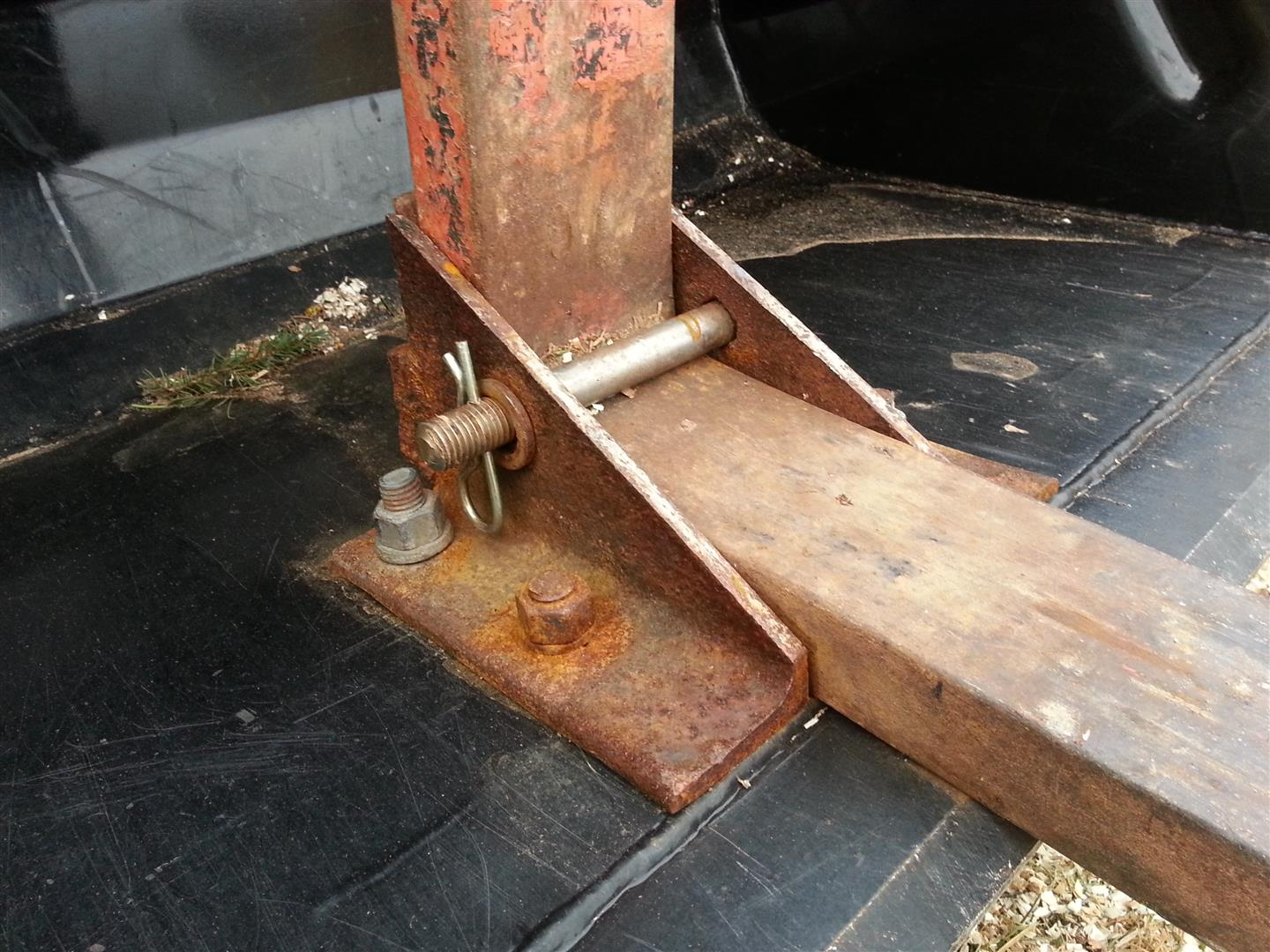

If you do get the 7320 it comes stock with a self-leveling bucket. I would have preferred a standard bucket because I have 4' forks that attach to the bucket with one pin for each fork. This allows one to drop the forks in the woods, do some FEL work and then pop the fork tines back on to bring home a cord of 12' logs on the forks. However, the self-leveling bucket changes the angle of the forks as the bucket goes down. Start the forks down at a 60° angle and they tilt up as the bucket goes down. Also, the self-leveling bucket lip has more up/down movement than the standard bucket because the extra linkage for the self-level allows a little more movement, and when cutting off 3" of soil the bucket lead edge angle is critical. Don't get me wrong: it still works well, but I would prefer the standard bucket.

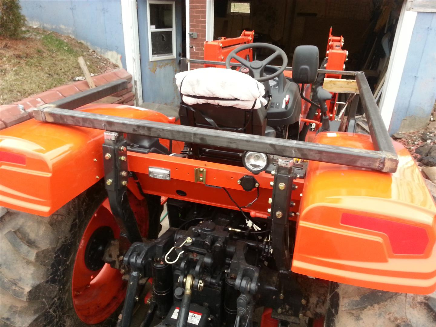

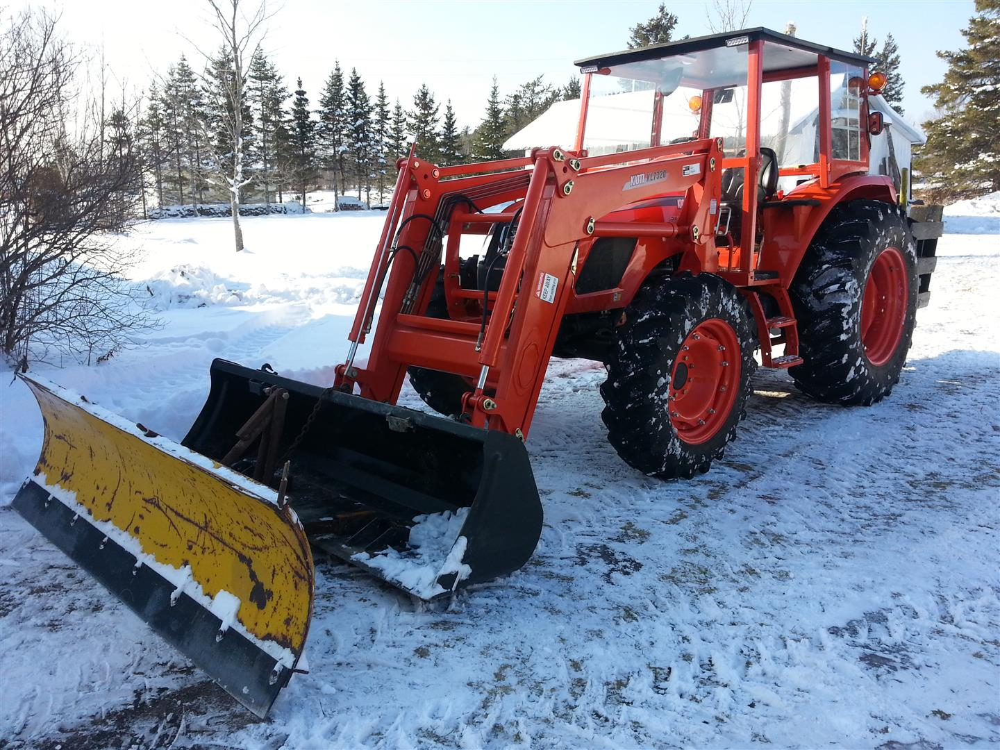

My tractor shed has an 8' high door, so I saved $10K by building a low height tractor cab ($1000) that drives right into the 8' shed (the factory cab is almost 9' high). I leave the side door off most of the time to allow easy in/out when cutting wood. It gets down below freezing most of the winter here, but you have to dress warm anyway so the door is not missed. Also, with the door off, the windows don't fog at all when pushing snow.
One thing that Kioti does is drive the front wheels (in 4WD) 7% faster than the rear wheels. This allows for easy steering when turning, but you can tell the Kioti is working a bit more in 4WD than a Kubota that run the front wheels only 3% faster. The 7320 has an electromagnet clutch, so it's a simple fix to only engage 4WD when on slippery ground, which really should be done with any 4WD tractor.
The 7320 rear ag tires are 18" wide, so they carry up well in snow. It will drive through 2' of snow and is barely pushing any snow with the front axle. There is a lot to love about this Kioti tractor, not least of which is the down-to-earth dealerships. The 7320 engine has a great pollution control system also. If you keep your RPM at 1500 or above you may never have to do a manual regen. It is fuel efficient and starts at any temperature above freezing without the glow-plug. It starts without a block heater at 0°F with no engine smoke.
