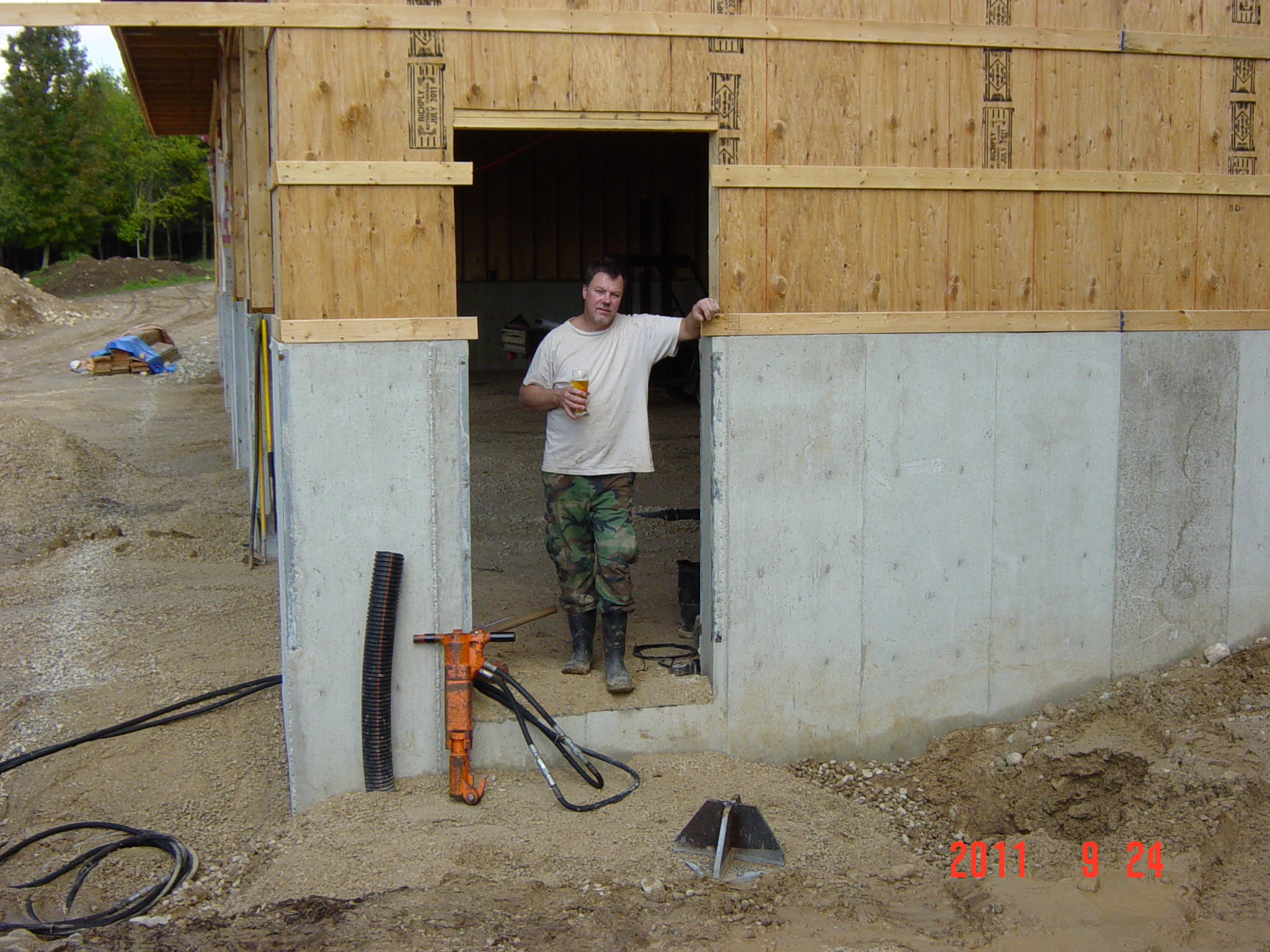

/ HF 70lb hammer and tamper #26
I need to do a good deal of tamping. I don't rent tools, I buy them or I make them. I have a HF 70lb jack hammer which has treated me exceptionally well over the years. I've been looking for second hand tampers and they're $800~ locally, which is a bit more than I want to spend. Then i came across a tamping bit that would fit my hammer, but I was afraid that the additional weight of the bit might be hard on the motor and shorten it's life. Has anyone considered something like this?
This is the bit:
https://www.homedepot.com/p/TR-Indu...0-Series-Demolition-Hammers-TR-TSTP/306721755
Over the past 65+ years I've had the opportunity(???) to use just about every type of compaction equipment made. from a 10x18"piece of an ash tree with 2 handles nailed on it, to the biggest Cat articulated tandem vibratory rollers built. I think that if from time to time you have a fair amount of tamping to do, after about an hour on your Home Depot hammer tamper, you'll be wishing you spent the extra $300 and got the Home Depot Yardmax plate tamper; https://www.homedepot.com/p/YARDMAX-1850-lb-Compaction-Force-Plate-Compactor-YC0850/302634932.
They're even cheaper on ebay. You might even locate a Whacker type plate tamper with a bad motor and replace it with most any kind of motor.
Here's a ground pounder with no spark for $200 M-B-W R27 Ground Pounder Tamper Rammer Plate Compactor Walk Behind | eBay They are a good machine, better than a plate in tight trenches around manholes, footers etc. They're more work to run, but a lot easier than your jack hammer, plus you're a lot less likely to stomp your foot.
You said you build some of your own tools as do I and plate tampers are really a pretty simple machine, just a steel plate with an eccentric rotor, driven by a belt from a spring isolated motor mounted on another plate above it.
