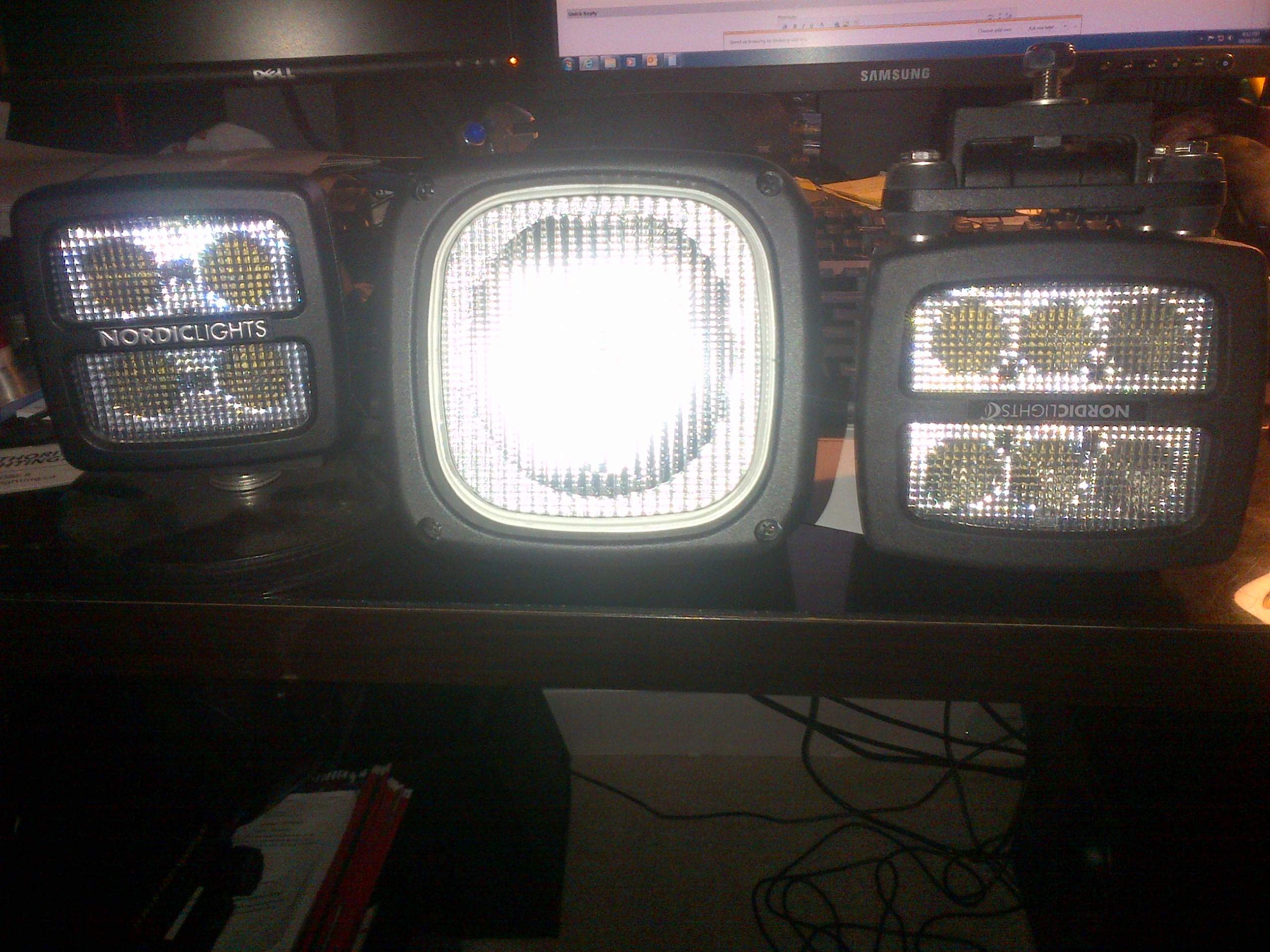

Here is a picture of my desk showing size-wise the differences between LED and comparable HID lights. (and TBN in the background)

There is no comparison to HID lighting. There is not a LED that is affordable that will give you the light of an HID. They are worth every penny.:thumbsup:
