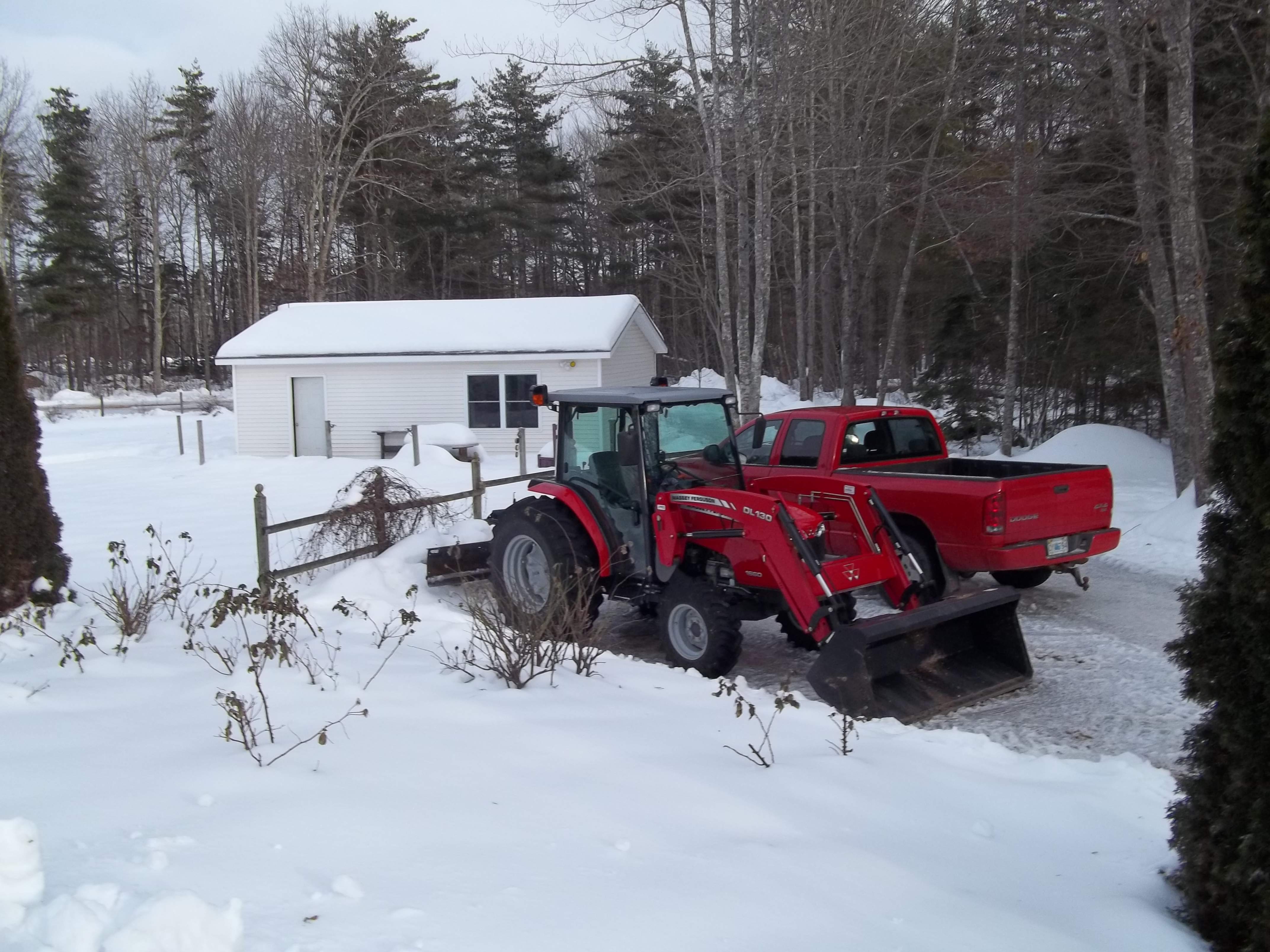

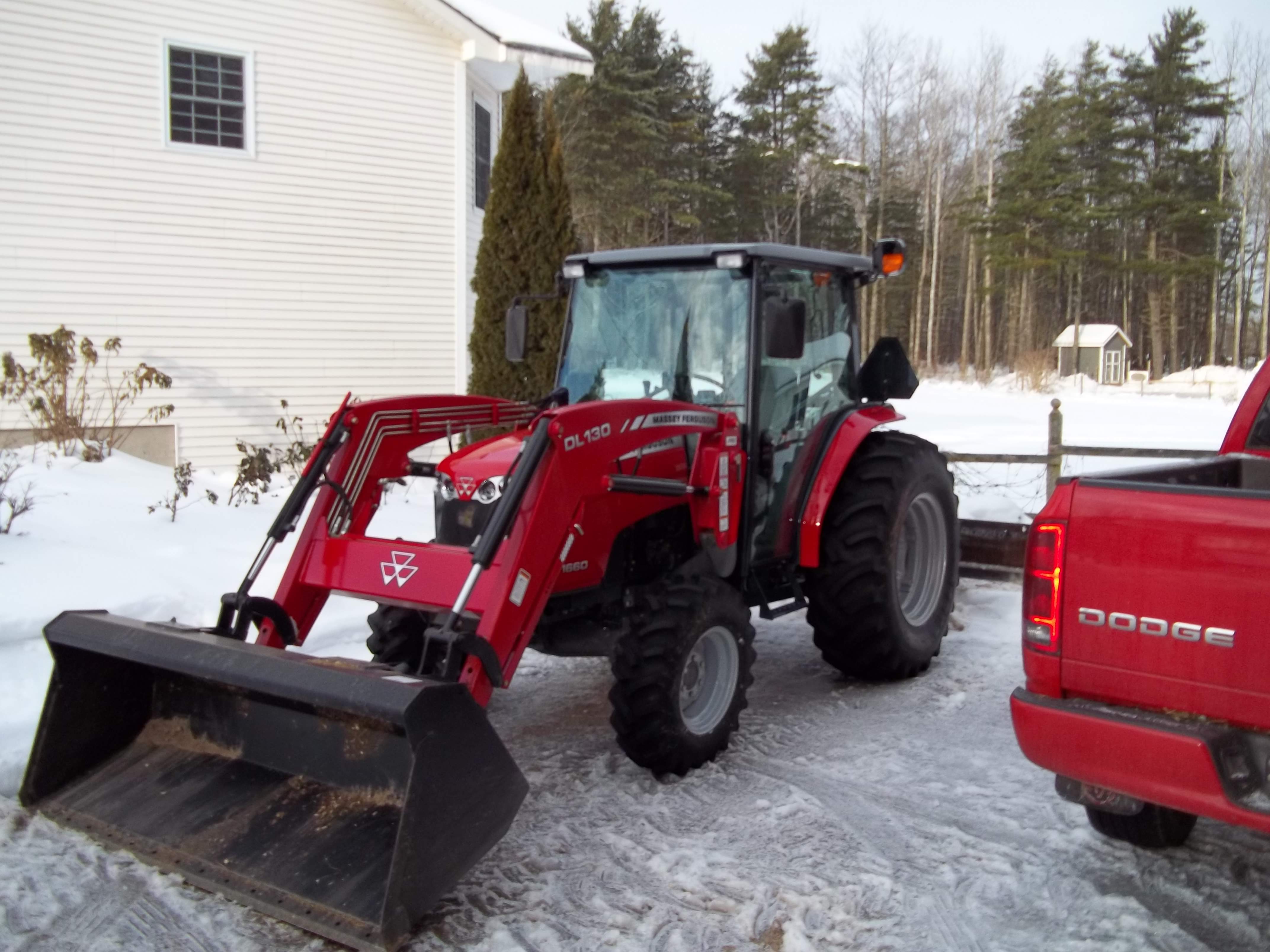

Frame size wise, what size Kubota or Deere frame does this compare to? Is it more like the L5740, M7040, or M8540?
I love the sounds of that QPS transmission but I didn't think they offered it in a smaller sized tractor.
For the frame size here it is next to my 1/2 ton Ram 1500.
From what I've read the QPS won't be offered in the new 1700 series, which is replacing the 1600 series (tier IV). So far I have no complaints at all with it, great range control, 12 speeds, smooth transitions from forward to reverse and a lot of grunt when I've needed it.
