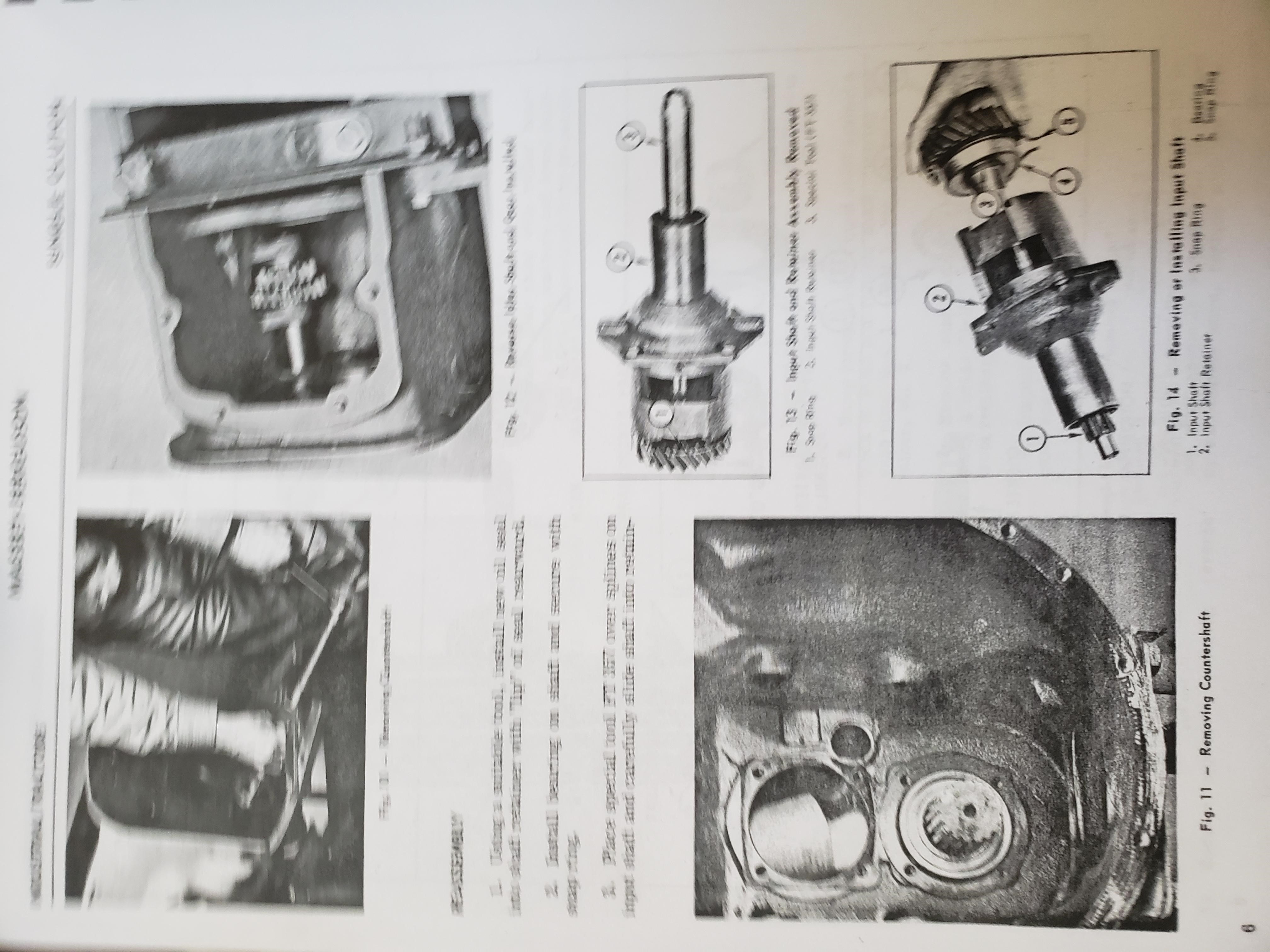

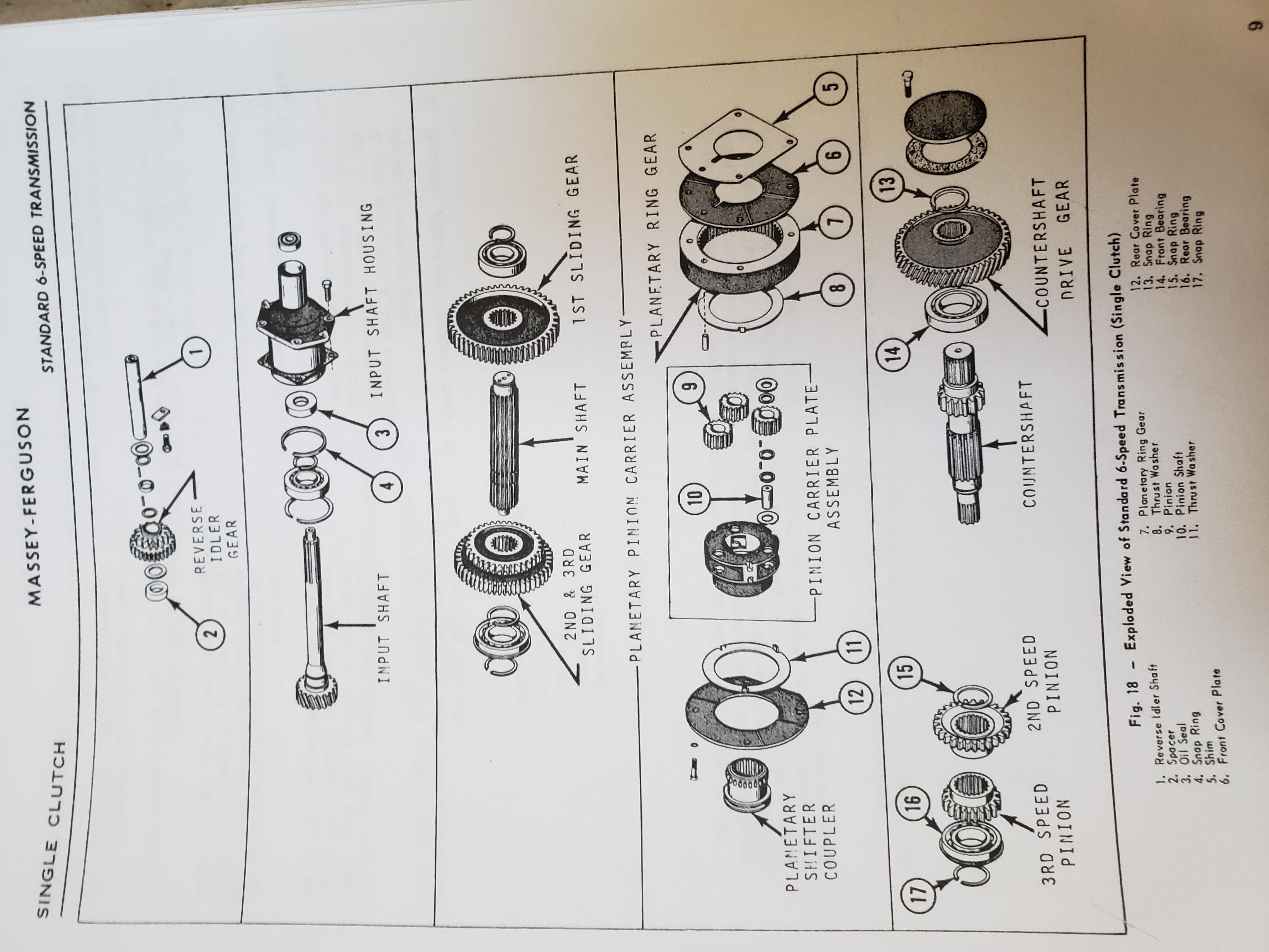

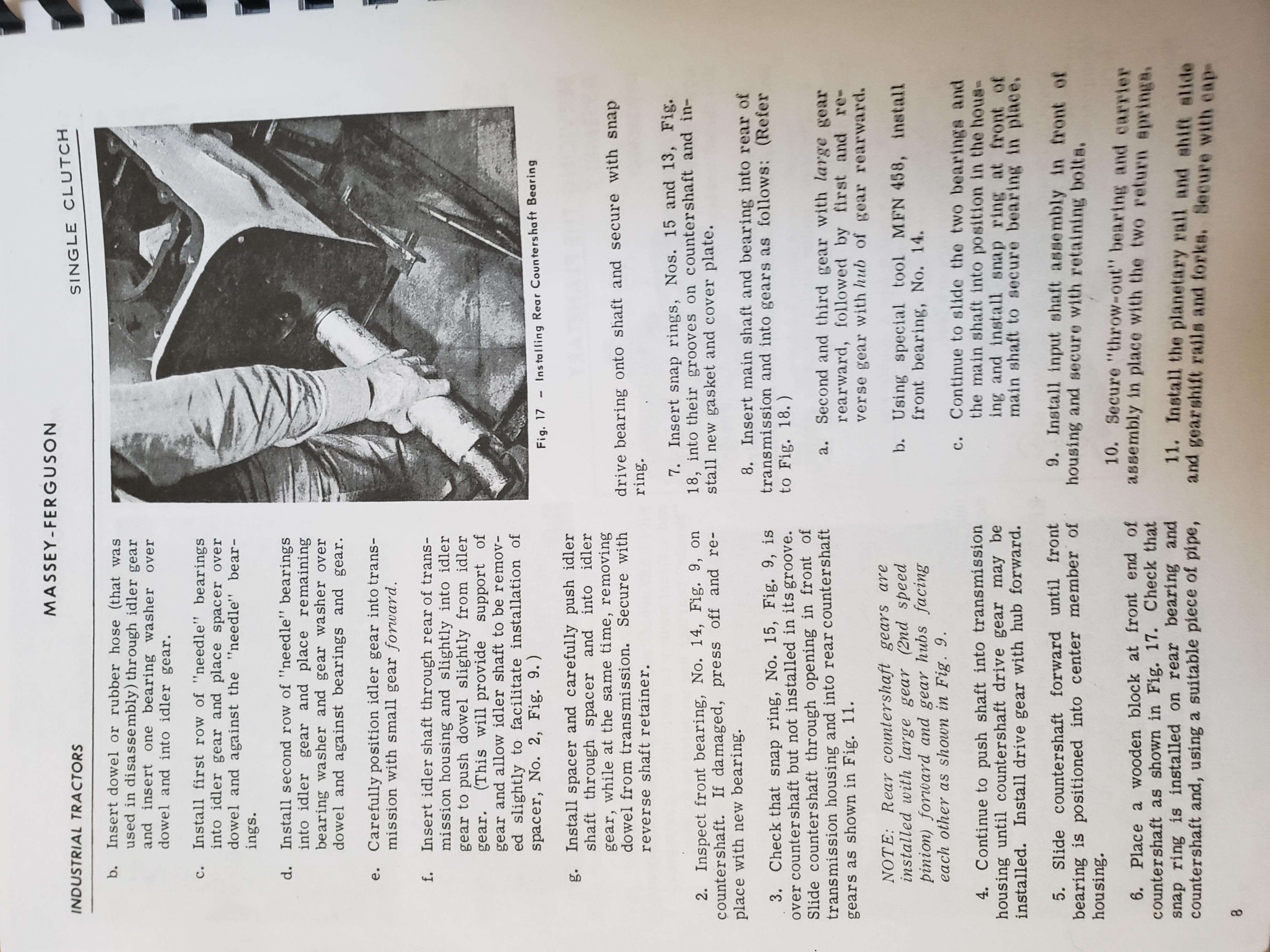

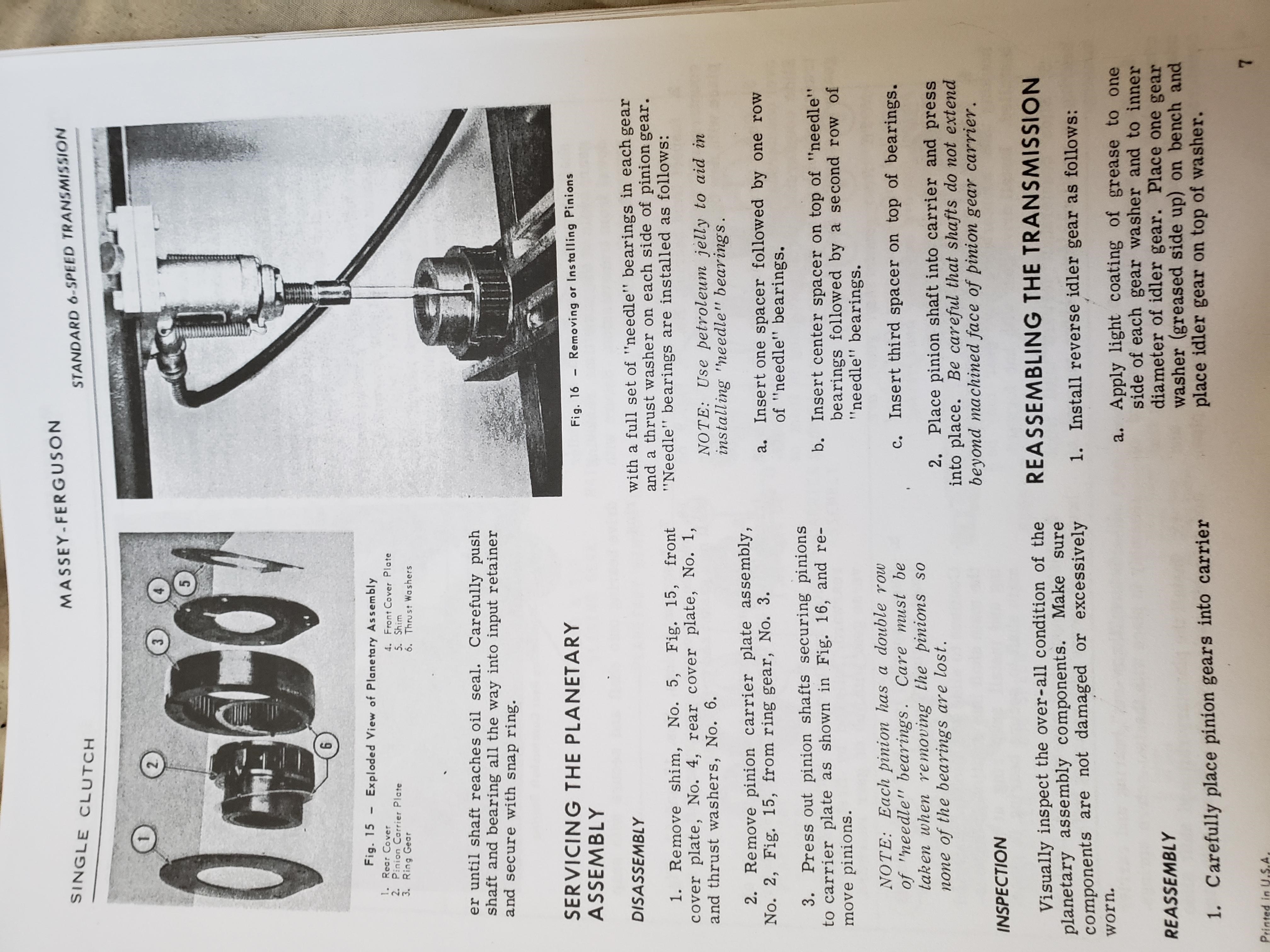

On the first page transmission reassembly starts the on last paragraph. Just showing
Here are four pages of transmission assembly out of my 203 manual. Its an example of what your manual will be like. NOT the book for your tractor. I hope the pages enlarge enough to read.
All your tools and-
A good set of snap ring pliers
A set of picks
small screwdrivers. Picks and small screwdrivers tp assist in getting under snap rings. The beveled edge snap rings are a little tricky. patients! Careful the snap rings can slip off and go flying. Safety glasses. I'm sure I missed needed tools.
Vaseline to reassemble needle bearings This is a 203 transmission. $52 for my repair manual is priceless , almost.
Make that work area a place to enjoy. Doing repairs is just part of machine ownership.
Sorry about horizontal pages
Page 2 is blurry
