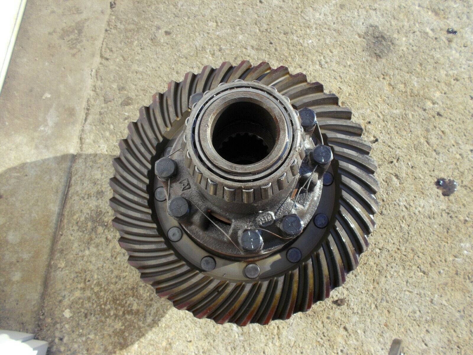

Says for TO35 on the part. I count 40 teeth. It could sell at that price. shipping is high. but it will fix you up.

You can check partsnumbers, might just be the gears, and don't rule dealer out, sometimes they are cheaper than the pirateparts online.

with your tips and encouragement the pinion and ring and actually whole differential with bearings were obtained thru EBAY and I put it all back together. I am hearing a concerning noise especially in the left wheel/axle so I am not using it to work until I get some help replacing the bearings and seals at the wheel ends of the axles. Saw the procedure of chiseling off the bearing collar and slipping on a red hot one. I don't have a press nor a torch so I am enlisting a local old tractor mechanic to help me with that. Those were some heavy parts and it helped to have the reassurance of you all and actual video of the same tractor on Bundy Bear Sheds. Good quality video and sound with a nice downunder attitude and accent made it work well for me. Thanks again!

Did you buy a whole differential with the casting or just a gear setup with bearing unit like pointed out on ebay?
With all the alignment and setting gear clearance a whole working unit was a good idea.
Removing the old bearing race can be done with a die grinder or dremell with a thin cutoff wheel. Cut most of the way through the race then a sharp hit with a hammer and chisel and the race will break where you ground the groove. That's just my method. Sometimes I use heat if its convenient.

OK, so you guys are relentless on getting me in over my head! My hand got twisted by my drill motor while drilling out the old pinion rivets, so I'm trying to get that strong again. If the mechanic doesn't call me back I will probably take things apart and follow your suggestion. Just seal and bearing and collar that holds bearing into place? Do I need a press to get the old bearing off? You asked about the diff assembly and yes that is what I did and it was therefore unnecessary to hurt myself drilling off the original ring gear from my diff. I found one gear with the replacement diff that had a different number of teeth than what I needed but my original one fit and was in good shape. Thanks again for your help. I'll post outcomes when I get to the next steps.
