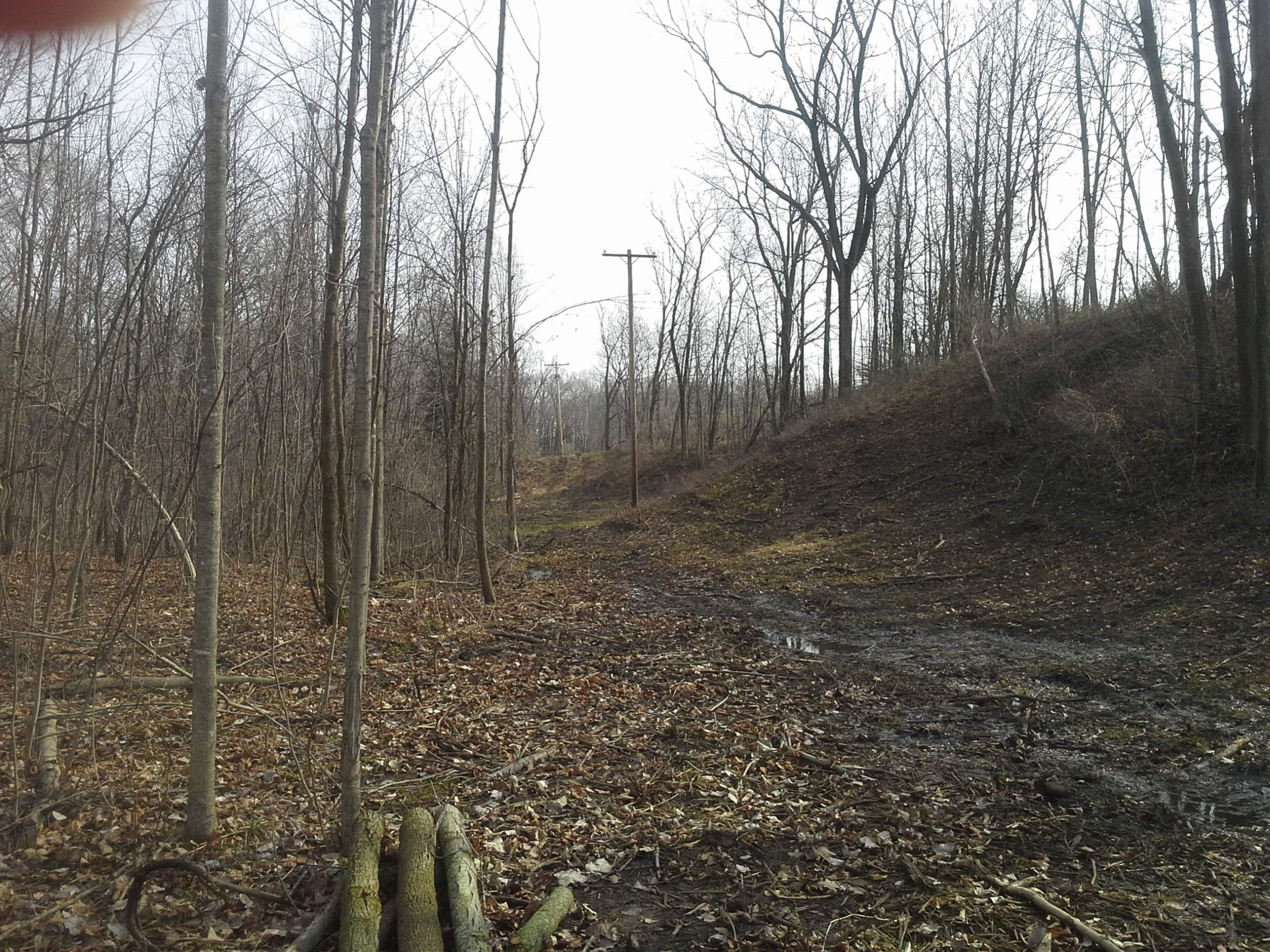

I'd suggest chains on the rear tires and as much weight as you can get in the loader's bucket. Personally, I would not depend on the differential lock...once traction is lost on one tire, a differential lock isn't going to guarantee adequate traction on the other tire...both might spin. Then low gear, seat belt on and going up slow and steady.
Now, if I'm looking at those pictures right...it doesn't look like a steady slope...seems to be a bit of a rise, then pretty steep at the end...is then correct? If so, I use the tractor to drag the logs to the beginning of the steeper section, then winch them up the steep part from above.
To me, the worst scenario would be getting halfway up that steep section and getting stuck (log digging in, for example) Logging winches lift the end(s) of the log up a few inches to prevent this. Your 3PH might be able to lift the end, but that will raise your C of G...so, again, front ballast is essential.
Your 1700 weighs about 2300 lbs plus the loader...figure about 3000 lbs total. Any of those logs that look to weigh more then 1000 lbs...might be worth cutting them in half....make it easier to skid them up that slope.
Another suggestion is have someone else there...just in case.

re: taking the hill grade down with the tractor & box blade, How do / did you compact it enough that erosion didn't become a problem. That's why I was thinking dozer.

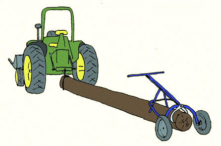

Dont forget a log arch can solve this problem. Now that we know you probably can't lift the logs in the FEL.. You can use your snatch block idea but using a log arch your logs wont drag in the dirt, with wheels on both ends. I would probably try to make one first.

Now, if I'm looking at those pictures right...it doesn't look like a steadt slope...seems to be a bit of a rise, then pretty steep at the end...is then correct? If so, I use the tractor to drag the logs to the beginning of the steeper section, then winch them up the steep part from above.
Good eye, you're absolutely right. Thanks for the tip. Would using longer rigging, so the tractor is on the flat at the top of the hill by the time the logs hit the steep section, work the same? There's lots of room to run at the top. I also was thinking this set-up would give greater leeway in backing down if traction became a issue. The black walnut will be the only ones I can't cut down and will have to drag as they're saw logs. The ash is just going to be firewood so i can cut them to short lengths to reduce weight.
Well isn't that just the Cat's meow! I'm embarrassed to say I'd never heard of this before. I inventoried (50) trees today, all 16" DBH or larger. A Log Arch just moved to the top of the list of must haves. Thanks!

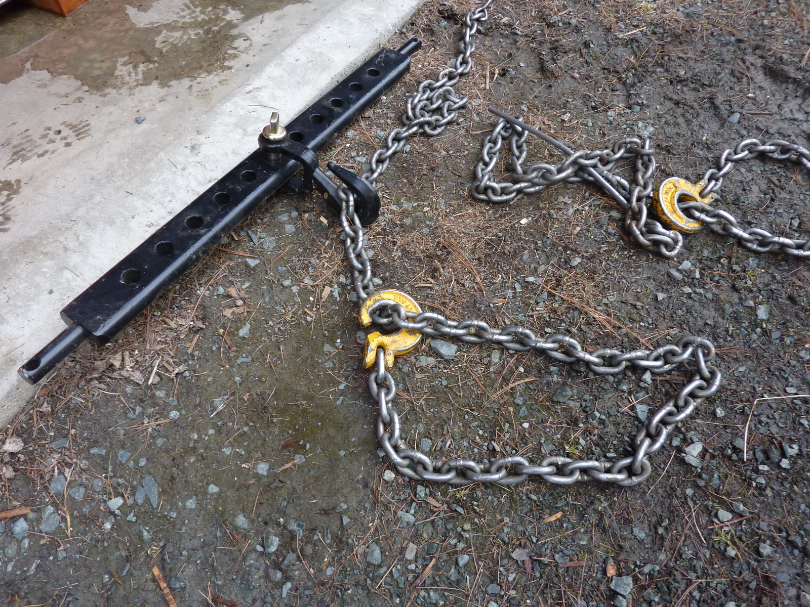

Hmmm. My previous tractor that I had for 25 years was exactly what you have. I can tell you from experience - the easiest and SAFEST way to get those logs to the top of the hill is to put one in the bucket and chain 2-3 together and drag them up the hill with a chain or cable attached to the drawbar. DO NOT use the 3-point to pull a load up the hill. Use nothing higher than the drawbar (ex- don't use FEL or 3-point) to pull the load up the hill. The logs could change position(roll) and very quickly you & the tractor could be in a side pull situation and get pulled over and down the hill.
I had a pto winch which allowed me to have 250 feet of 1/4 inch cable. I pulled one log at a time strictly for safety sake. The winch was attached to the 3-point and drawbar. Tight to the drawbar, loose to the 3-point. It pulled on the drawbar and was kept in alignment by the 3-point. It was a Koenig winch.
