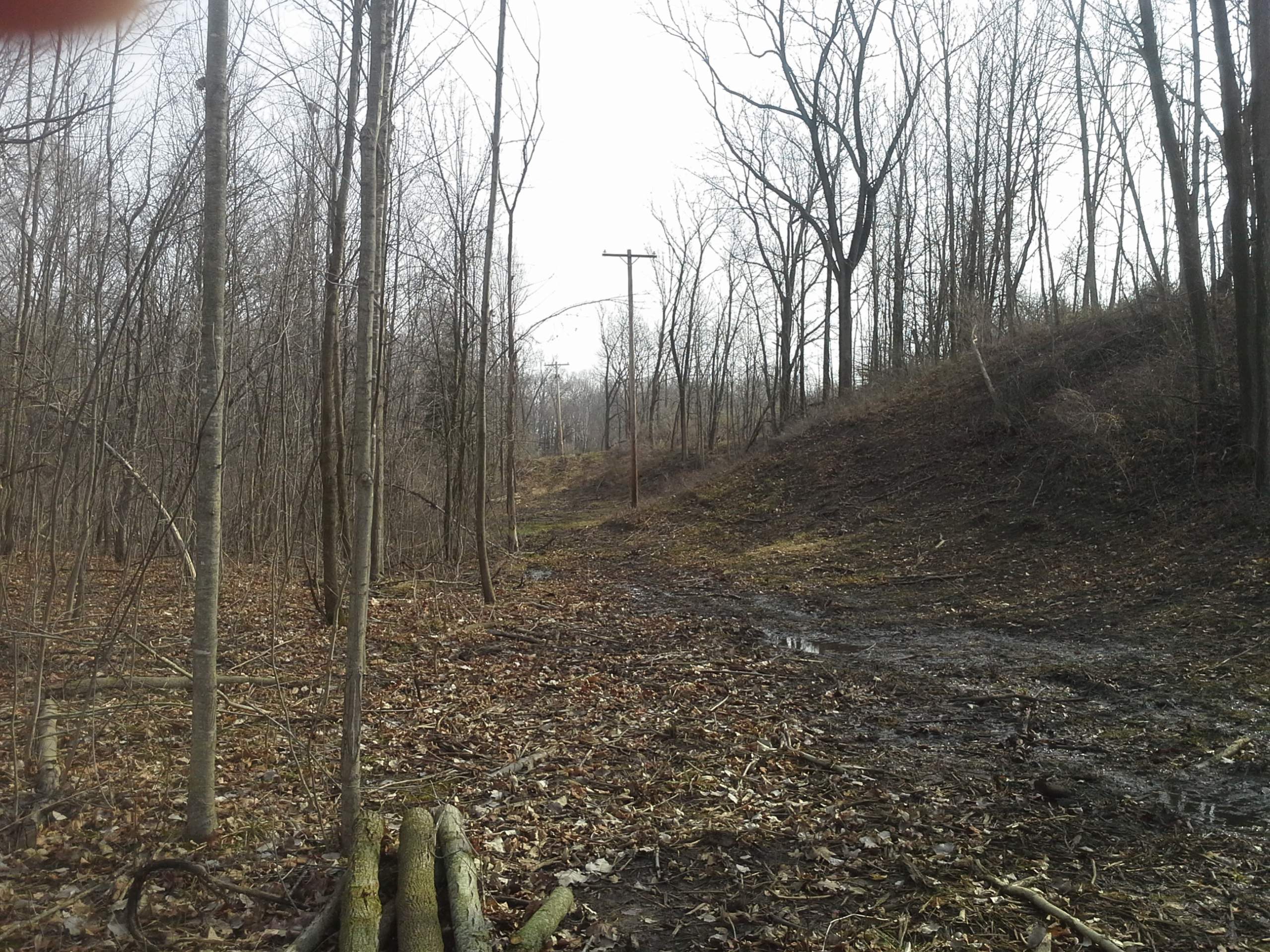

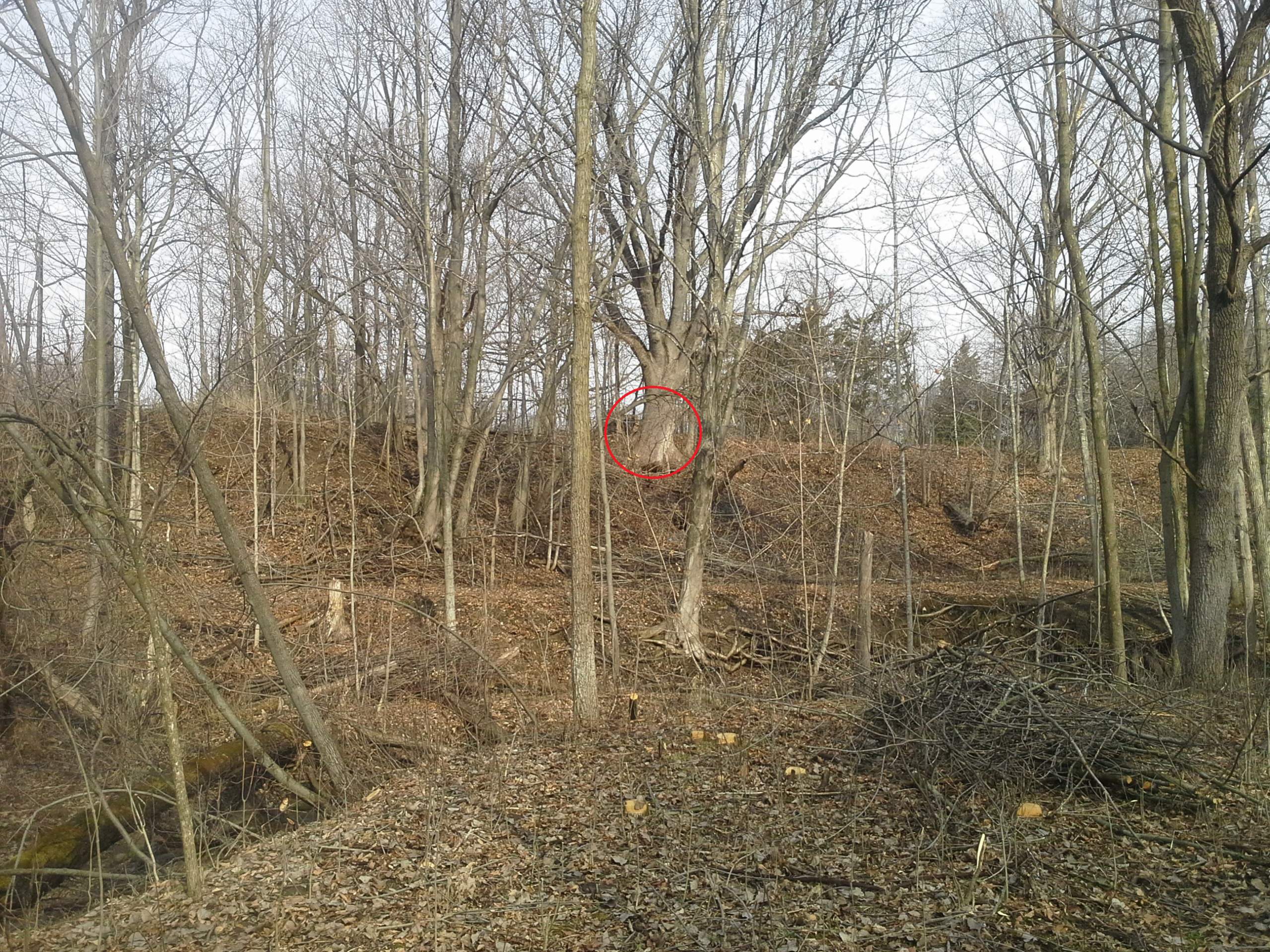

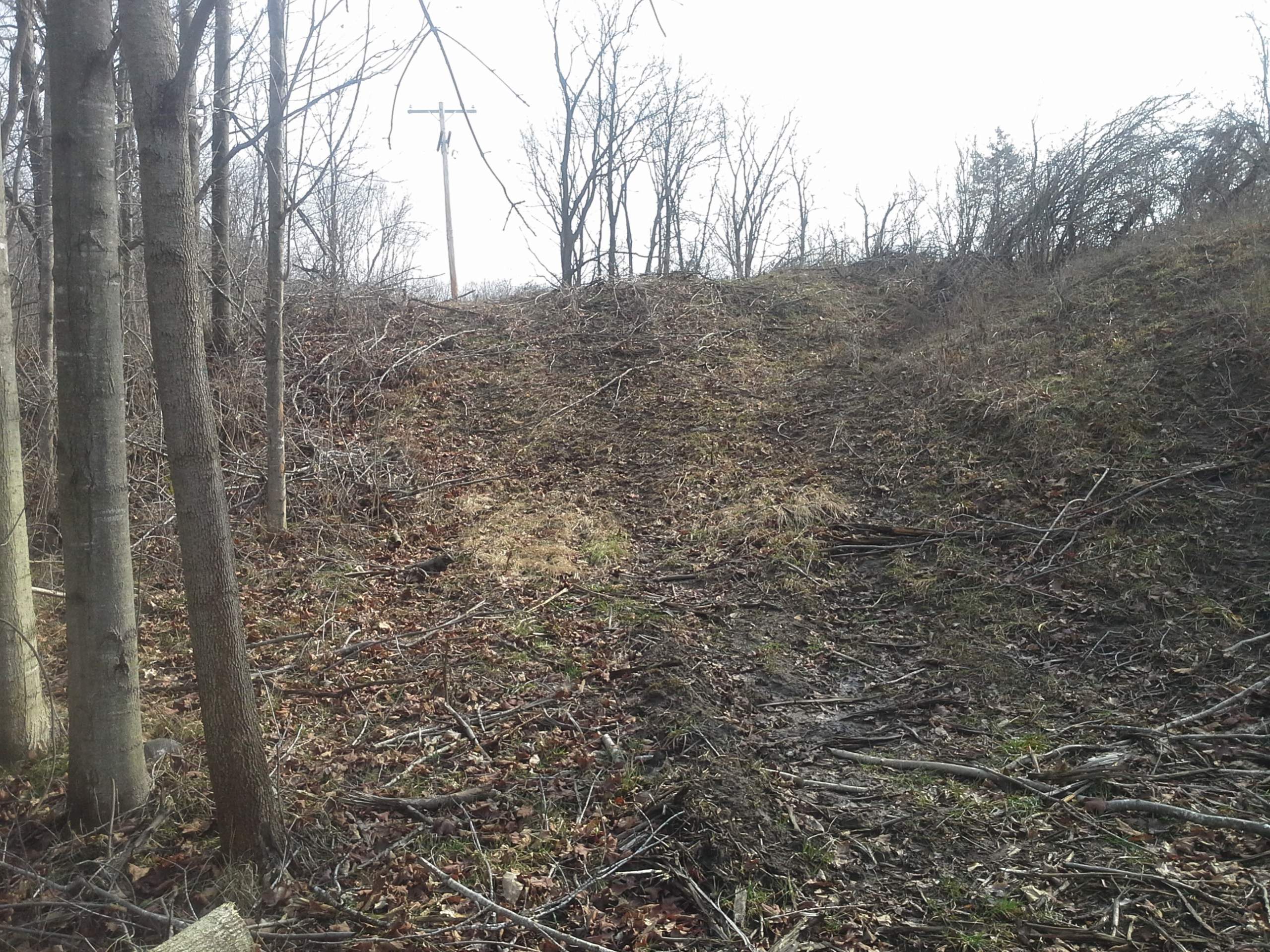

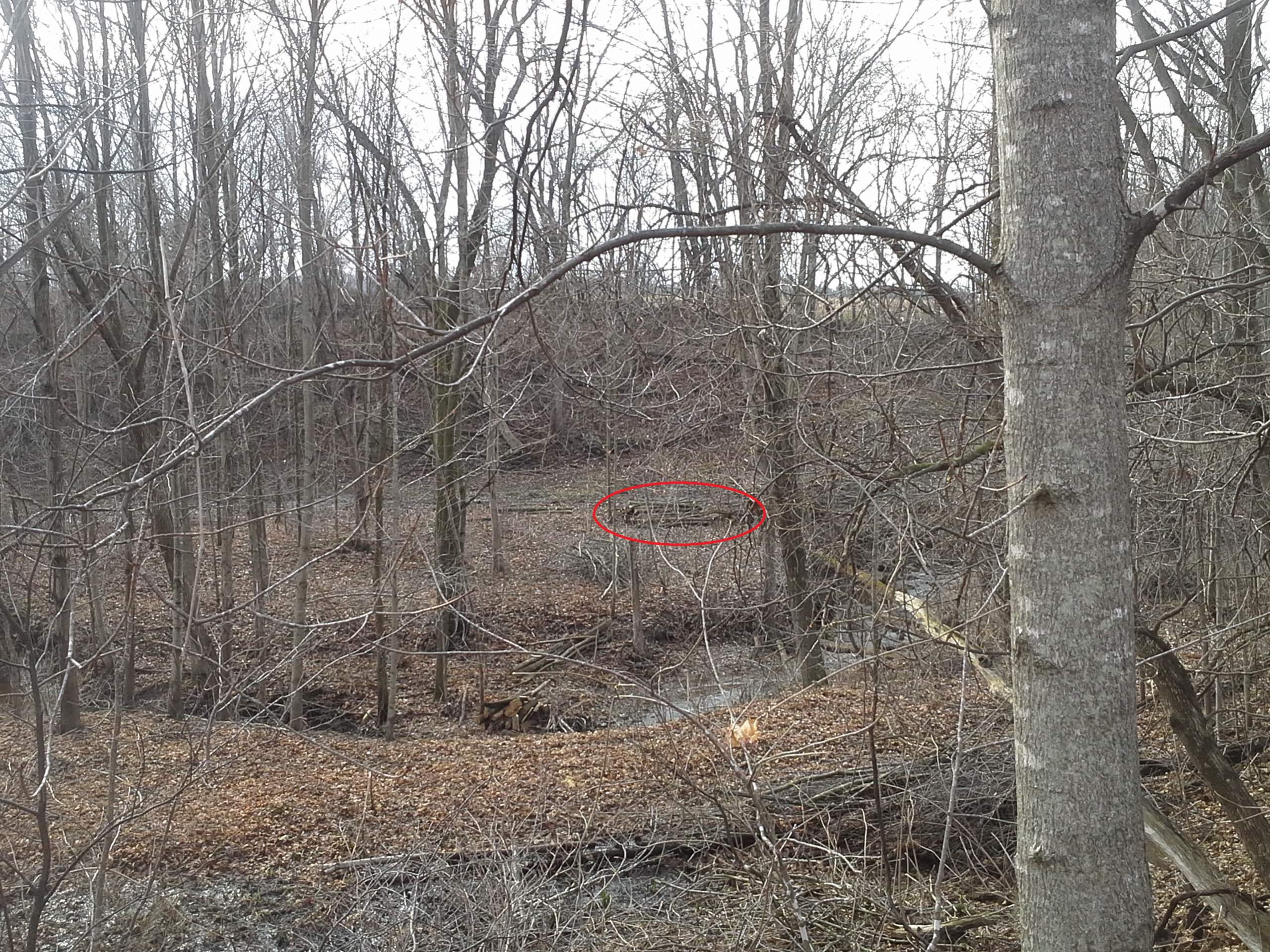

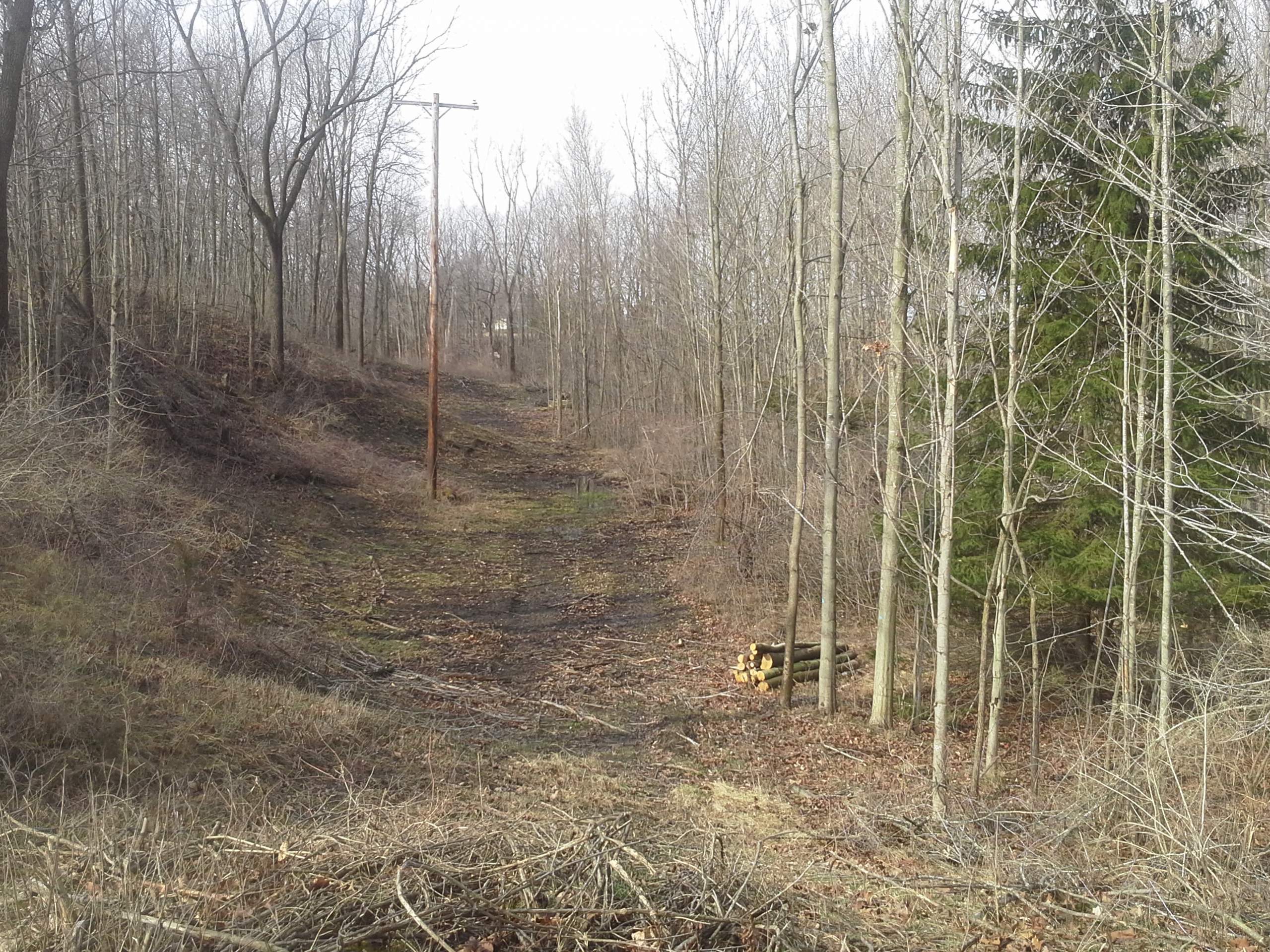

A good rain yesterday has put conditions back to marginal. That's good, it will give more time to take in the advice here. Thanks, as I said time isn't an issue, I'll add that I don't want my ignorance to become an issue either.
Here's a pic from the Landing across the south end to the other side with a stack of smaller logs in the bottom.
Here's looking from that 1st pile of logs back up to the landing. That's a 36" dia. oak circled right on the edge of the landing.
The entrance into to low area from the top looking down on a 2nd pile of small logs. I'll start with these in small loads and gradually increase the number of logs per load to get a feel for the task.
From the 2nd pile of logs back out the exit opening.
The biggest tree I measured today that will have to come out is 20" DBH x 16' 4" black walnut log @ 700 pounds max. Rechecked the specs on the 770 FEL actually has 1600 lb. break out & 700 lb lift to full height @ pin.
It looks like my equipment is up to the task, so as long as the operator pays attention this should work.

Are the pics labeled correctly? Im having trouble following.
larry
I can't figure out how to get rid of the last pic, the tree in the center is the 20" Walnut, but the pic doesn't help show the lay-out of the land.
The entrance to / exit from low area and 2nd log pile in the North East corner are no where near the landing (West side) or the first log pile (South end). Due to the bridge location at the North end (not pictured) it's a long way around to the Landing on the west central side of the valley.
1st pic is looking East South East across the south end of the valley, 2nd pick is looking West out of the bottom at the south end, 3rd is looking SW from the NE corner, 4th is looking NE from the bottom of the valley
Here's a pic from the 1st log pile (South end in valley) out the Entrance / exit point (North East) end of valley.
can you cut the hill down some. Sort of pull some of the top of the hill down and lower the angle.
I had not considered that option, but I will. Biggest concern would be getting equipment heavy enough (I'm thinking even a small dozer probably weights several ton?) to do that work across the old bridge over the creek.
