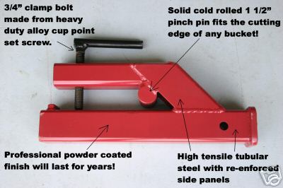

I'm thinking about moving a trailer around too. I also would like to move my chipper, it weighs about 1500lbs on the trailer. I'm thinking about one of these. Easy on. easy off and no drilling the bucket
I'm not sure what forum I read it in, but some one on here had a problem with that style. It had pivoted sideways while under load and almost caused him to lose the trailer down a hill. I think one fix was to weld "wings" to it to give it more surface mounting area.
I like it but agree with MReeb, drill a 3/4" hole and let the set screw go through the bucket, that'll keep it in place.

I have the bolt on receiver that asylum posted a pic of. $70 or so on ebay. Been happy with it for light trailer and splitter, but I'd definitely read curly dave's payne thread before using it on slopes. It definitely wants to "turn" and if I could weld I'd put wings on.
I also wouldn't be surprised that if I tried to pull a heavy trailer with it I'd just pull the receiver right off the bucket. That bolt only has so much grip
