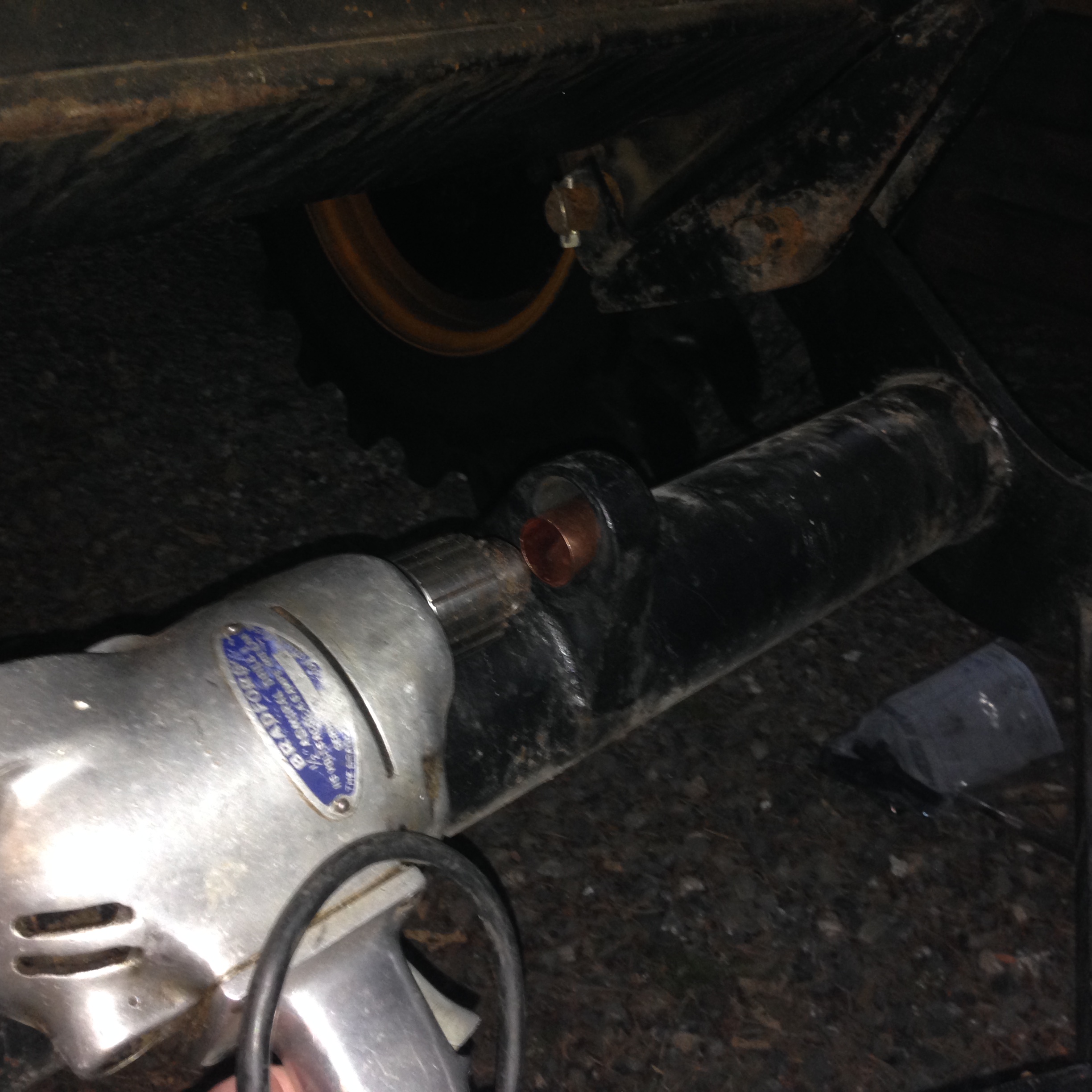

A lot of great ideas posted hear. Now I am not sure which direction to go.
Just to be clear I only have basic tools to work with and only a 260 amp 220v mig welder and a 140 amp 110v set up with flux core.

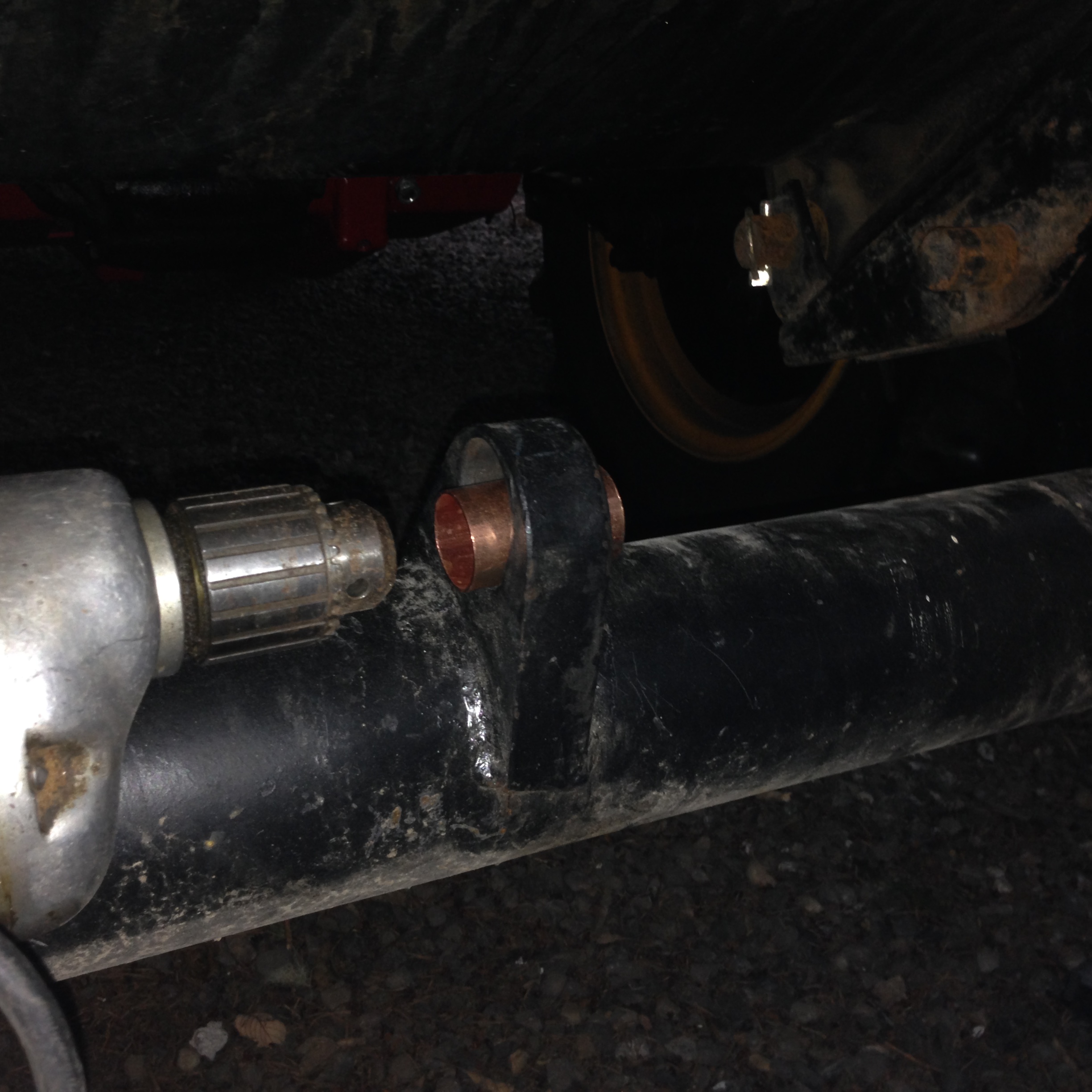

The first picture is showing how a 1" copper pipe fitting is the perfect size for blocking out the pin hole. You can easily see how much material has been lost. My guess is that it was due probably from an hydraulic cylinder that seeped onto the pin. The oily pin collected dirt which in turn acted like emery cloth on the tab.

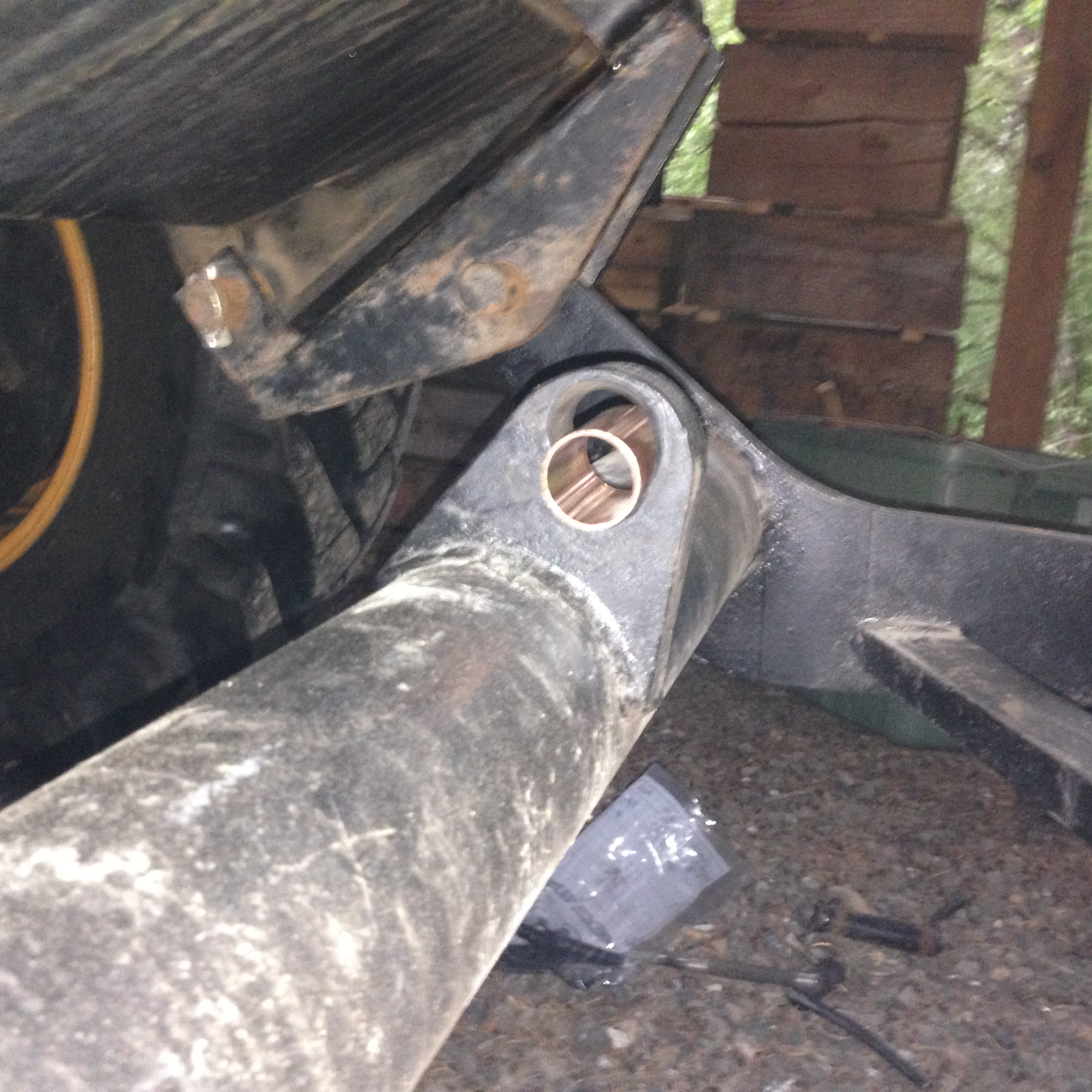

The other pictures are showing my 1/2" drill backed as far away as possible. It looks to me like there isn't enough room to chuck a hole saw.
Sorry for the dark images. A storm rolled in and it got dark real quick.
Thanks again for all the suggestions.

The 220vMIG for sure. I wouldn't want to be chipping slag out of that hole you'd end up with a bunch of buried slag. Of course it's been done and probably done well long before MIGs existed but I wouldn't put slag in there with a MIG hanging around. Thats IMHO,,, but as our local expert states, I don't have a clue! :cool:
I doubt if that thin copper pipe has the "capacity" to take all that heat out while you're jamming wire in there. I'd think it would melt. Then you'd have to weld so slowly and incrementally that you'd just be piling a bunch of cold starts into the hole, and not get the strength you want. Can you create a test weld situation on some significantly thick scrap, see if you can pile weld on that's supported by the copper pipe? This is something I've never done, but I'm interested! LD1 says he's done it, maybe he can give tips on this part.
Clearly the little metal that's remaining is strong enough for what you are doing, so you "could" simply add more metal to start wearing it away again (not worrying about restoring original strength). But what does this component "DO"? Is there a different usage someday, that will require the full strength of that lug? If yes, then you kinda don't want the crappy weld thats inevitable trying to jam wire into that thin slot (where the copper pipe is real close to the steel).

I'd use your original idea and cut most of the tab off and weld on a new piece with a hole in it. Cutting torch, welder, drill press and drill bits. I have those.
   / Hitch pin hole repair #37
The copper pipe methind I have done In The past had always worked well. But never done anything that thick either.
If you are worried about heat and deforming the copper, fit a solid round bar inside it.
But given what you have to workwith, cutting the eye off and welding on a new one with a pre-drilled hole may be the better way.
