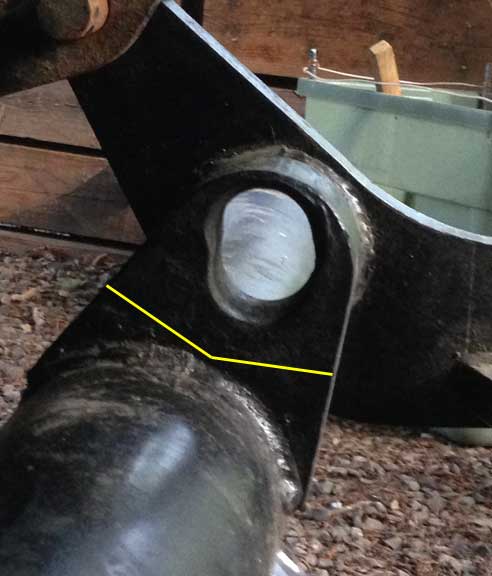

This project needs a pic with an "item of scale" nearby. Perhaps a pic with a drillmotor set in position?
Drill press is out of the question. There is almost no drill press in the world that can accommodate that large weldment. If a guy had this drill press in his farm shop he wouldn't be asking the forum.:cool:
Holesaw method with a pilot guide tacked on the far side is feasible if a drill motor can fit next to the pipe and still center on the hole. This would be a large holesaw (size of the outer diameter of the bushing). That would be some work too, but a clean repair. Then jam the remaining with a MIG.
465173d1460982482-hitch-pin-hole-repair-img_0172-jpg

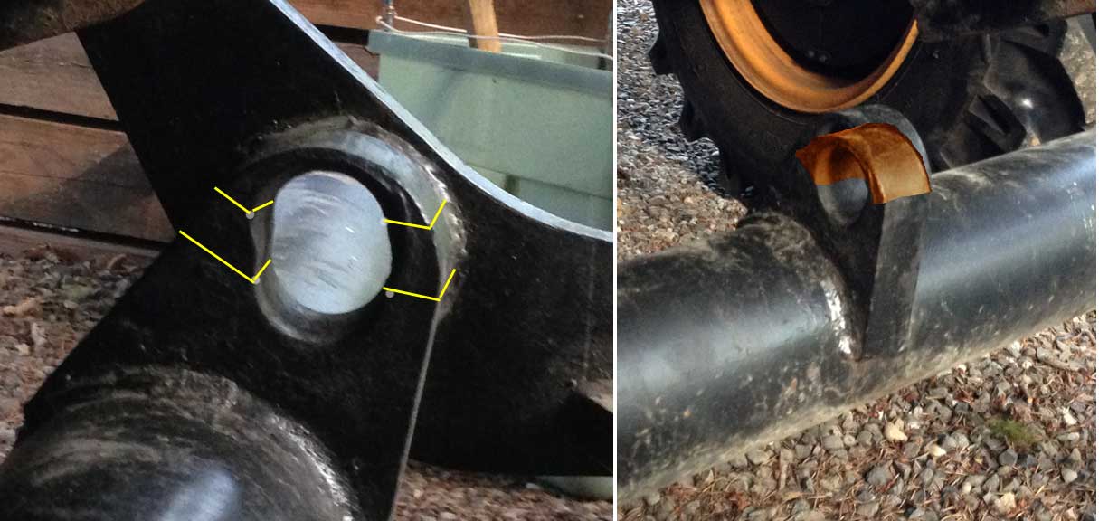

Here's what I would do. Cut out the (straight) elongation with an angle grinder. I've shown stright cuts for illustration purposes. Realistically they would be angled cuts ending at the same points inside the hole, so you have a "vee" to fill. Then you grind the cap to fit until you have restored the hole "roundness" to your liking.
465480d1461169902-hitch-pin-hole-repair-elongated-hole-jpg
After welding the 'cap' back on, you probably should restore the cap to it's original thickness and edge margin, ready for the coming years of wear and tear. I think I'd weld on logs of 1/4" round rod to save time and wire. ER70 wire itself will be harder and tougher than the parent material was, you can probably expect the repair to last a little longer than the original

I would take some cardboard, and copy the original pad eye. Use a torch to cut a new one out of the same thickness metal. Use an annular cutter to drill the hole. Carbon arc the old pad eye off, and grind clean. Then weld the new one on.;)
   / Hitch pin hole repair #19
That's a good way too, straightforward, doable. And when done it can be ground down, flapper-disced and no evidence it was ever repaired. Not for me though, I'd already be done with the method above, without even having to get in my truck. All ground down, flapper-disced and no evidence it was repaired:thumbsup:
If you can get ahold of 1" thick scrap - the holesaw is not expensive. A holesaw will have trouble turning, and remember it has to bring chips up more than 1/2" so you will want to cut from both sides. I'm not so sure a holesaw plunging that deep will be much fun, but it's more feasible to holesaw the eye when it's in a vise. Big holes like that aren't easy, maybe go to a shop and have the hole drilled, and fit the rest yourself.
An angle grinder would cut the whole eye off in 15 minutes, finished in less time than it takes to even find someone who can recall someone who heard someone else talk about a carbon arc once.:laughing:
I'd stay 3/8 - 1/2 below the hole because you want to be able to vee it out and fill with weld. If that thing can survive elongated like that the forces are not so high, it's mostly wear. Might need the 7" size cutoff disc to get that deep.
Would be nice to find a scrap with the hole already there and just cut out the pad shape you need.

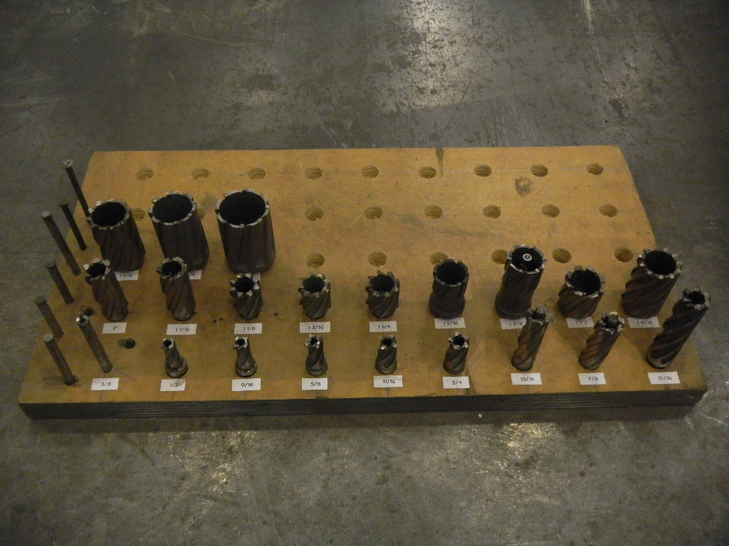

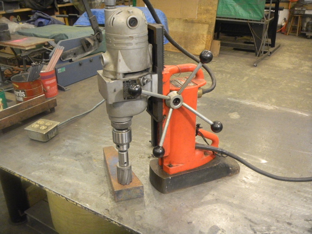

These are the kind of hole saws I like to use. :thumbsup:
