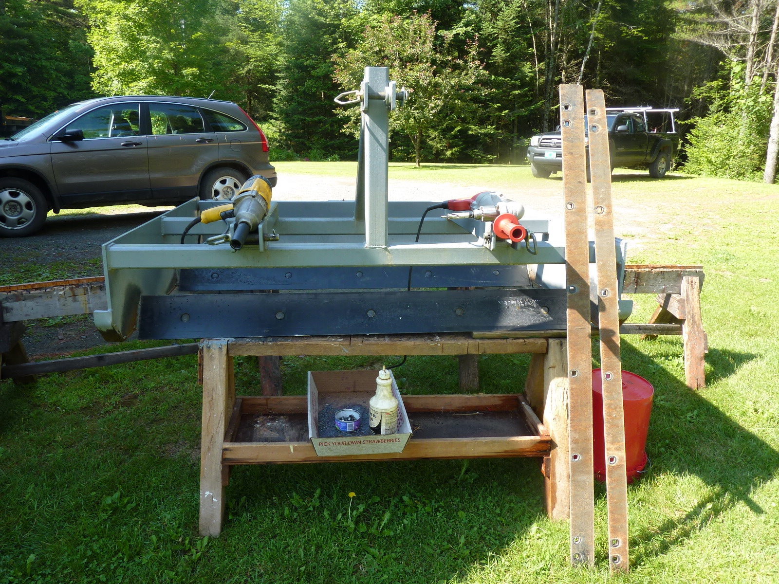

If you could borrow or rent a Milwaukee right angle drill you could use the hole saw method. Most any plumber, electrician, or carpenter would have one. Speed is slow and variable. At least that was true in the old days. Top right in the picture.
gg
How many miles you gotta drag that plane to wear out cutting edges like that???? :D
